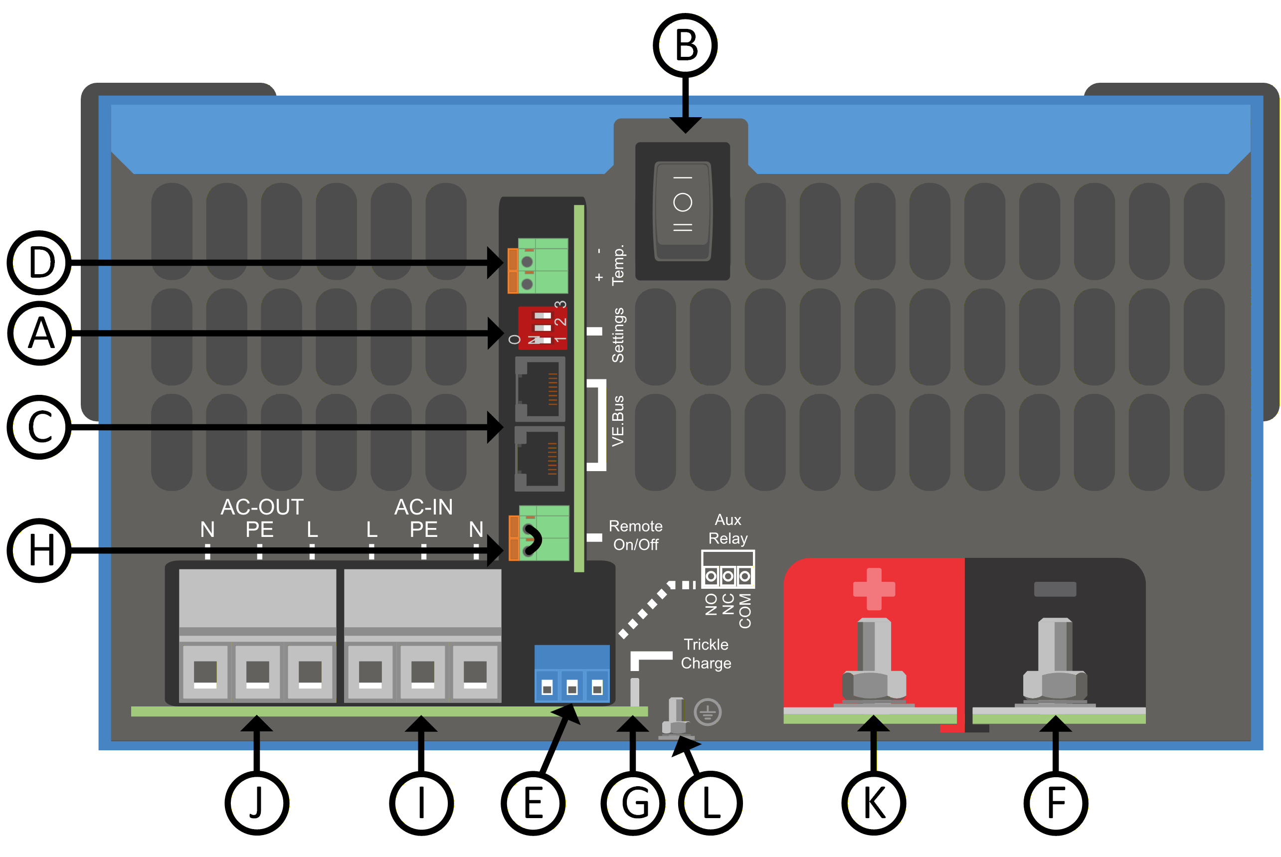

9.1. Appendix A: overview connections
Letter | Description |
A | DIP switch (remove cover) |
B | On/off/charger only switch |
C | VE.BUS Communications port |
D | Temperature sensor |
E | Alarm contact |
F | Battery negative |
G | Starter battery plus |
H | Remote control |
I | AC input |
J | AC output |
K | Battery positive |
L | Earth connection |

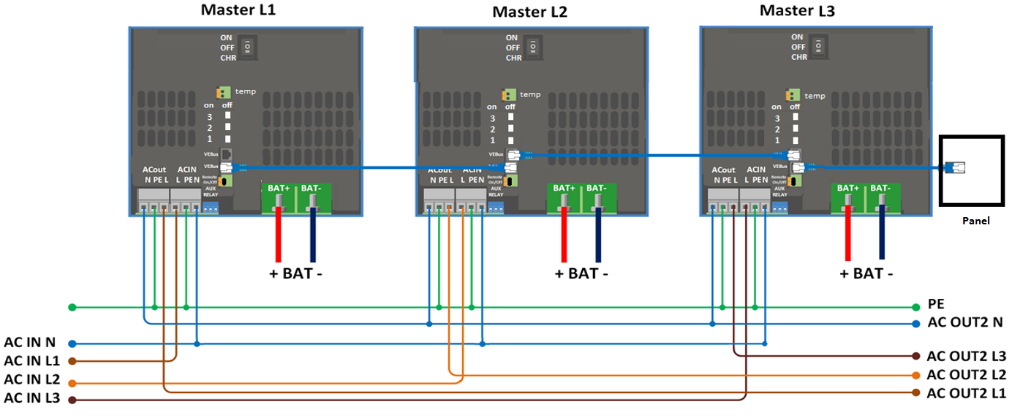

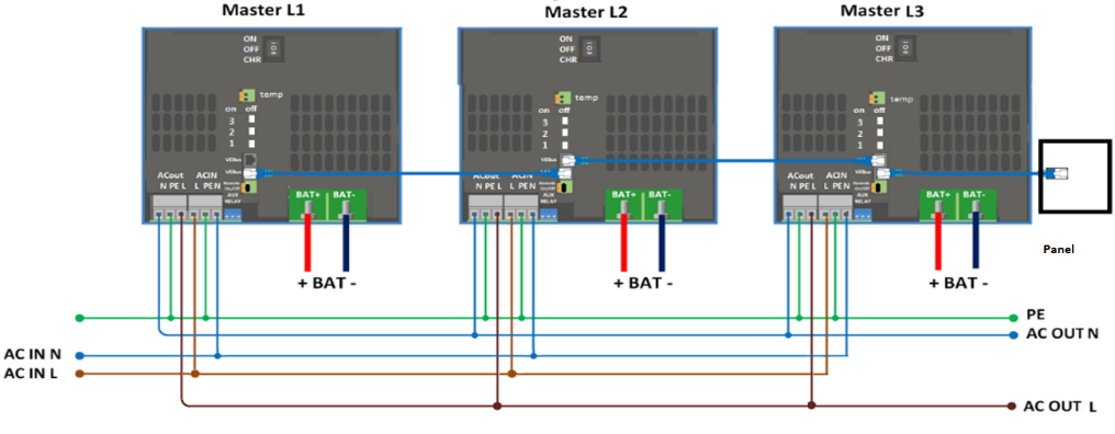

9.3. Appendix C: parallel connection
9.4. Appendix D: three-phase connection

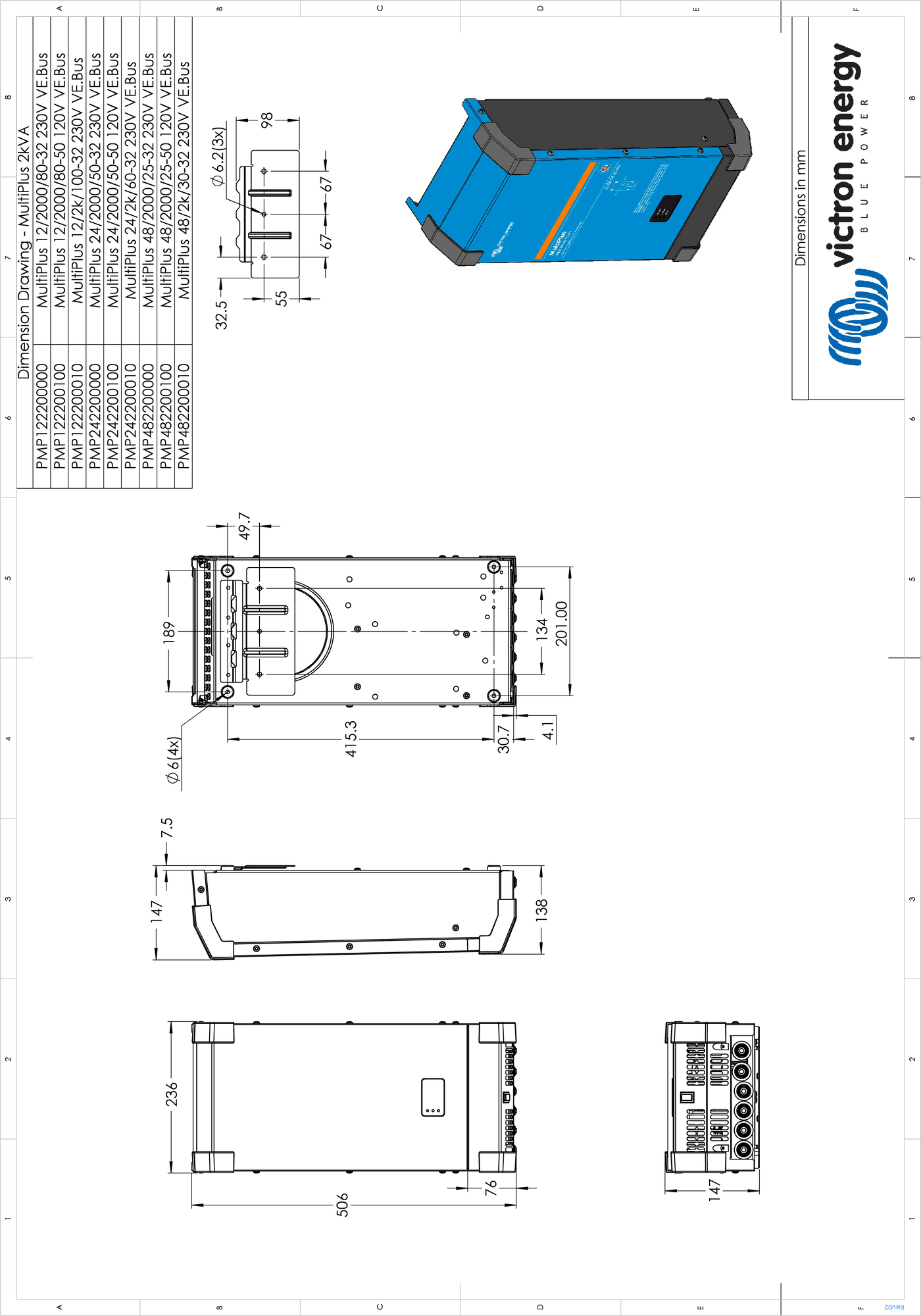

9.7. Appendix G: dimensions
