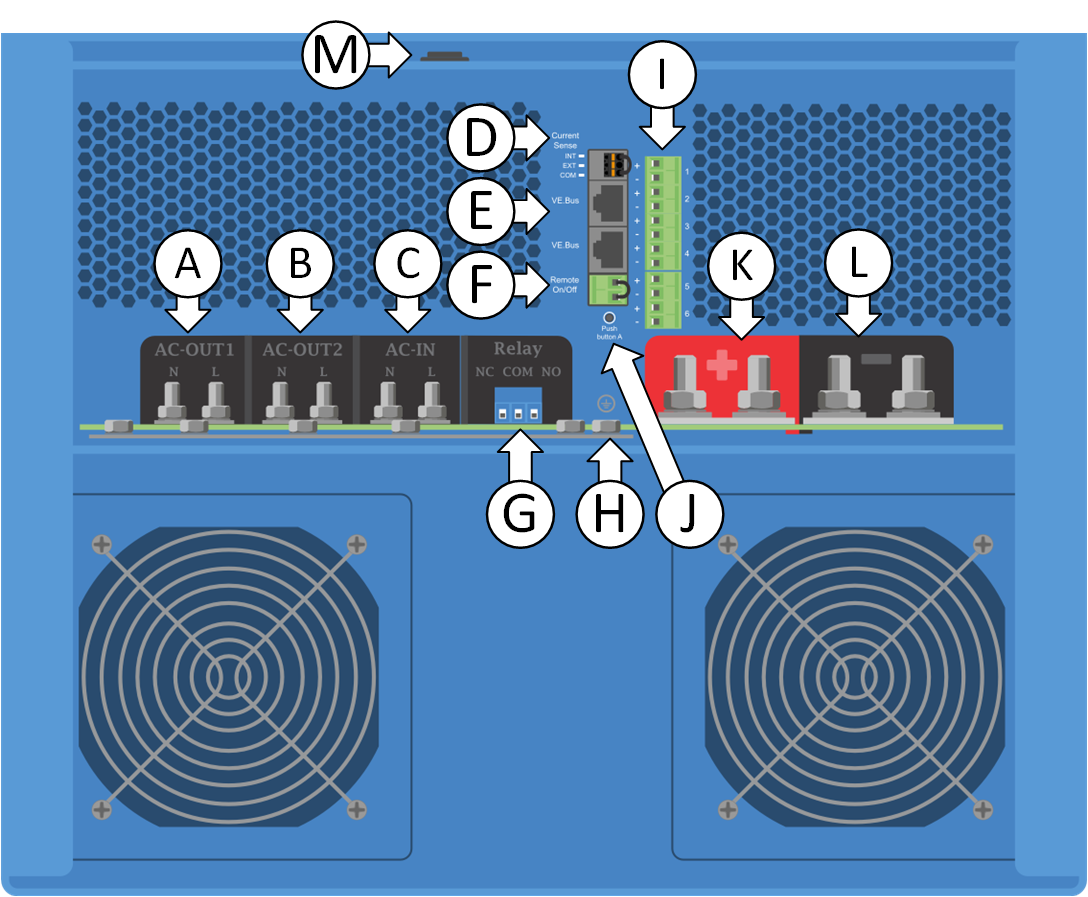

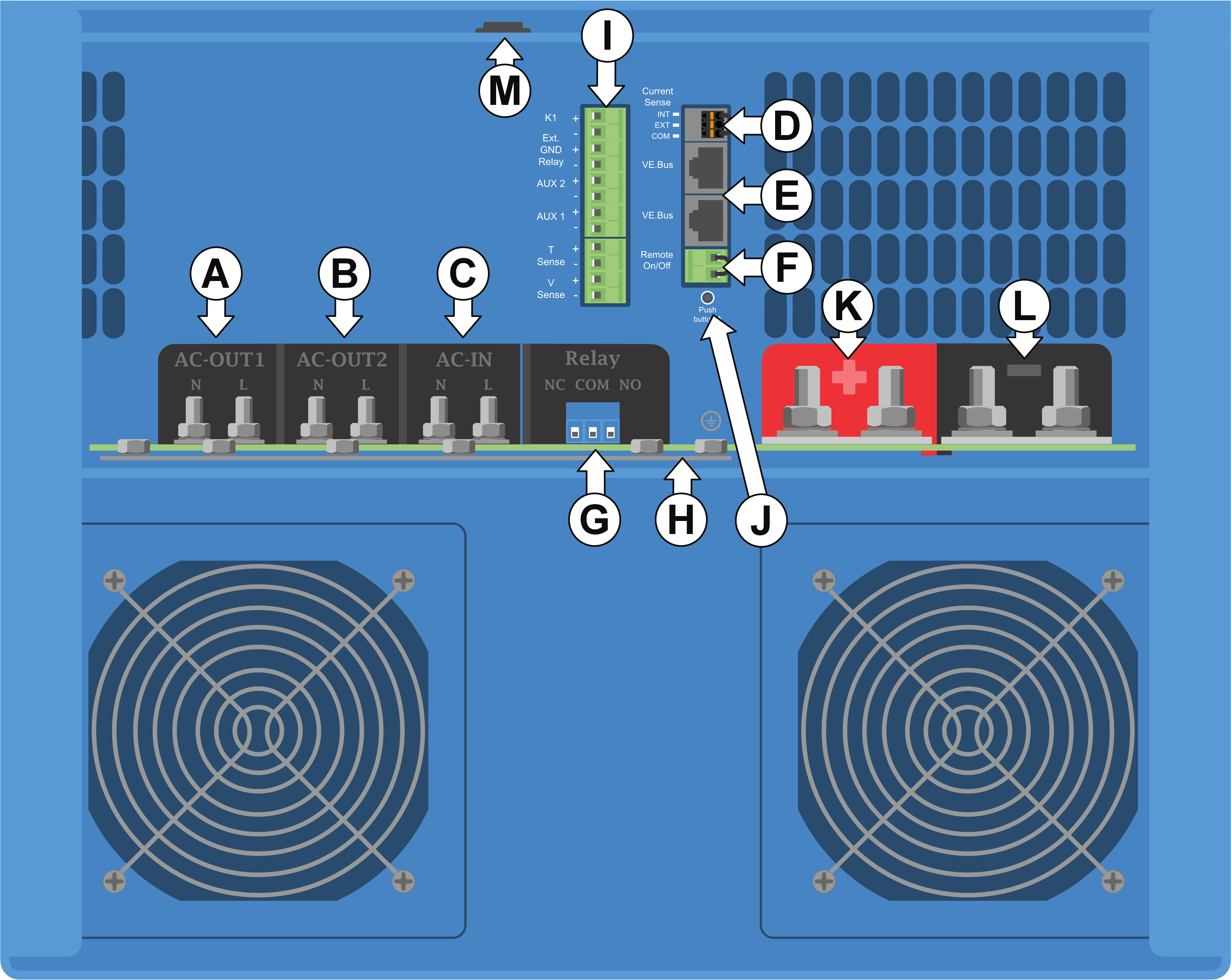

8.1. A: Connection overview
A | Load connection. AC out 1. Left to right: N (neutral) and L (phase). | |
B | Load connection. AC out 2. Left to right: N (neutral) and L (phase). | |
C | AC input: Left to right: N (neutral) and L (phase). | |
D | External current sensor. To connect the current sensor, remove the wire bridge between the INT and COM terminals, connect the red sensor wire to the EXT terminal and connect the white sensor wire to the COM terminal. | |
E | 2x RJ45 VE-BUS connector for remote control and/or parallel / three-phase operation. | |
F | Connector for remote on/off switch: Short to switch “on”. | |
G | Alarm contact: (left to right) NO, NC, COM. | |
H | Earth/ground busbar for both AC input PE, AC output PE and chassis earth/ground M6 connections. | |
I | Terminal for: top to bottom:
J | Push button A – To perform a startup without assistants. | |
K | M8 battery positive connection. | |
L | M8 battery minus connection. | |
M | Main switch: 1=On, 0=Off, ||=charger only | |

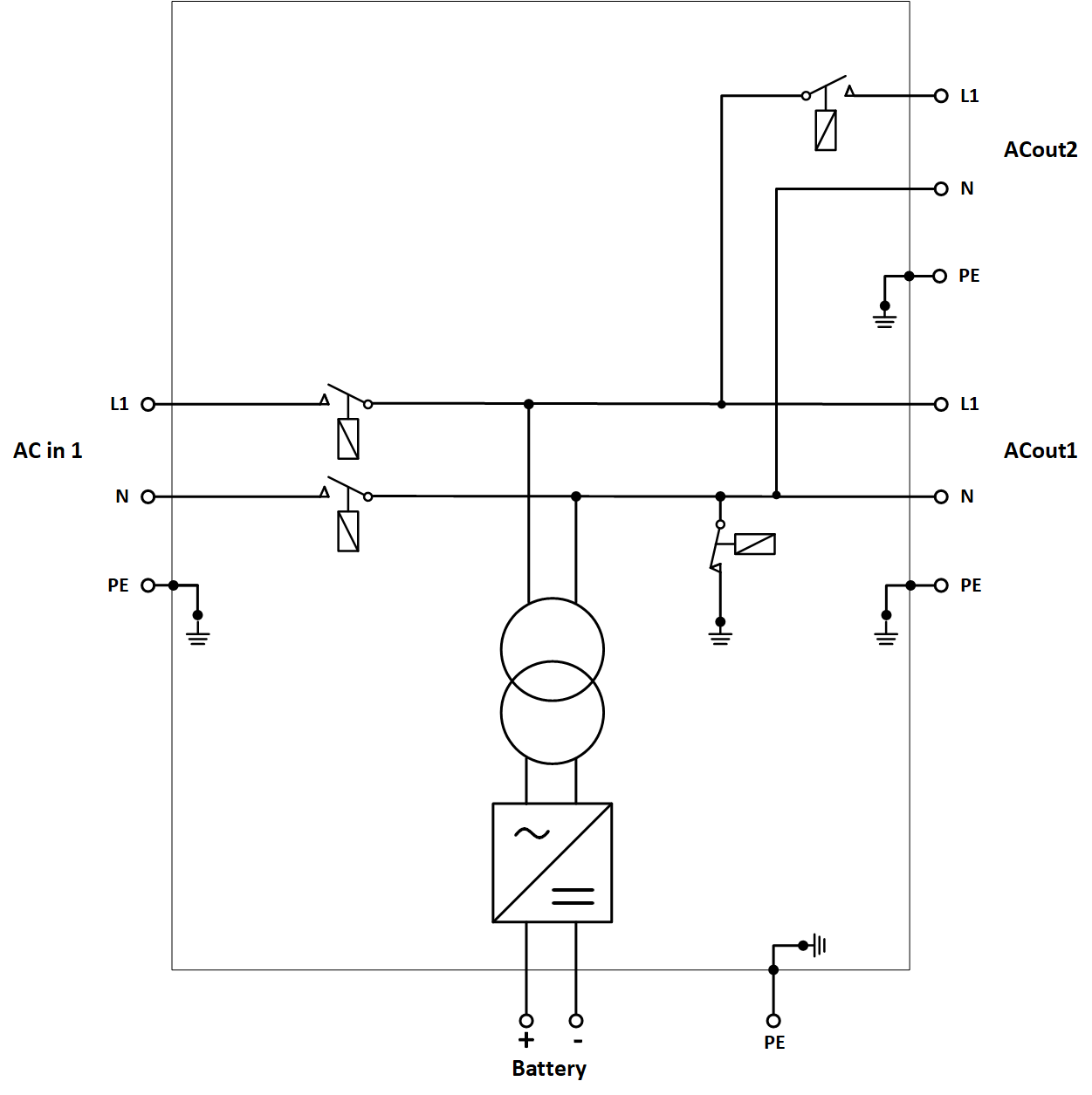

8.2. B: Block diagram
* See table in Chapter 4.2 ‘Recommended DC fuse’

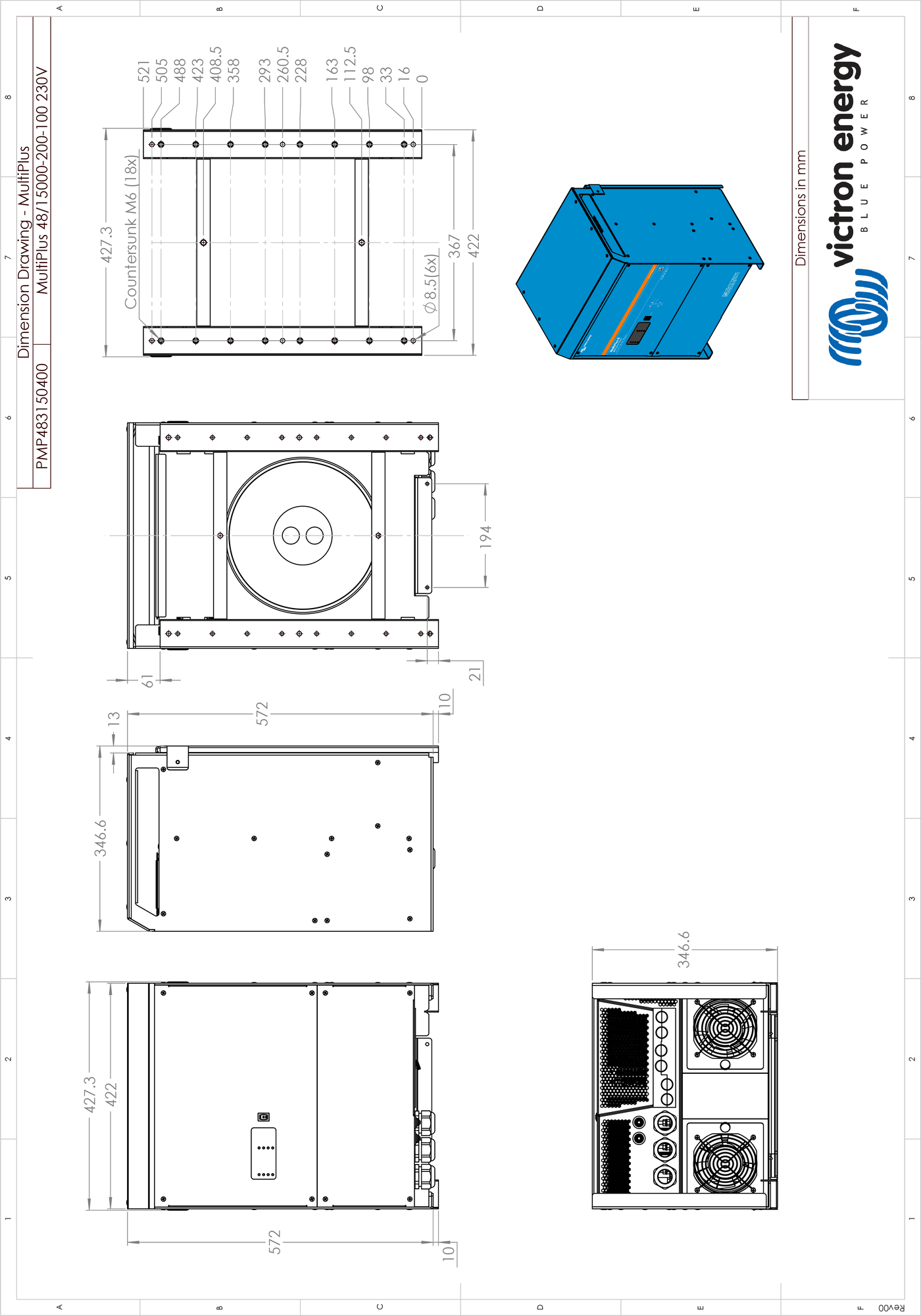

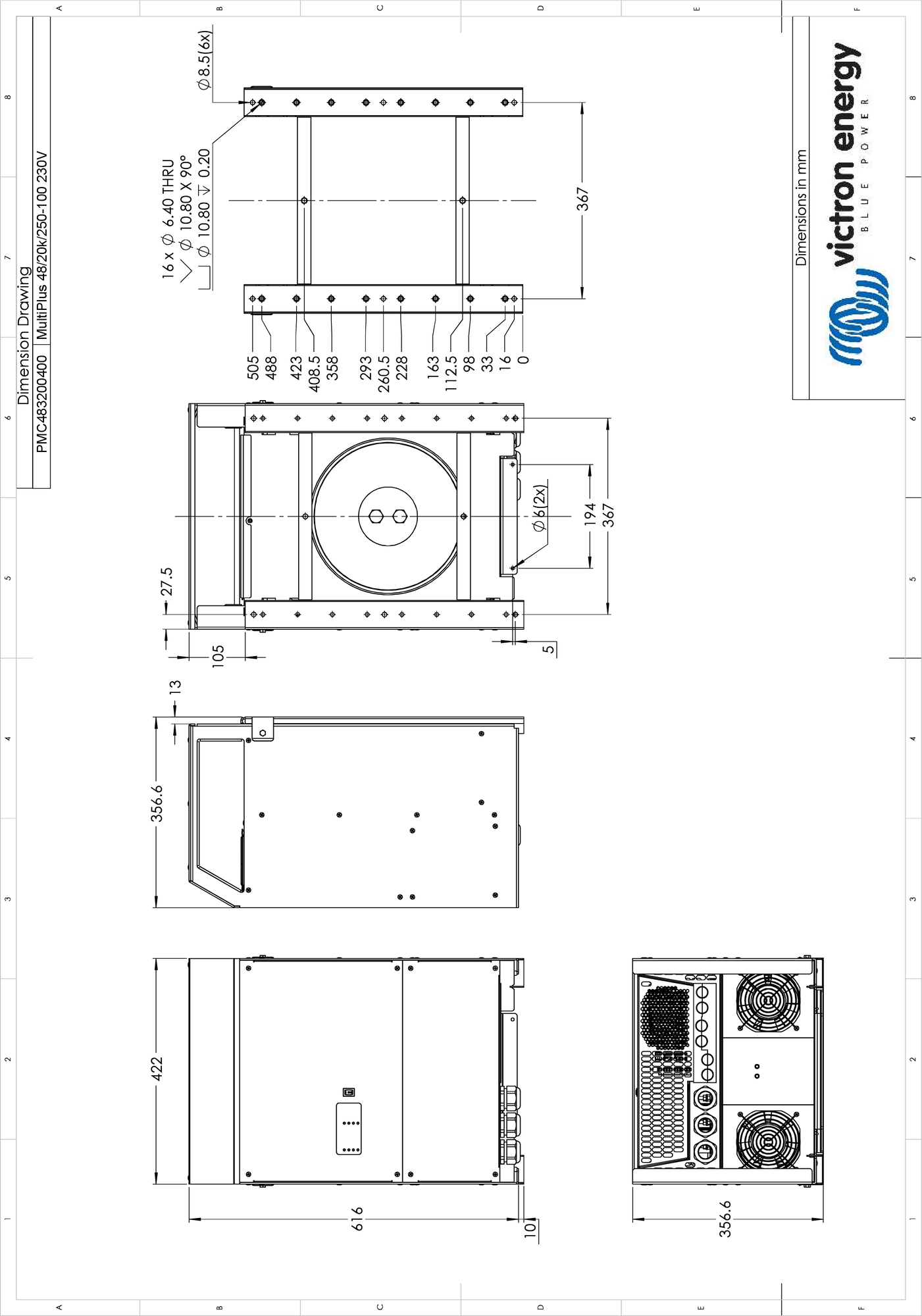

8.5. G: Enclosure dimensions
