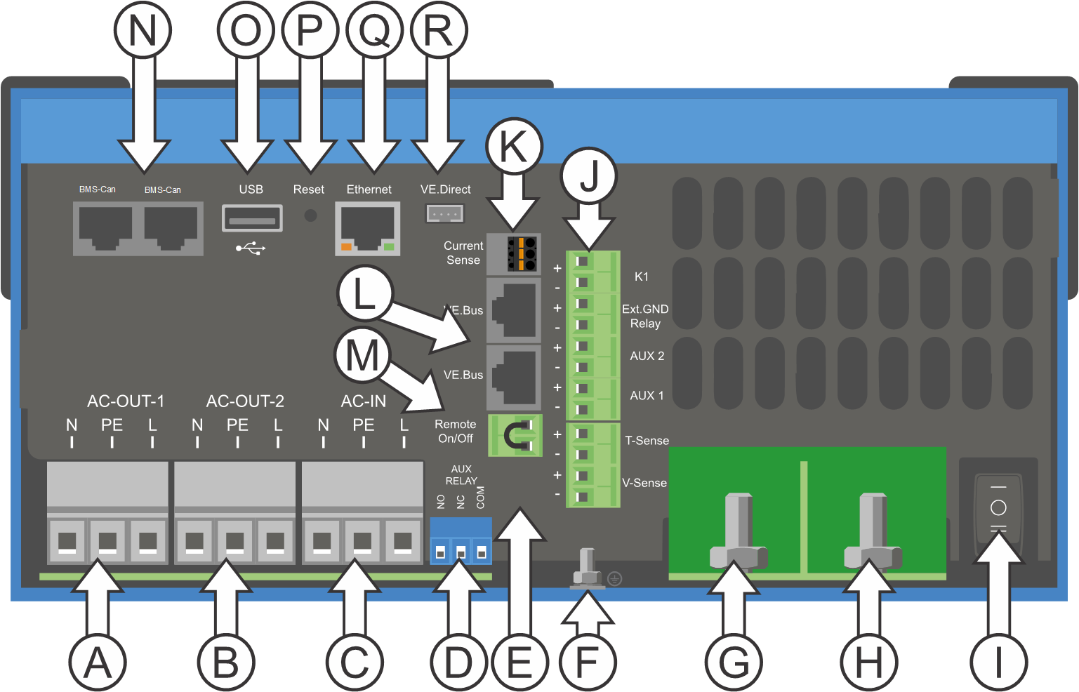

14.1. Connection Overview
Reference | Description | Connection |
A | Load connection. AC-OUT-1 Left to right: | N (neutral), PE (earth/ground), L (phase) |
B | Load connection. AC-OUT-2 Left to right: | N (neutral), PE (earth/ground), L (phase) |
C | AC input. AC-IN Left to right: | N (neutral), PE (earth/ground), L (phase) |
D | Programmable (AUX) relay; left to right | NO, NC, COM. |
E | To start without Assistants | Press and hold this button when starting |
F | Primary ground connection | M6 (PE) |
G | Battery positive connection. | M8 |
H | Battery minus connection. | M8 |
I | Switch | -:On, 0:Off, =:charger only |
J | Terminals top to bottom: | 1. Auxiliary power supply 12 V 100 mA |
2. Programmable open collector ooutput (K1) 70V 100mA | ||
3. External ground relay + | ||
4. External ground relay – | ||
5. Analog/digital (AUX) input 1 + | ||
6. Analog/digital (AUX) input 1 – | ||
7. Analog/digital (AUX) input 2 + | ||
8. Analog/digital (AUX) input 2 – | ||
9. Temperature sense + | ||
10 .Temperature sense – | ||
11. Battery voltage sense + | ||
12. Battery voltage sense - | ||
K | External current sensor | To connect the current sensor, remove the wire bridge between the INT and COM terminals, connect the red sensor wire to the EXT terminal and connect the white sensor wire to the COM terminal. |
L | 2x RJ45 VE-BUS connector | for remote control and/or parallel / three-phase operation |
M | Connector for remote switch | Short connection to switch “on”. |
N | Dedicated BMS-Can port (VE.Can not supported) | |
O | USB port | |
P | Reset Button | Reboots the GX card component only |
Q | Ethernet Port | |
R | VE.Direct Port |

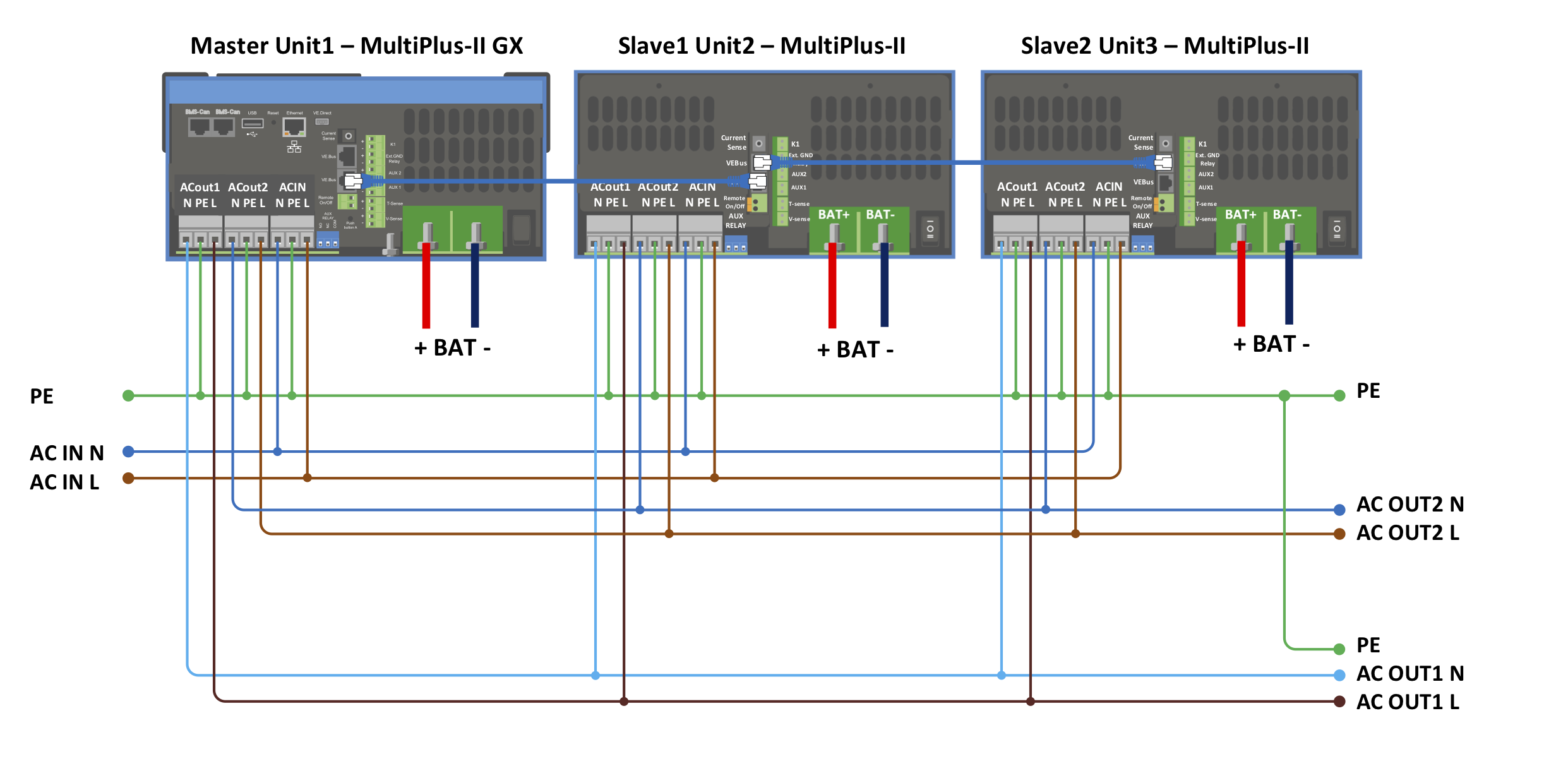

14.3. C: Parallel connection diagram
Additional conditions are required for parallel systems - please read further specific documentation here - https://www.victronenergy.com/live/ve.bus:manual_parallel_and_three_phase_systems

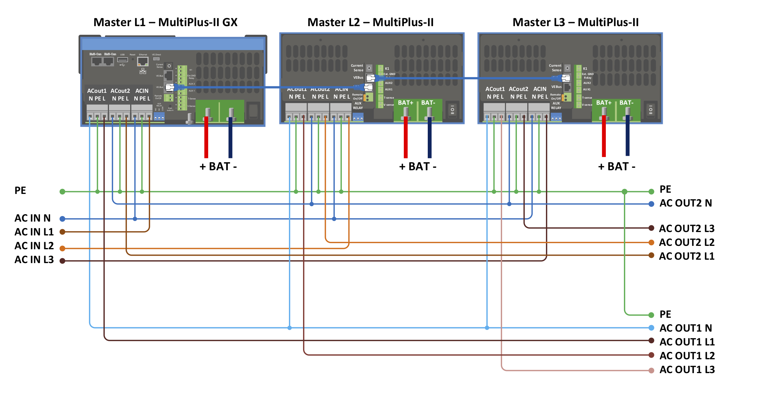

14.4. D: Three-phase connection diagram
Additional conditions are required for three phase systems - please read further specific documentation here - https://www.victronenergy.com/live/ve.bus:manual_parallel_and_three_phase_systems

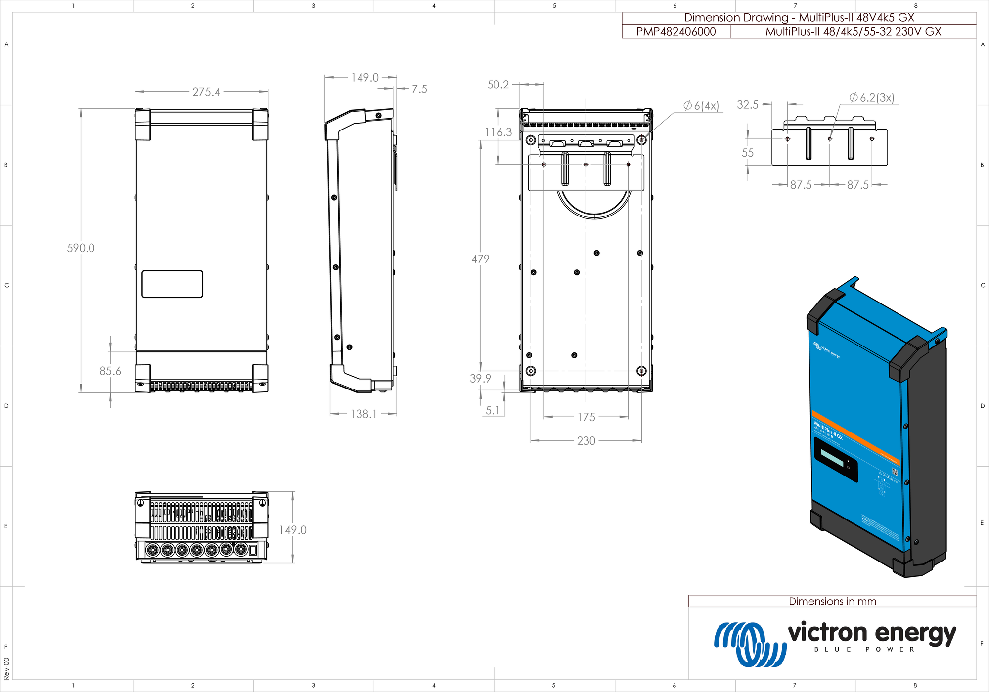

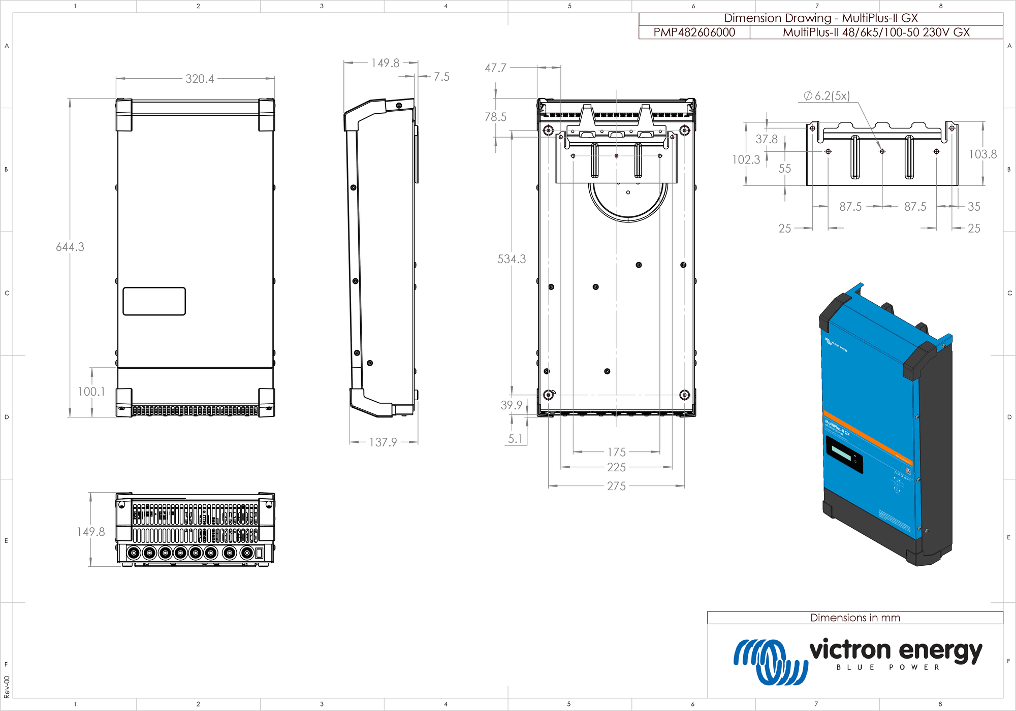

14.7. G: Enclosure dimensions
