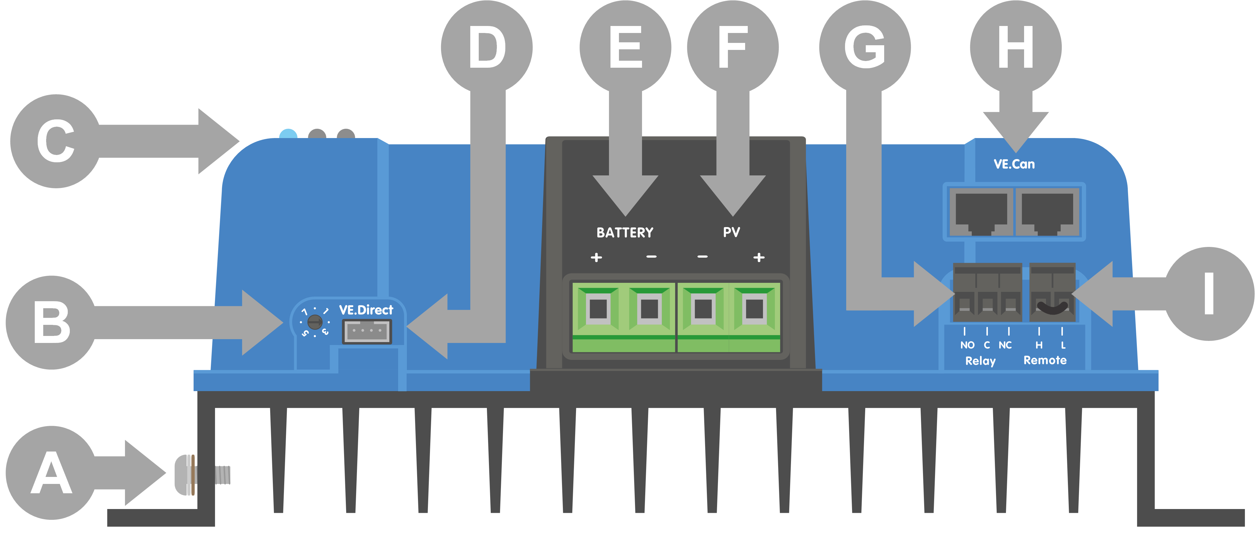

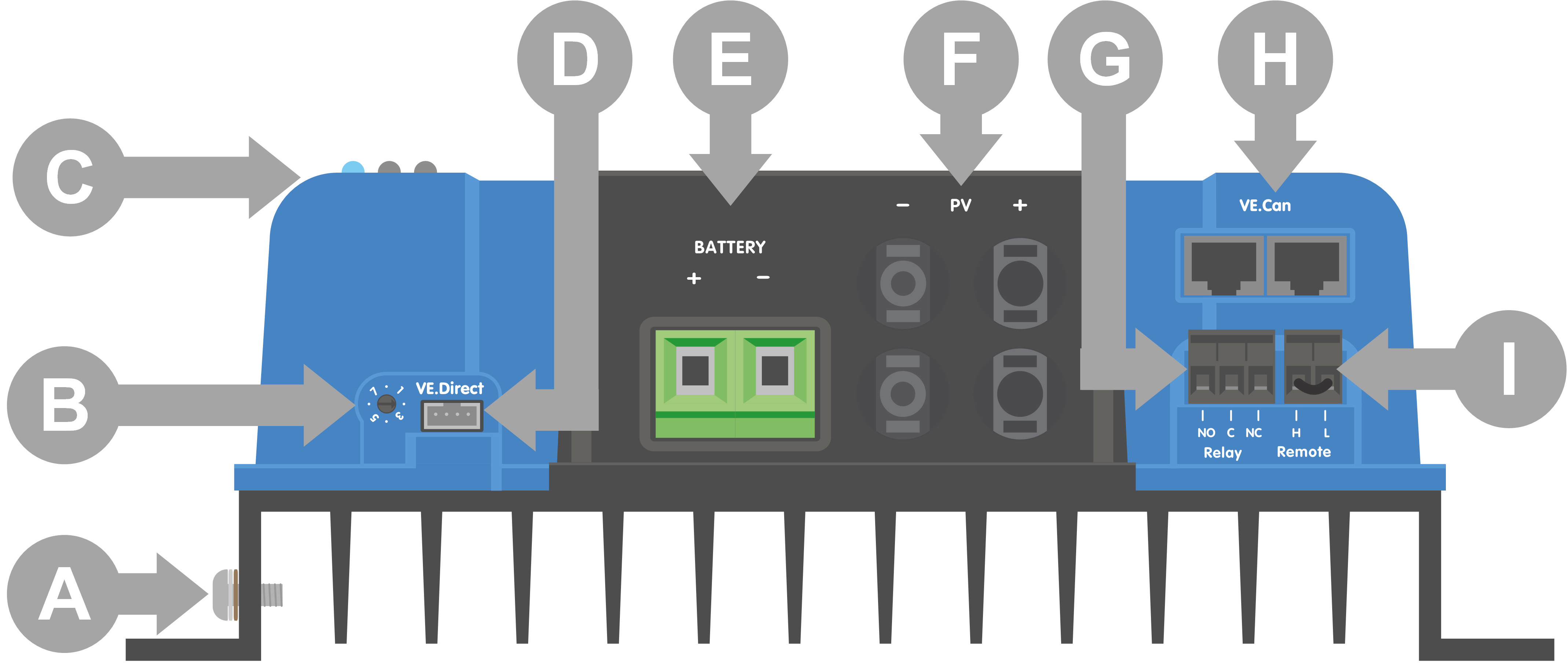

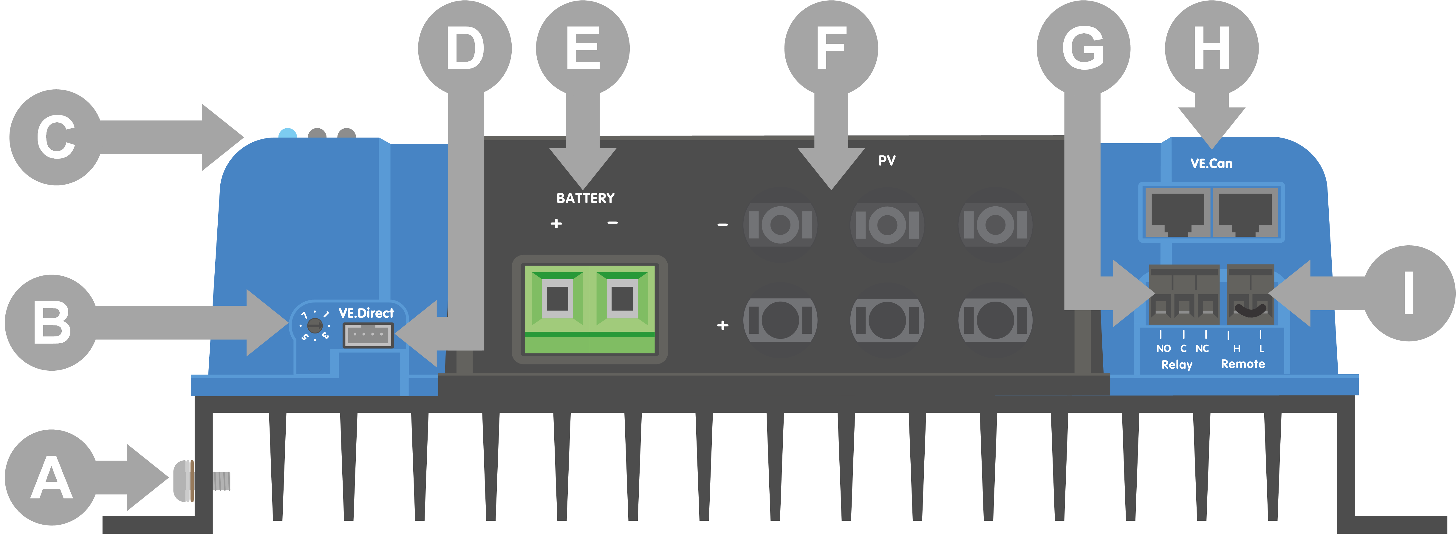

4.5. Connection overview
TR model.
70A MC4 model.
85A or 100A model.
ID
Description
A
Ground screw connection.
B
Rotary switch.
C
LEDs.
D
VE.Direct socket.
E
Battery screw terminals.
F
PV screw terminals.
G
Relay screw terminals.
H
VE.Can sockets.
I
Remote on/off terminals.
