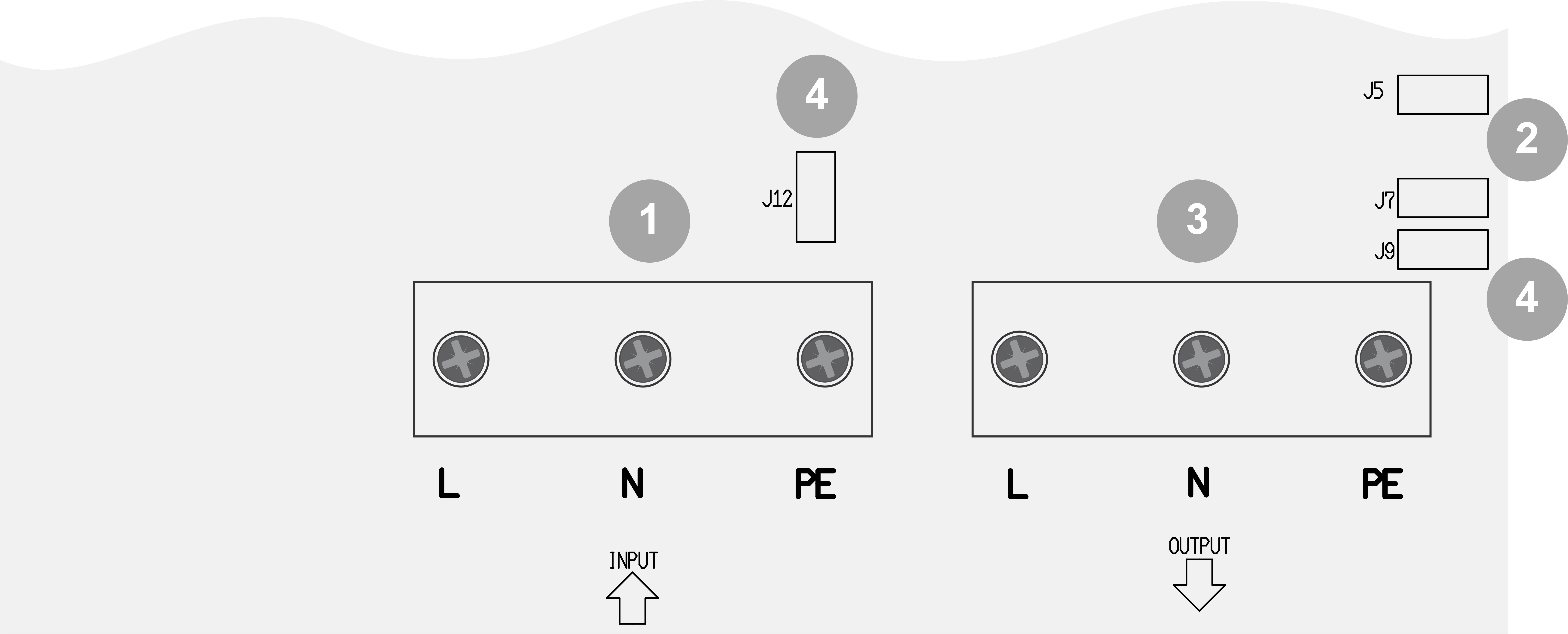

3.2. Connections overview
ID
Description
1
AC input screw terminals (shore power):
Phase (L) neutral (N) and earth (PE).
2
Male spade terminals to establish an AC output neutral to earth connection link for the correct operation of an AC output GFCI:
Connect J5 to J7.
3
AC output screw terminals for the AC loads or AC installation on the vessel:
4
Male spade terminals to bridge AC input earth to AC output earth when the vessel is out of the water:
Connect J9 to J12.
Note
The Earth link wires used in points 2 and 4 are included with the transformer. They have a core surface area of 6mm² (10AWG) and are connected to a 6.3mm spade terminal. Depending on local electrical regulations, this cable surface area might not be large enough to carry the potential fault currents of the AC system where the isolation transformer is used. If wires with a larger core surface area are required, then do not use the jumper connections but make the connections between the AC input and/or AC output terminal instead. Alternatively, make these connections external from the isolation transformer.

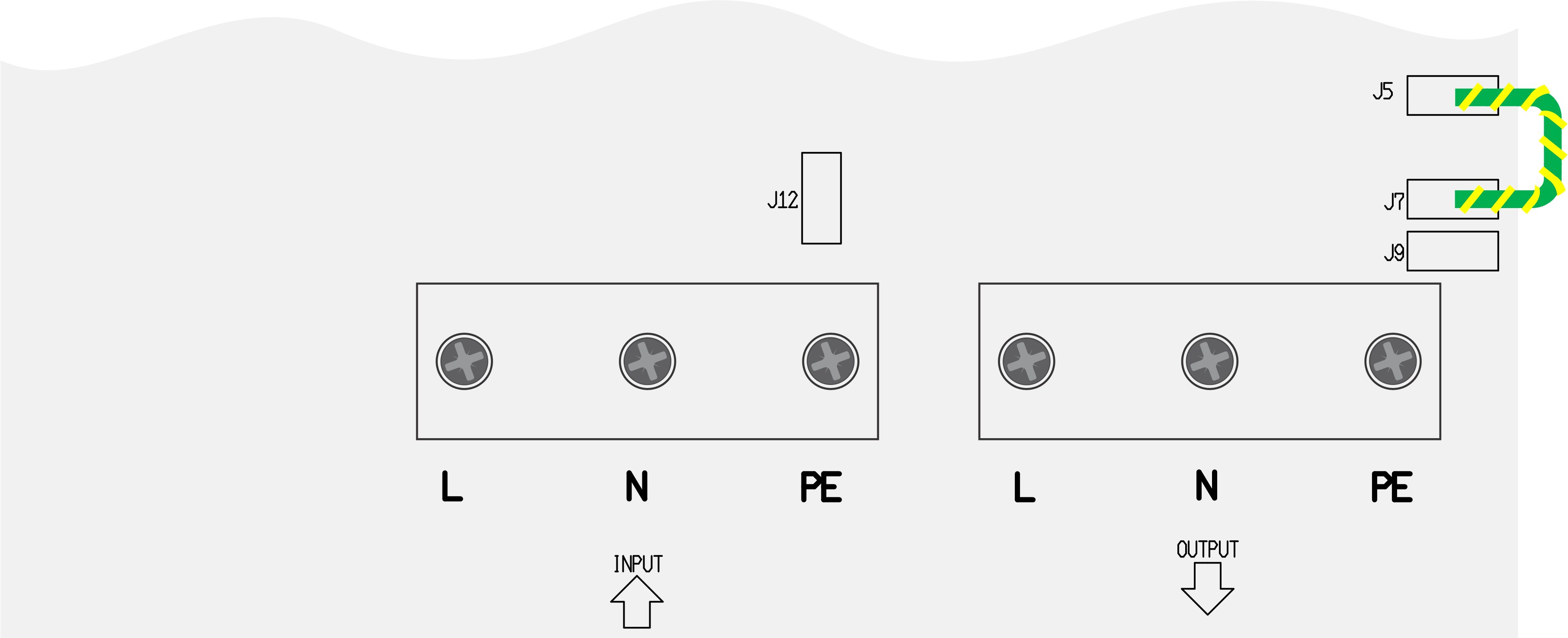

3.4. AC output neutral to earth link
A GFCI must be installed in the AC output of the isolation transformer. For the GFCI to operate correctly, the AC output neutral must be connected to the AC output earth and ground (= all the metal parts in the vessel).
To link the AC output neutral (N) to earth (PE), place a green/yellow jumper wire (included) between male spade connectors J5 and J7.
AC output neutral (N) to earth (PE) link.

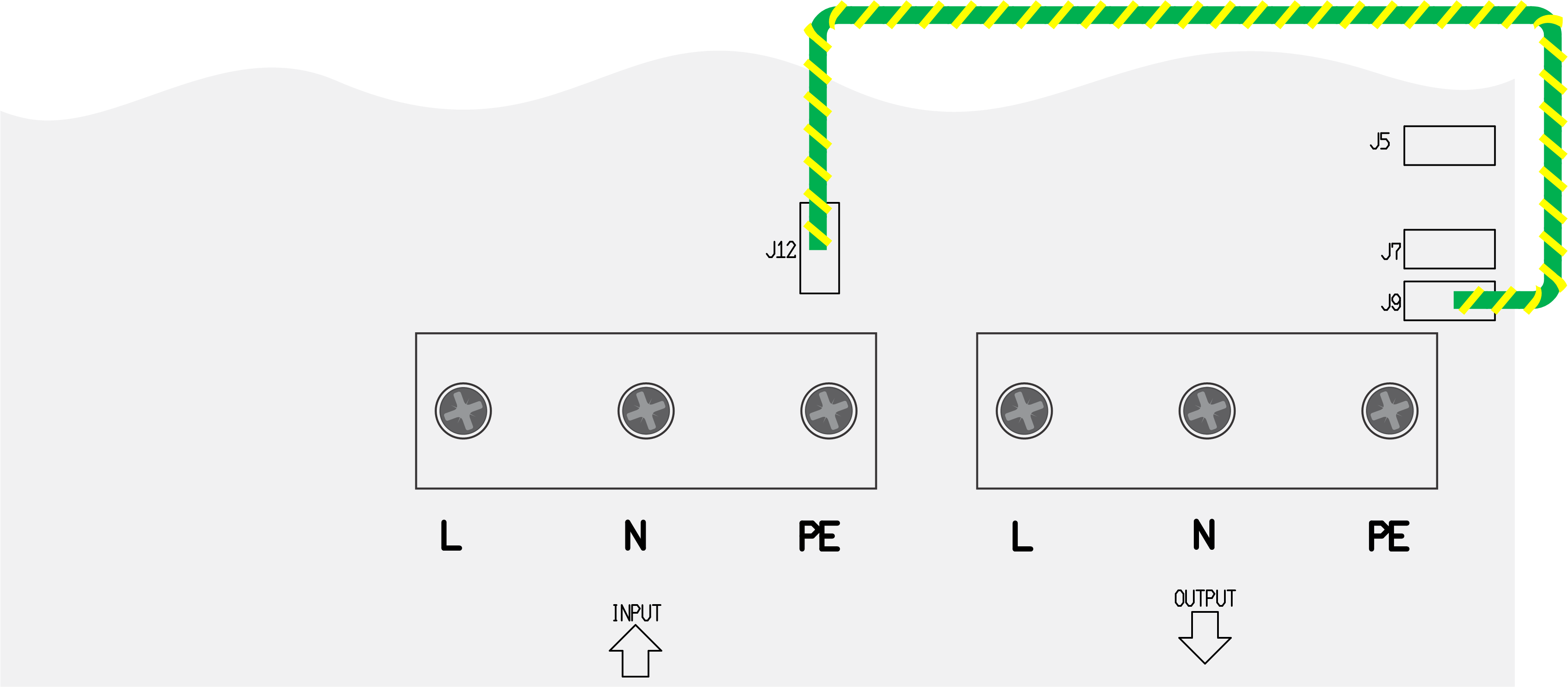

3.7. Linking input and output earth when the vessel is out of the water.
For safety reasons, when the vessel is out of the water (on land) during winter or for maintenance, the vessel earth (PE) conductor must be connected directly to the shore power earth (PE) conductor.
This can be achieved inside the isolation transformer by connecting the yellow/green jumper wire (included) between the male spade connectors J12 and J9, as indicated below.
AC input earth is connected to AC output earth when the vessel is out of the water (on land) during winter or for maintenance.
