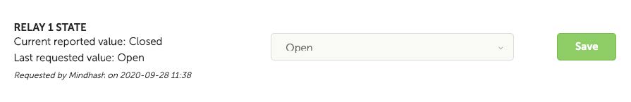

You can queue changes to the relay state in VRM. Changes will be propagated the next time the device connects and transmits its data, and can thus take up to 15 minutes to take effect (or longer if the device has no connection).
![GL_Relay_1_state.jpg](image/165aa30a08ad69.jpg)
