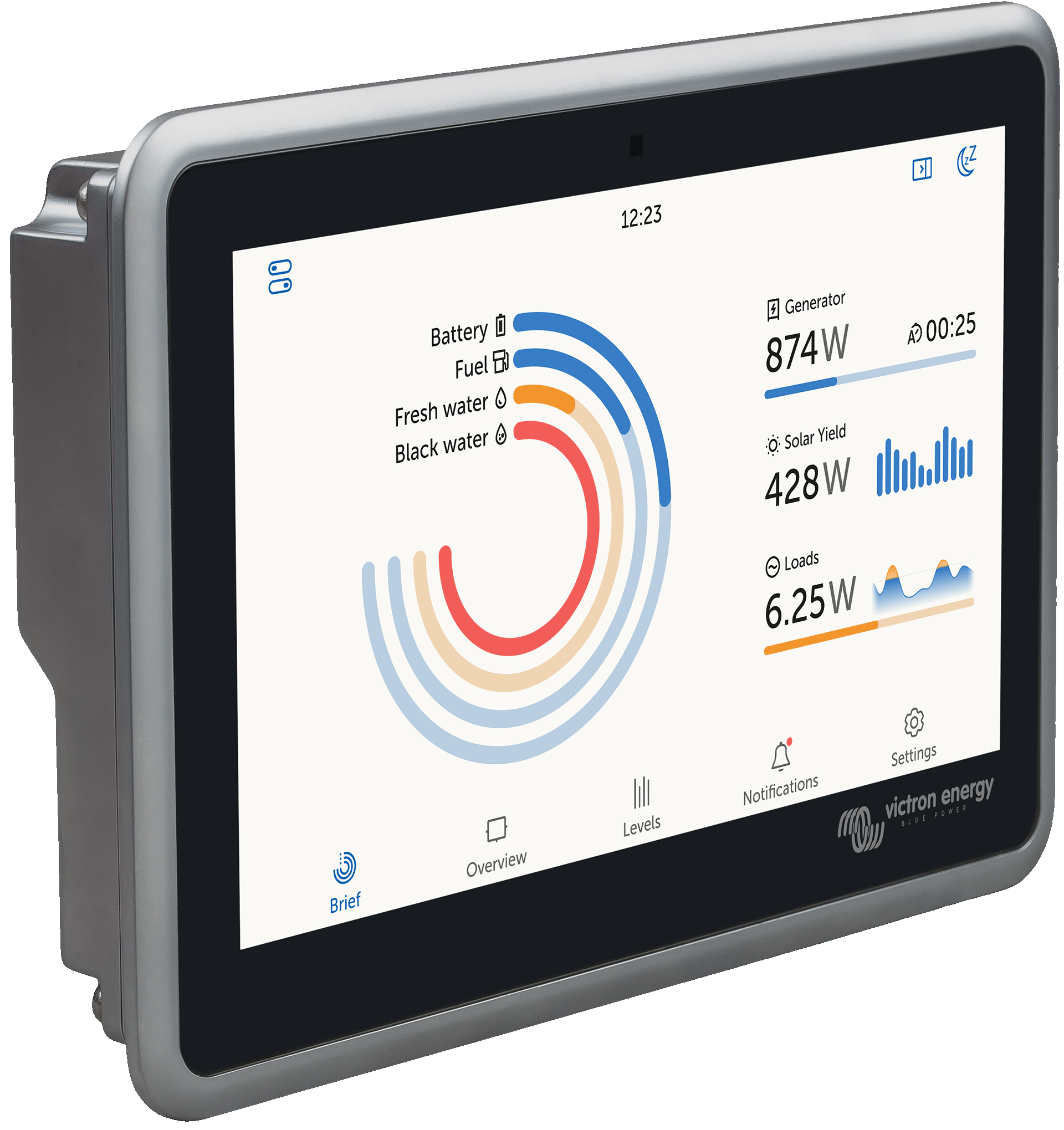

Ekrano GX | ![]() |

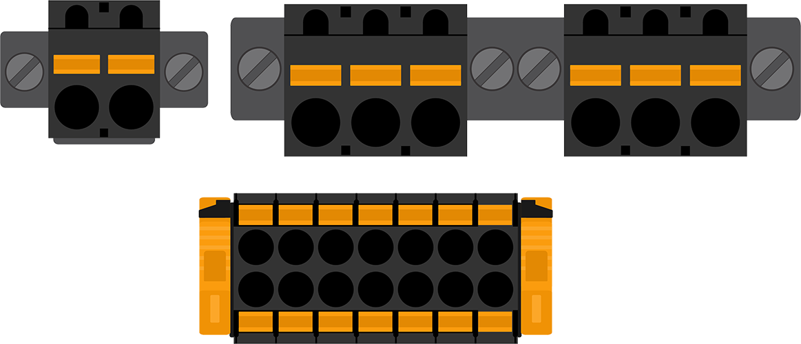

Terminal blocks with mounting screws for: Relays (2 pcs), Power Connector IO terminal block with quick release clamps | ![]() |

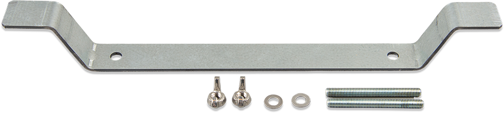

Steel bracket for panel mount incl. rods, wingnuts and washers | ![]() |

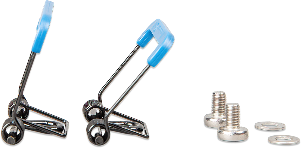

Springs for panel blind hole mount incl. screws and washers | ![]() |
