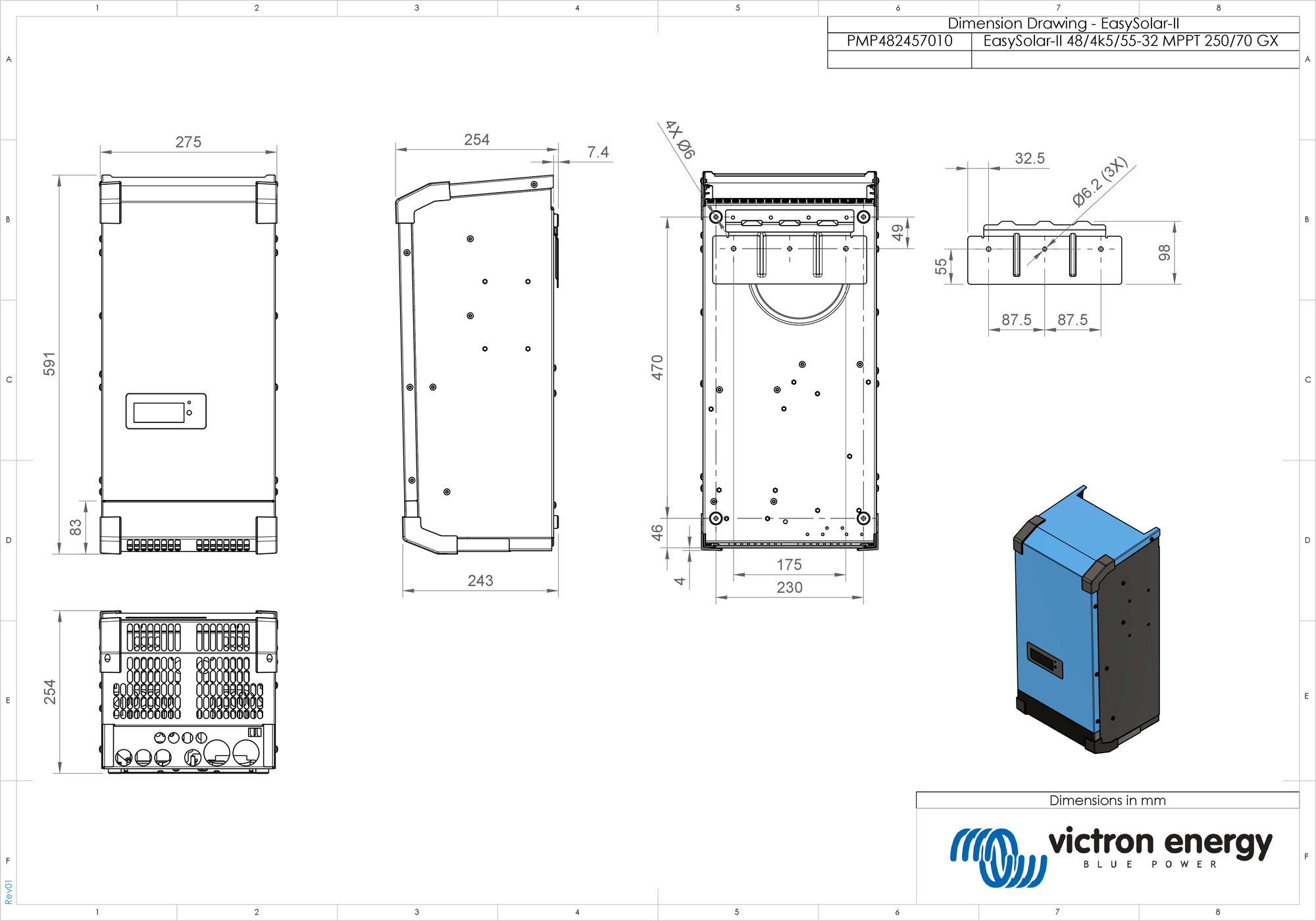

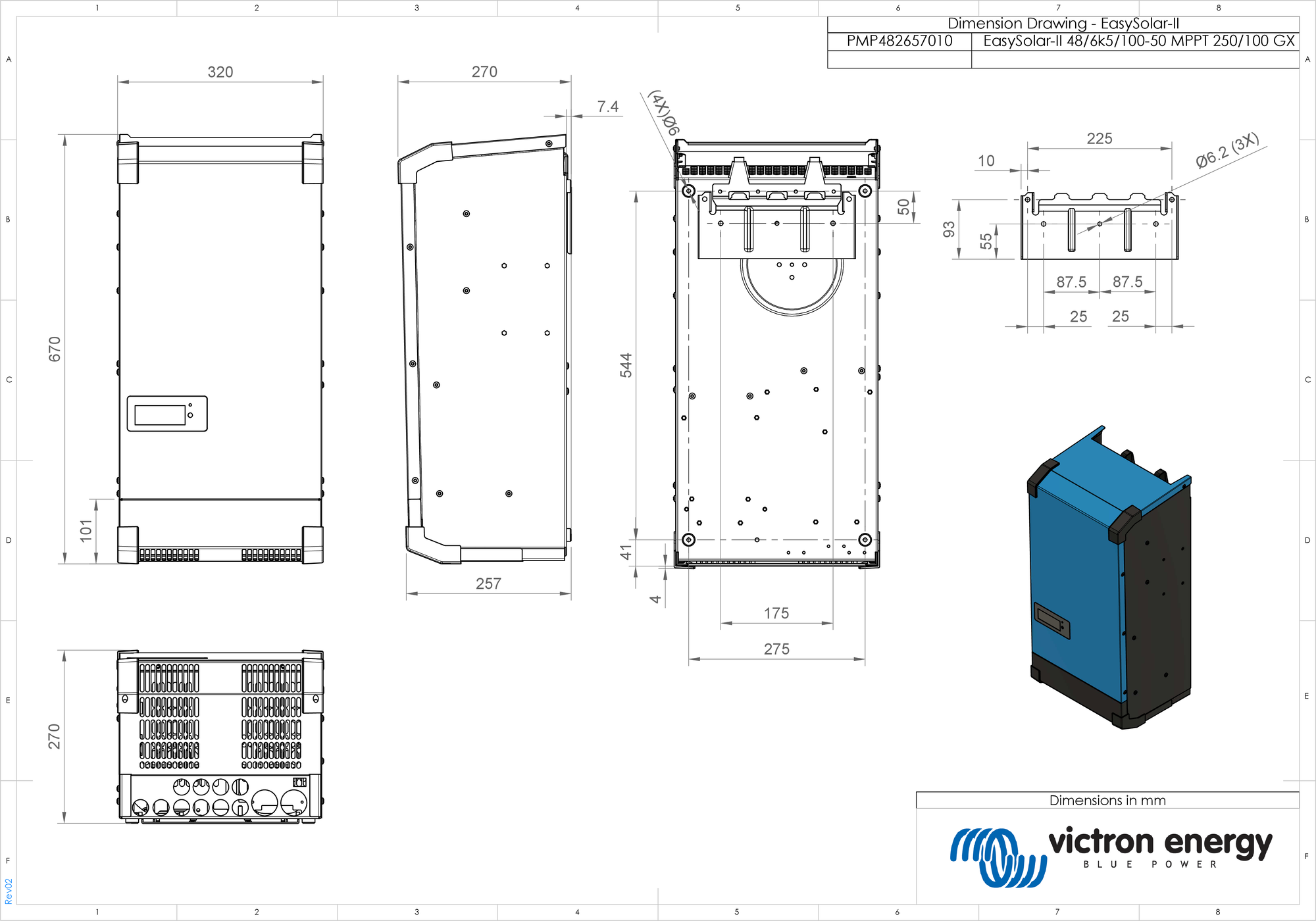

13.3. G: Enclosure dimensions
4500 W
6500 W
