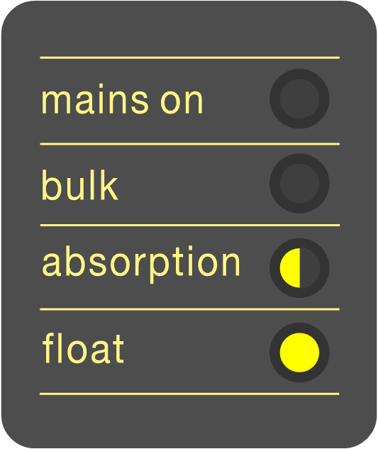

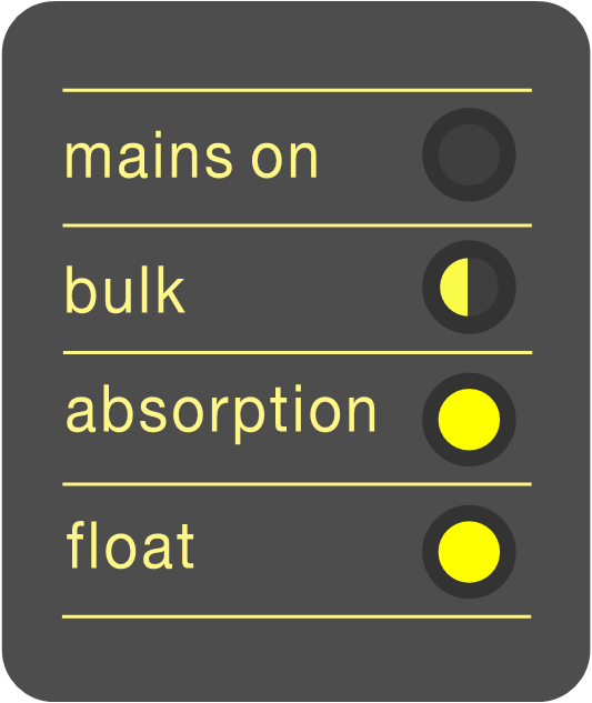

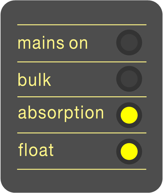

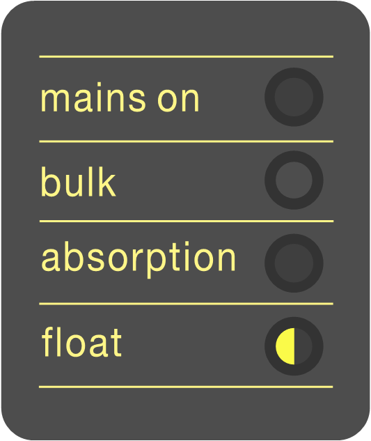

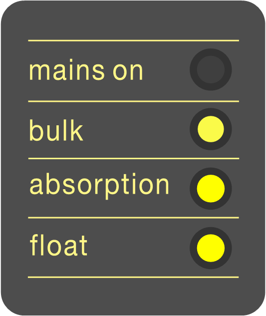

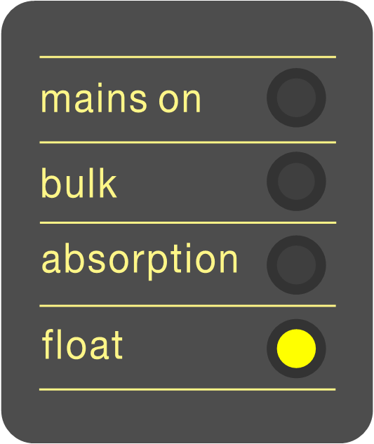

The lower three LEDs in the left column on the control panel indicate which parameter is being adjusted according to the table below:
Menu item | LEDs | Parameter | Default | Range |
1 | ![]() | Scaling factor | 0 | 0 - 9 |
2 | ![]() | Generator current (A) | 16 | 0 - 198 |
3 | ![]() | Upper AC current limit for AC1 input (A) | 254 | 0 - 254 |
4 | ![]() | Upper AC current limit for AC2 input (A) | 254 | 0 - 254 |
5 | ![]() | Upper AC current limit for AC3 input (A) | 254 | 0 - 254 |
6 | ![]() | Upper AC current limit for AC4 input (A) | 254 | 0 - 254 |
= LED is off,
= LED is blinking,
= LED is on
6.2. Scaling factor
