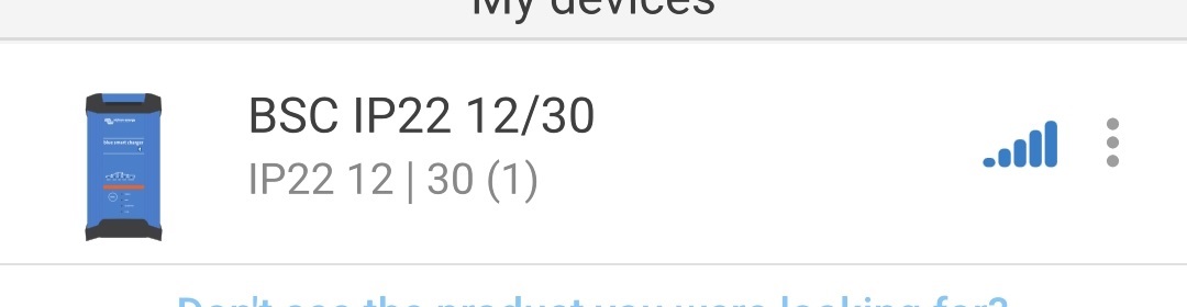

Connect the Blue Smart IP22 Charger AC power cable to a mains power outlet; after a short delay the LEDs indicating the current charge mode and charge state will illuminate.

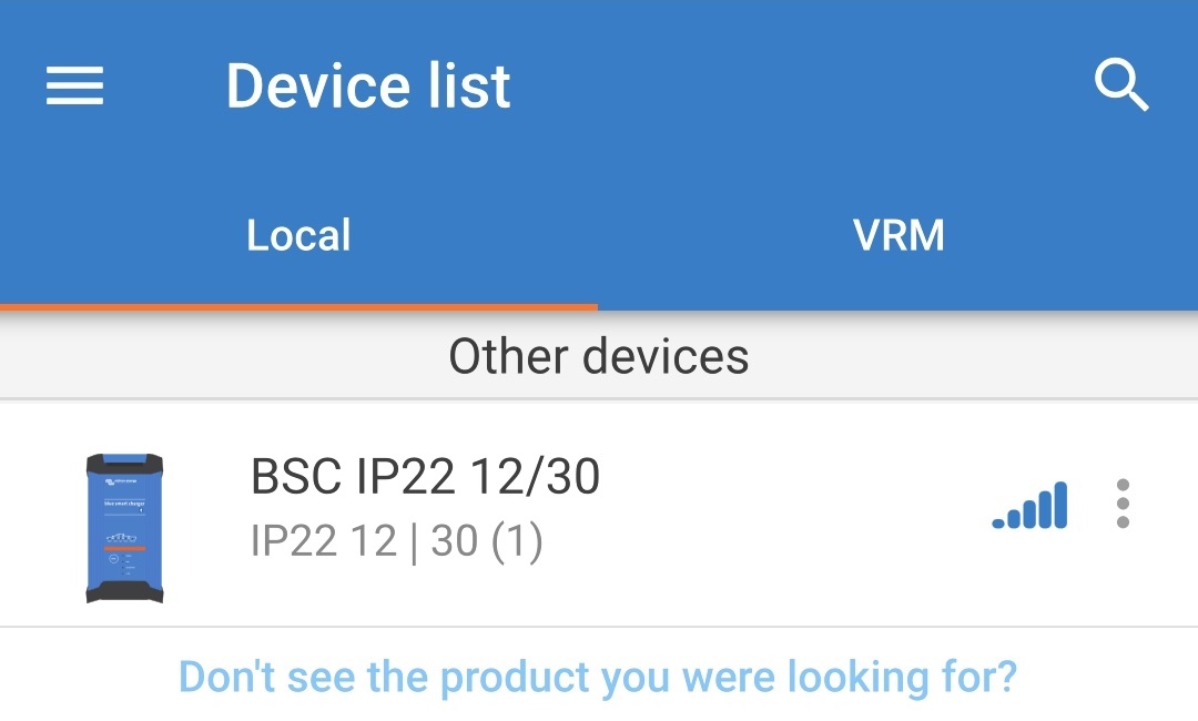

Open the VictronConnect app and locate the Blue Smart IP22 Charger in the Device list Local page, under Other devices.
In case the Blue Smart IP22 Charger does not automatically appear, ensure that the mobile phone or tablet has Bluetooth enabled and is within close range, then perform a manual scan for devices by selecting the Scan button (round orange button with circular arrow) in the bottom right corner.
Select the Blue Smart IP22 Charger from the Device list Local page, under Other devices.
VictronConnect will attempt to establish a Bluetooth connection with the Blue Smart IP22 Charger and display the connection progress in the Connecting pop-up dialog box.

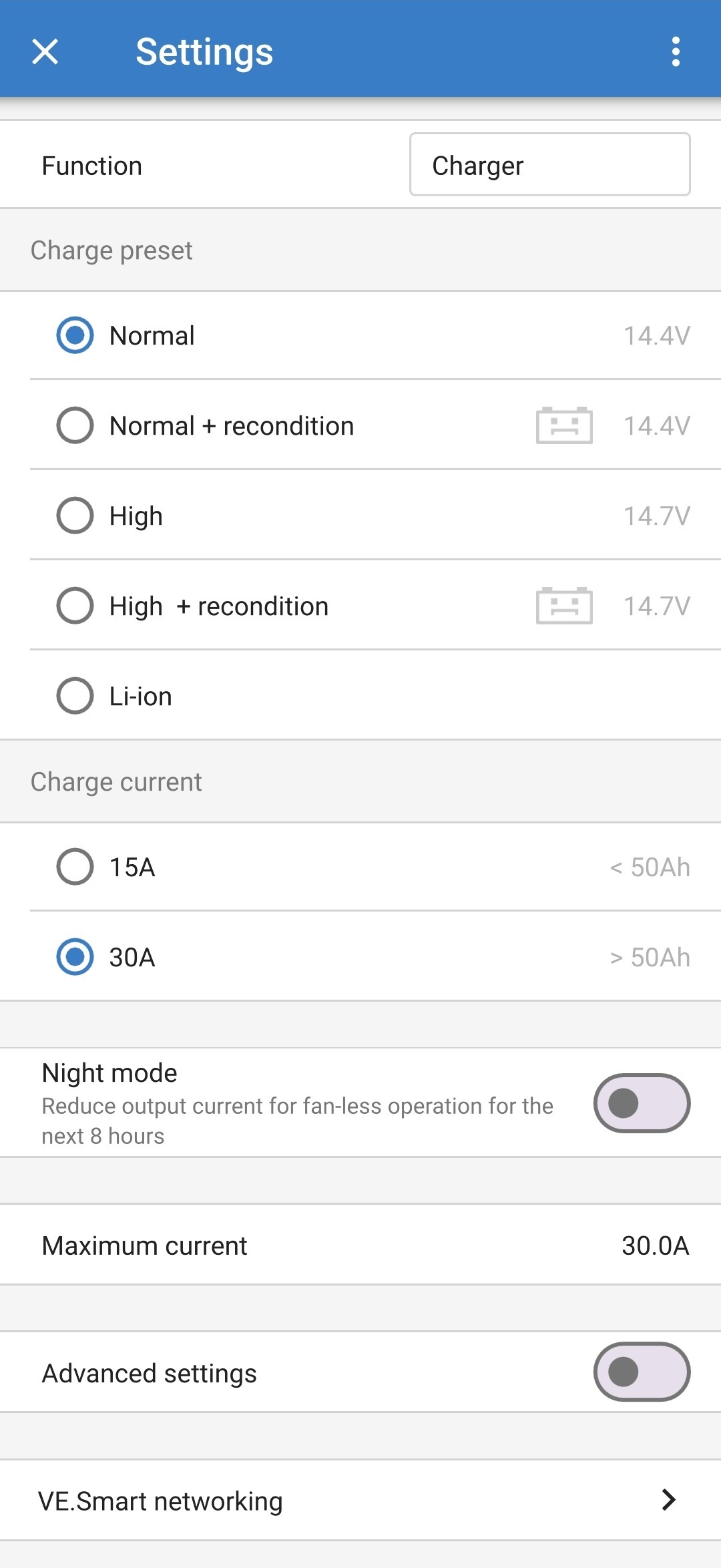

Select the Settings icon (gear in the top right corner) to access the Settings page.
Select the most appropriate integrated charge mode (Normal, Normal + Recondition, High, High + Recondition or Li-ion) from the Charge preset menu.
Ensure that recondition stage is only enabled when required, as unnecessary or overuse will reduce battery life.

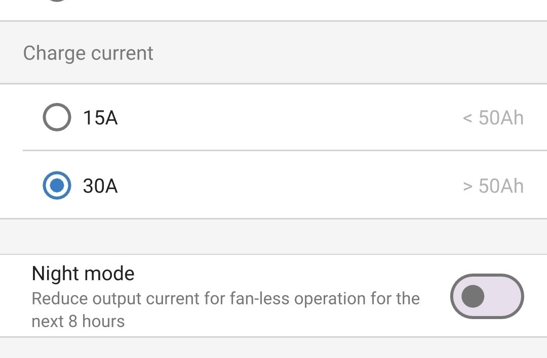

If the maximum rated charge current is excessive, enable low current mode (charge current limited to 50% of the maximum rated charge current). To enable (or disable) low current mode select the required option from the Charge current menu; when enabled the NIGHT LED will blink.
Alternatively night mode can be enabled, which temporarily activates low current mode for a period of 8 hours (typically overnight to eliminate fan noise). To enable (or disable) night mode toggle the Night mode switch on (or off to disable); when enabled the NIGHT LED will illuminate.
Lock Mode Button - When enabled, the mode button is locked and cannot change the charger’s configuration. However, the following functions still work:
Restart charge cycle to Bulk
Enable Night mode
Reset Bluetooth
When locked, pressing or holding the button will cause all LEDs to flash to indicate the lock is active.
All settings are stored and will not be lost when the charger is disconnected from mains power or the battery.

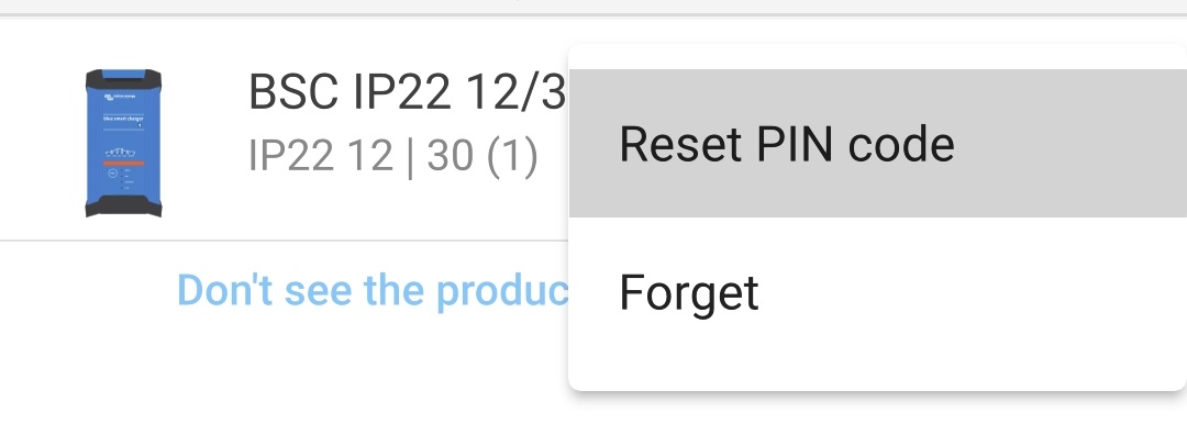

Select the Device options icon (three vertical dots on the right side of the description) to access the dropdown menu.
Select Reset PIN code from the dropdown menu to open the Reset PIN code pop-up dialog box.
Enter the PUK code (recorded earlier) and select OK.

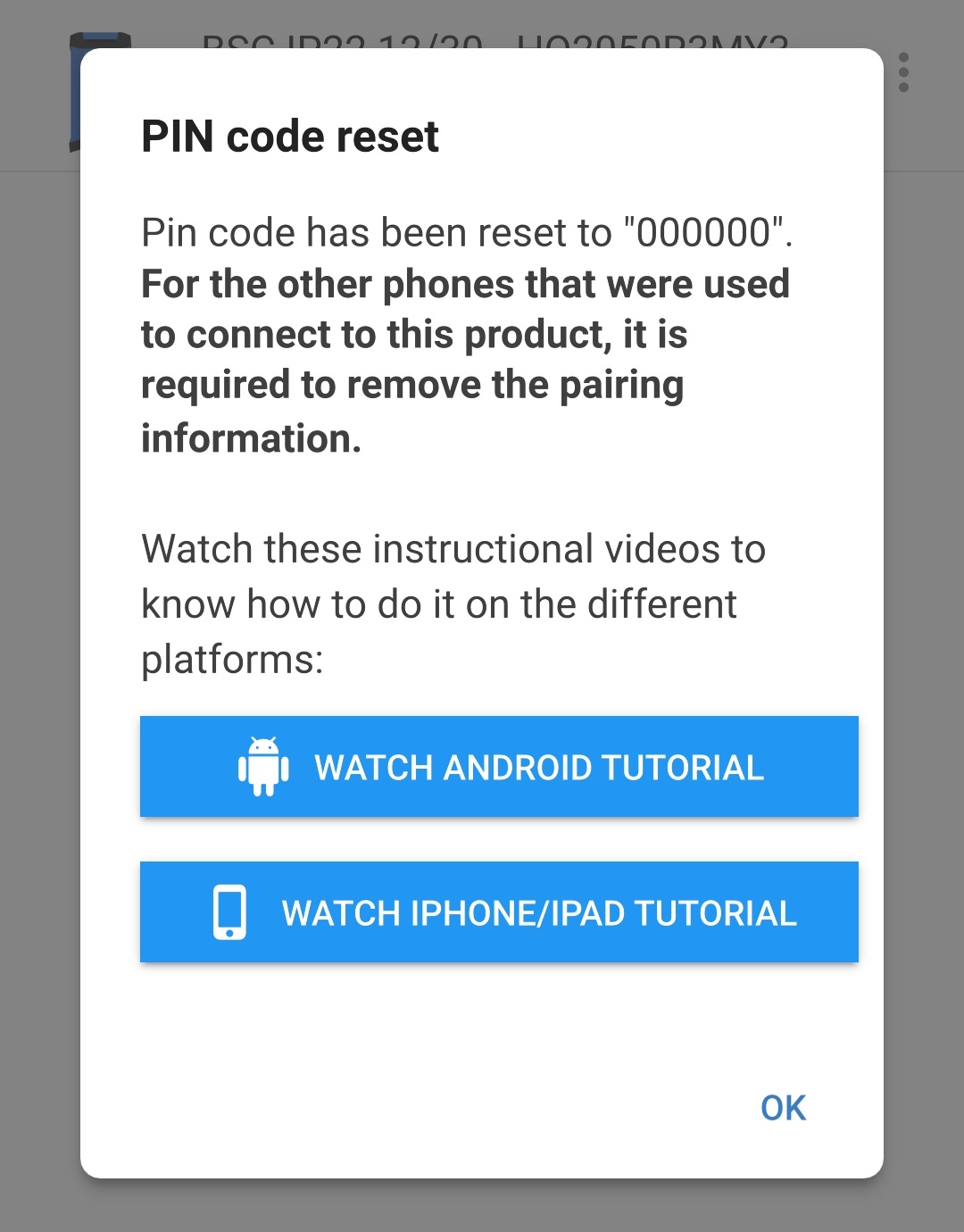

A pop-up dialog box with the text "Busy" will be displayed while the Bluetooth PIN code is being reset.
After a short delay a pop-up dialog box will appear confirming that the Bluetooth PIN code has been successfully reset; select OK to exit into the VictronConnect Device list LOCAL page.
The Bluetooth PIN code has now been reset to 000000.

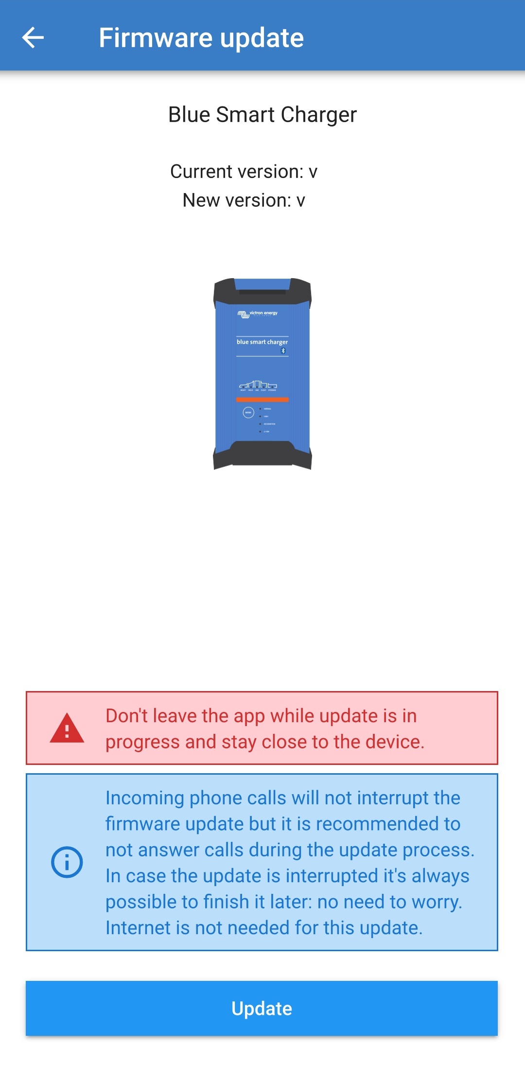

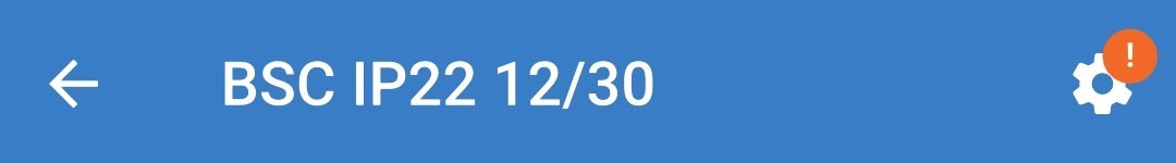

When a firmware update is available, notification is provided via an exclamation mark within an orange circle positioned over the Setting icon (gear in the top right corner); select the Settings icon to access the Settings page.
Refer to the dialog box at the top of the Settings page to determine the level/urgency of the firmware update available, then select UPDATE to access the Firmware update page.
Refer to the current and new firmware versions stated at the top of the Firmware update page, then select Update to proceed.
The firmware update will commence and a progress bar will be displayed within the Firmware update page.
Ensure that the Bluetooth enabled device (mobile phone or tablet) remains close to the Blue Smart IP22 Charger until the firmware update is complete and avoid using the device during this period; be patient as the firmware update may take several minutes to complete.
If the firmware update does fail for some reason, a notification with the failure reason will be provided within the Firmware update page; select Continue to exit into the VictronConnect Device list Local page and re-attempt the firmware update.
Confirmation that the firmware has been successfully updated and the new firmware version will be provided within the Firmware update page when the firmware update is complete; select Continue to exit into the VictronConnect Device list Local page.
The firmware has now been updated.

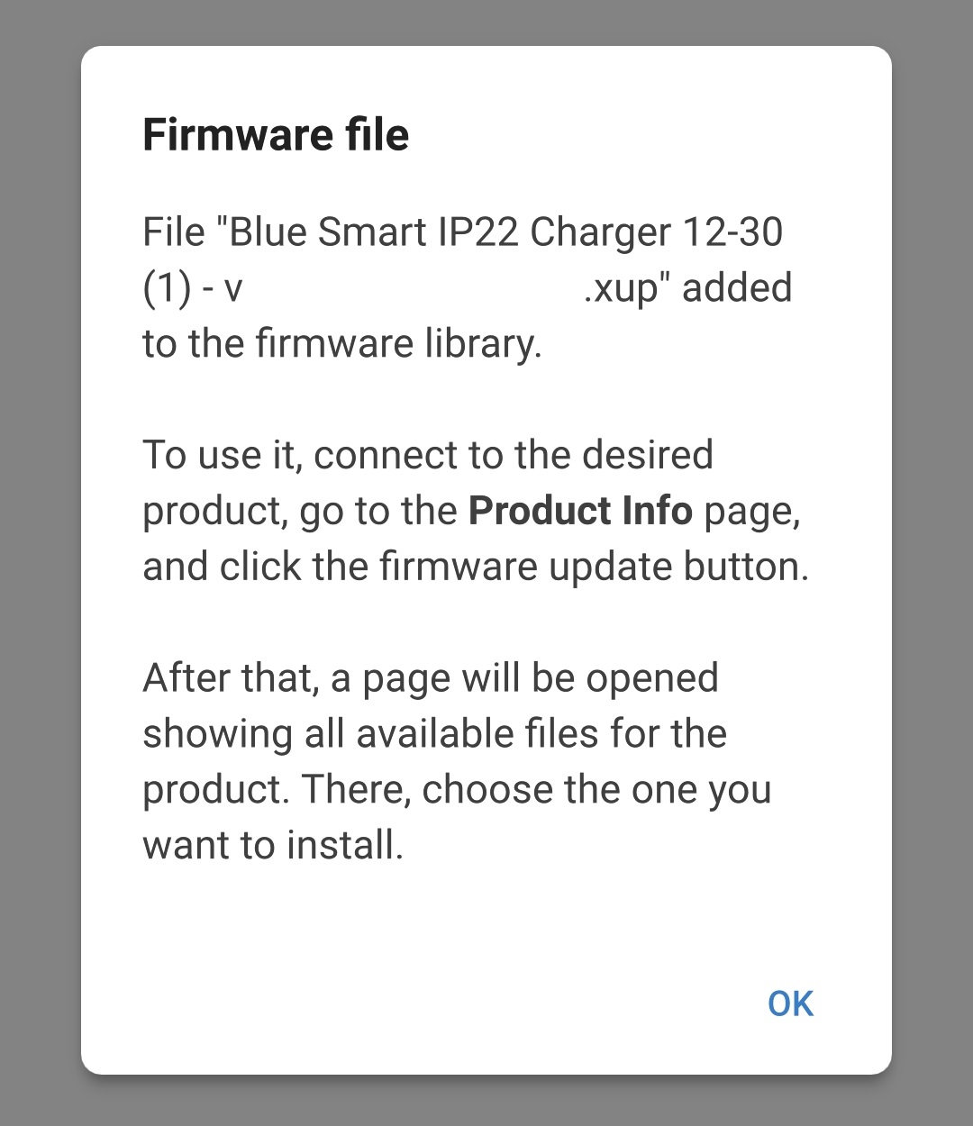

Using a Bluetooth enabled device (mobile phone or tablet) with the VictronConnect app installed, access the required firmware file (.xup file extension) via a file browser, file hosting service/application, collaboration service/application, or email service/application and directly open the file (if prompted, select Open with VictronConnect).
After a short delay the VictronConnnect app will automatically open and then a pop-up dialog box will appear confirming that the firmware file has been successfully loaded into the Firmware library; if the VictronConnect app does not open and/or the pop-up dialog box does not appear try a different method to access the file.

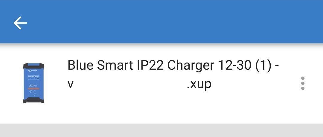

Select MANUAL UPDATE in the Firmware field to open the Firmware library page.
Select the Blue Smart IP22 Charger firmware file that has just been manually loaded from the the Firmware library page (if multiple firmware versions have been manually loaded, ensure the correct version is selected) to access the Firmware update page.
If no firmware files are listed within the the Firmware library page, the Firmware file previously loaded is likely not compatible with the specific Blue Smart IP22 Charger model or hardware version being updated.
Due to this mechanism it is not possible to update with a non-compatible firmware file; if there is uncertainty about which firmware file is correct for the specific Blue Smart IP22 Charger model being updated, multiple firmware files can be safely loaded.
