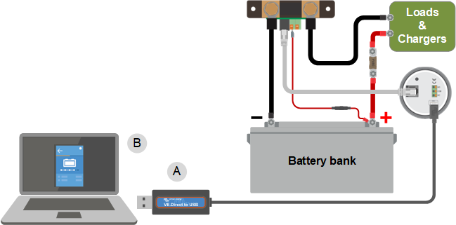

Example of a VE.Direct to USB interface connection between the battery monitor and a computer.
# | Description |
A | VE.Direct to USB interface. |
B | Computer or laptop. |
