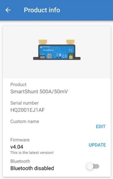

7.1.2. Accessing settings via the VictronConnect app
To access and change setting parameters do the following:
Click on the settings symbol
to go to the battery settings menu.To navigate from the general settings menu to the product settings menu, click on the menu symbol
For information on how to connect with the VictronConnect app to the battery monitor, see the The VictronConnect app chapter.

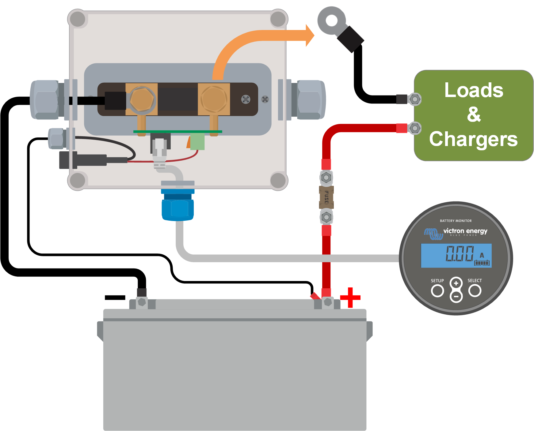

7.6.9. Current measurement direction
The current-measurement direction setting allows you to choose on which side of the shunt the battery (or battery bank) is connected. This ensures that current-flow calculations use the correct polarity.
Normal mode (off): the battery negative is connected to the shunt’s battery terminal.
Reversed mode (on): the battery negative is connected to the shunt’s load terminal.
VictronConnect app setting | Default setting | Modes |
Current measurement direction | Normal | Normal Reversed |
BMV dispay setting | Default setting | Modes |
Reverse shunt direction (setting 76) | off | off on |
Notice
This setting was introduced in firmware version v4.19 and is not supported in earlier versions.
This setting is protected by the "Settings Lock" feature (so if the settings are locked, this setting cannot be changed).

7.7.3. Serial number
The serial number can be found in the battery monitor product info section of the VictronConnect app or on the product information sticker rear of the battery monitor head unit.
7.7.4. Disabling and re-enabling Bluetooth
Bluetooth is enabled by default in the battery monitor. If Bluetooth is not wanted it can be disabled. This is done by sliding the Bluetooth switch in the product settings.
A reason to disable Bluetooth could be for security reasons, or to eliminate unwanted transmission from the Battery monitor.
As soon as Bluetooth has been disabled the only way to communicate with the battery monitor is via its VE.Direct port.
This is done via the USB to VE.Direct interface or via a GX device connected to the battery monitor via a VE.Direct cable or the USB to VE.Direct interface. For more info see the VictronConnect app via USB chapter.
Bluetooth can be re-enabled by connecting to the battery monitor with VictronConnect via the VE.Direct – USB interface. Once connected you can navigate to the product settings menu and re-enable Bluetooth.
For more information also see the VictronConnect manual.
VictronConnect product info screen.
7.7.5. Changing PIN code
In the battery monitor Bluetooth interface product info the PIN code can be changed.
7.7.6. Custom name
In the battery monitor product information screen, you can change the name of the battery monitor. By default, it is called by its product name. But a more applicable name might be needed, especially if you are using multiple battery monitors in close proximity of each other it might become confusing with which battery monitor you are communicating. You can, for example, add identification numbers to their name, like: Battery Monitor A, Battery Monitor B and so on.
