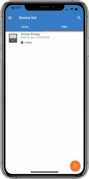

Device list
LOCAL - This page shows all the Victron products that have been discovered by your device, and to which a connection can be made. Click on the desired product.
VictronConnect - Device List - LOCAL

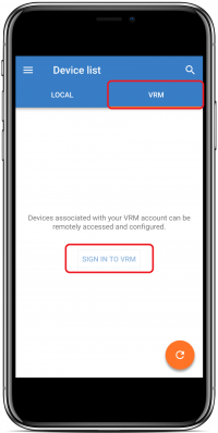

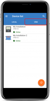

VRM - This page will show a GX device if it is connected to your VRM account.
VictronConnect - Device List - VRM

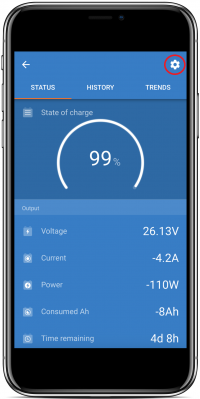

Battery Monitor pages:
Clicking on 'Battery Monitor' will show the current state of charge; and allows you to toggle between screens showing more detailed information concerning the current battery STATUS, and HISTORY data.
  • To access 'Settings' click on the cog icon at the top right of the screen.
From 'Settings' you can change the data concerning your battery storage; set alarms and relays; change charging parameters; tailor the appearance and quantity of data displayed and set up or join an existing VE.Smart network.
VictronConnect - BMV VictronConnect - BMV history VictronConnect - BMV settings VictronConnect - BMV relay settings VictronConnect - BMV alarm settings VictronConnect - BMV display settings VictronConnect - BMV misc settings VictronConnect - BMV networking settings

Finding the Bluetooth menu
First complete your connection; then go to the Product info page by clicking the button on the upper right:
  • For some products, it will be the settings icon: . After opening that menu press , and click Product info.
  • For other products you'll find the button on the upper right, which takes you straight to the Product info page.

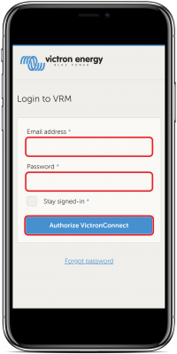

  1. Confirm that the phone, tablet or PC has VictronConnect installed and that the software version meets or exceeds the minimum requirements - upgrade if necessary
  2. Authorize VictronConnect to access your VRM account;
  • Open the VictronConnect app
  • Swipe across to the VRM tab, then select ‘SIGN IN TO VRM’
  • Complete your email address and VRM password, then select ‘Authorize Victron Connect’
VictronConnect-Remote - VRM Tab Sign In VictronConnect-Remote - Login to VRM

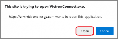

  • If using a tablet or PC your browser may also request permission to proceed, if prompted select ‘Open’
VictronConnect-Remote - Permission

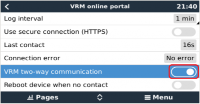

10.3.3 GX Device
1- Confirm that the GX Device is running Venus OS firmware version that meets or exceeds the minimum requirements - upgrade if necessary 2- Enable ‘VRM two-way communication’ under Device List > Settings > VRM Online Portal
VictronConnect-Remote - GX Device Settings
10.4 Local Tab
The local tab displays all devices that are within local Bluetooth and wireless LAN range or physically connected to the phone, tablet or PC with VictronConnect (such as with a VE.Direct to USB or MK3 to USB interface cable)
VictronConnect-Remote - Local Tab
10.5 VRM Tab
The VRM tab displays all VRM installations associated with the VRM user profile.
Any installation can be selected to access the VRM online portal or connected devices.
When a VRM installation is selected it will take a few seconds for a connection to be made, once the connection is established two tabs will appear, an ‘OVERVIEW’ tab and a ‘DEVICES’ tab.

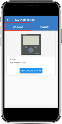

10.5.1 Overview Tab
The ‘OVERVIEW’ tab has an image of the GX device, the name of the VRM installation and a direct link to the associated VRM Online Portal.
VictronConnect-Remote - Installation Connecting VictronConnect-Remote - Overview Tab

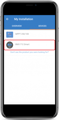

10.5.2 Devices Tab
The ‘DEVICES’ tab has a list of all compatible devices that are physically connected to the GX device.
VictronConnect-Remote - Devices Tab
If using a tablet or PC, the ‘DEVICES’ tab is shown as a panel on the right side of the same screen.
VictronConnect-Remote - Tablet View

Immediately after initial connection settings and historical data will be downloaded, during this time a cloud symbol will remain in the upper right corner (this typically takes less than 30 seconds).
Settings cannot be accessed until the cloud symbol is replaced by the normal settings gear symbol.
VictronConnect-Remote - BMV Settings Download VictronConnect-Remote - BMV Settings Ready

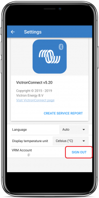

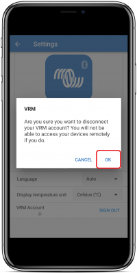

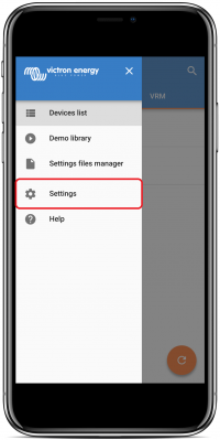

10.7 Signing out
To disable the link between VictronConnect-Remote and your VRM account, expand the main menu and then select ‘Settings’.
VictronConnect-Remote - Sign Out 1 VictronConnect-Remote - Sign Out 2
In the settings page select ‘SIGN OUT’ and then select ‘OK’ in the prompt window to confirm.
VictronConnect-Remote - Sign Out 3 VictronConnect-Remote - Sign Out 4
After signing out VictronConnect-Remote will no longer have access to the VRM account or any of the associated VRM installations. To reinstate access the log in procedure needs to be repeated.

  • Ensure that ‘VRM two-way communication’ is enabled – see the ‘settings’ section.

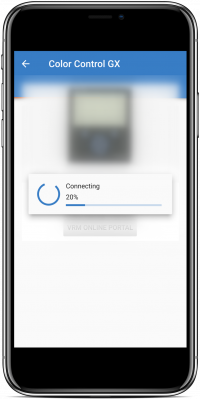

Connection fails around 20%
  1. Make sure you are up to date with the latest version of VictronConnect.
  2. Remove the device from the paired devices list in the phones Bluetooth settings.
  3. Force close the VictronConnect app. Instructions: how to for iPhone and iPad, how to for Android. If you are unsure how to do this, then uninstalling and re-installing the app works as well)
  4. Reconnecting in VictronConnect using the default PIN 000000
