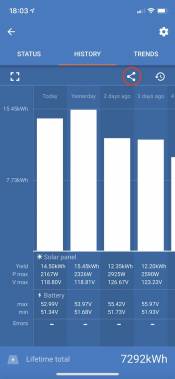

3. HISTORY - Thirty-day Graphic
VictronConnect - MPPT history
(The fragmented square icon (top left) allows you to toggle between 'portrait' and 'landscape' screen presentations.)
A summary of activity for the last 30 days is presented graphically. Swipe the bar left or right to show any of the previous 30 days.
The daily log shows:
  • Yield: The energy converted for that day.
  • P max: The maximum power recorded during the day.
  • V max: The highest voltage from the PV array during the day.
Clicking on any day/bar in the graph will expand the information to show charge-status times - both as hrs/m; and also as a percentage of the 'charge' day. This graphic provides an at-a-glance representation of how much time your charger is spending in each of three modes: Bulk / Absorption / Float.
Tip! You can use the charge times to see if the PV array is properly sized for your requirements. A system which never reaches 'Float' may need more panels; or perhaps the load could be reduced?
(If you are operating an ESS (Energy Storage System) the charge time for this will be included in the 'Bulk' reading.)
It is possible to export the history as a comma separated file (.csv) by clicking the three connected dots at the top right of the history screen:
This is an example of the exported data for 3 of 30 days:

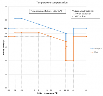

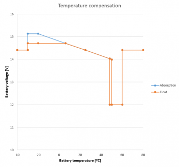

Temperature compensation
Many types of battery require a lower charge voltage in warm operating conditions, and a higher charge voltage in cold operating conditions.
The configured coefficient is in mV per degree Celsius for the whole battery bank, not per cell. The base temperature for the compensation is 25°C (77°F), as shown in the chart below.
Battery voltage adjustment based on battery temperature (14.4V as setpoint, compensation factor = 16.2mV/ºC)
With a Smart Battery Sense is installed; the actual battery temperature will be used for compensation; throughout the day.
In case there is no external source for battery temperature; charger uses its internal temperature for battery temperature compensation. The temperature reading is taken in the morning; when the charger has been idle for at least one hour, i.e. when the charger is not actively charging a battery or supplying a load.

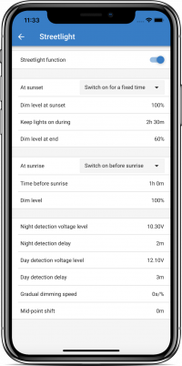

4.3 Streetlight settings
Introduction
The Streetlight function allows you to automatically control night lighting - it's duration, and brilliance. When the Streetlight function is enabled a timer program can be created whereby Sunset, Sunrise as well as Midnight can be used as the anchor points for the timer program. These anchor points will automatically adjust itself to the duration of night-time as it changes with the seasons.
Streetlight, TX Pin, Relay as well as the Load output configuration
For our smaller chargers, that have a set of dedicated load output terminals, the light can be powered from those terminals. For larger chargers, the TX can be used, as a 'virtual load output'. Or, for models having a relay, also the relay can be used. See TX Pin and Relay chapters for details.
Note that, both for the real load output, and TX pin or Relay as 'virtual load output' the streetlight algorithm is applied in conjuction with the settings as configured in the Load output menu:
If streetlight is disabled, then the (virtual) load output is controlled only by the configuration as made in the load output menu.
If streetlight is enabled, then its an AND function: the load output will be on when both the condition made in the Load output menu are satisfied as well as the streetlight settings. Otherwise, its off.
Therefore, in a streetlight application, the load output setting is typically set to either Always on, or to Battery life. Its is never configured to Always off as that will result in the light to be always off. For more configurable voltage levels to force the light off, the other load output options (conv alg., user alg.) can be used.
Setting the Sunset action
At sunset you can choose from the following actions:
  • Keep the lights off
  • Switch on for a fixed time. This option will turn the light on at sunset, and then off after a configurable interval. When the dimming feature is enabled (1), two dim-levels can be entered: one for the “on” period; and a second for the “off” period. A typical use case for these options is to get a strong light during high traffic hours (right after sunset), and lower intensity during the low hours, to save the battery. Set the second dim level to 0% to switch the light completely off during that second section.
  • Switch on till midnight. This option turns the light on at sunset, and then off at midnight. When the dimming feature is enabled (1), two dim-levels can be entered: one for the “on” period (up to midnight) and a second dim-level for the “off” period after midnight. Set the second dim level to 0% to switch the light completely off during that second section.
  • Switch on till sunrise. This options turns the light on at sunset, and then off at sunrise. When this option is selected; there is no need to also select an action at sunrise, and therefore the sunrise control option will be hidden. When the dimming feature is enabled (1), one dim level be configured, Dim level at sunset.
1) the dimming feature requires the TX Port function to be configured to PWM. The dim level inputs are only available when the TX Port is configured accordingly. See chapter 4.4 below for details.
Setting the Sunrise action
At sunrise you can choose to:
  • Switch off: Turns the light off at sunrise.
  • Switch on before sunrise: This option switches the light on at a configurable time interval before sunrise; and then switches the light off at sunrise. In case the dimming feature is enabled (1), this feature allows to configure a more intense light interval during early morning rush hours. Together with the Sunset action, you can now configure three dim levels: one at sunset rush hour, one during the low traffic hours, and the third on during the early morning rush hours.

Example configuration
The selections which have been made on below screen image (click to enlarge) result in this program:
  • At sunset - the light will be switched on for a fixed time
  • Dim level at sunset - at Full brilliance (100%)
  • Keep lights on during - the duration has been set to 1h 0m
  • Dim level at end - at the end of one hour the brilliance will be reduced to half (50%)
Also;
  • At sunrise - the lighting will be adjusted before sunrise
  • Time before sunrise - at 1h 0m before sunrise, the following adjustment will be made:
  • Dim level - full brilliance will be restored (100%)
