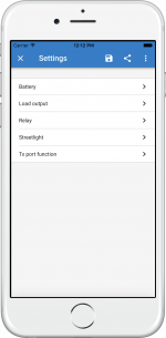

4. Settings
VictronConnect - MPPT settings
The settings page is accessed by clicking on the Cog icon at the top right of the Home page. The settings page provides access to view or change the settings of the Battery; Load; Streetlight; and Port functions. From this page you can also view Product information such as the Firmware versions installed on the MPPT Solar Charger.

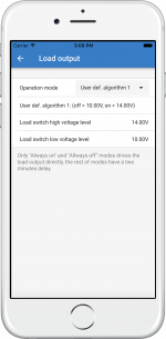

4.2 Load output
This section applies to all products. These settings are typically used on the smaller models which have a dedicated load output (75/10, 75/15, 100/15 and 100/20).
For larger models without a load output, the load settings can be used to drive the TX pin in the VE.Direct port, which can then be used to drive a BatteryProtect relay or other load-shedding device. See chapter 4.4 Tx port function, option 5: Virtual Load output, for more information.
VictronConnect - MPPT load output settings
The available programs are:
  1. Always off
  2. BatteryLife algorithm: Self adapting algorithm to maximize life of the battery. See manual for details.
  3. Conventional algorithm 1: Off when Vbatt < 11.10V. And On when Vbatt > 13.10V. (12V battery assumed)
  4. Conventional algorithm 2: Off when Vbatt < 11.80V. And On when Vbatt > 14.00V.
  5. Always on
  6. User defined algorithm 1: Off when Vbatt < Vlow. And On when Vbatt > Vhigh.
  7. User defined algorithm 2: Off when Vbatt < Vlow or Vbatt > Vhigh. And On when Vbatt between Vlow and Vhigh.
  8. Automatic Energy Selector: Off when Vbatt < Vlow. And On when Vbatt > Vhigh. When conditions are met Load will be on for a pre-selected time. Note; This mode is only available on SmartSolar Models.
Note that, by default, the models with a load output have their algorithm selected with a jumper in the VE.Direct port. This can be disabled using the VE.Direct Rx pin configuration (see 4.5 below). Or remove the jumper from the VE.Direct port when using VictronConnect to configure the load ouput operation mode, the drawing below shows where the jumper is located.
Keep in mind that modes 1 (always off) and 5 (always on) will respond immediately. The other modes, sensing the battery voltage, have a delay of 2 minutes before the load output changes. This is so that the charger does not respond too quickly when, for example, an inrush current briefly lowers the battery voltage below the threshold.
Larger models offer a 'Streetlighting Algorithm' (see 4.3 below); this too will be 'controlled' by the Load Output settings in order to protect the battery from being too deeply drained: Streetlight settings will be overridden if the battery voltage falls below a chosen value. When the battery voltage is restored to chosen parameters, the Streetlighting function will resume. In this way the two functions work together.
The load output (on the smaller MPPT models) always acts as a switch - off when load output is off or streetlight dimming is at 0%; and on when load output is on and streetlight dimming is between 1 and 100% (see 4.3 below: Gradual Dimming speed).
This setting defines the function of the Tx pin located inside the VE.Direct connector. Use the VE.Direct TX digital output cable, ASS030550500 to access - and therefore receive signals from - the pin.
VictronConnect - MPPT TX port settings settings
Available options:
  1. Normal communication (default). Use this when connecting to a Color Control GX, a VE.Direct Bluetooth Smart dongle, or any other device that needs to communicate with the MPPT.
  2. Pulse every 0.01 kWh. Selecting this option causes a pulse to be emitted for every 0.01kWh of energy harvested, the TX port is normally high and will be driven low for approximately 250ms for every 0.01kWh harvested. This function is useful in combination with an energy meter.
  3. Light dimming (pwm normal). Use this function in combination with the Streetlight algorithm. PWM will be at 100% duty cycle when full light intensity is required.
  4. Light dimming (pwm inverted). Use this function in combination with the Streetlight algorithm. PWM signal will be 0% duty cycle when full light intensity is required.
  5. Virtual load output. The TX pin will switch in harmony with the load output port. The purpose of this is to use the BatteryLife algorithm, or Streetlight algorithm, on the larger models which do not have a dedicated load output. Connect the VE.Direct TX digital output cable to a BatteryProtect module or a solid state relay.
Notes:
  • The PWM signal output (when using options 3 and 4) operates at a fixed frequency of 160Hz and has a fixed voltage level of 5V.
  • Using options 2 through to 5 does not disable the ability of the unit to communicate - what happens is that the unit will automatically detect incoming data, and whilst that data is being received it will resume normal communication (as in option 1) for the duration of that data-reception. When the unit detects that the data-reception has been completed, it will automatically resume whichever option (2 -5) has been manually selected.

  1. Remote on/off (This is the default setting on all larger models). This setting allows remote on/off control: (0V = switch charger off, +5V (or a signal sent via VE.Direct communication) = switch charger on). An example of this operation is when the unit is connected to a VE.BUS BMS (using a VE.Direct non inverting remote on-off cable, ASS030550300).
  2. Load output configuration (This is the default setting on the following models: 75/10, 75/15, 100/15 and 100/20). The Tx pin can be used to place a jumper to select load output operation. See Load output chapter (4.2 above) for details.
  3. Load output on/off inverted This setting reverses the load output on/off control: (0V = switch load output on, +5V = switch load output off)
  4. Load output on/off normal This setting allows load output on/off control: (0V = switch load output off, +5V = switch load output on)
Note: These settings work in a similar way to a remote on/off switch, but instead they control the load output.

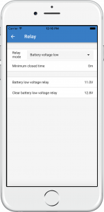

5. Programmable relay
VictronConnect - Relay
A programmable relay switch is available on some SmartSolar models. The datasheet for your model will tell you whether or not it is available.
The relay offers three connections:
  1. NO (Normally Open)
  2. C (Common)
  3. NC (Normally Closed)
Relay state Connection between
Switched ON C and NO
Switched OFF C and NC
The conditions for switching the relay depend on the relay mode setting, note that the conditions for switching over must be present for at least 10 seconds before the relay will change position.
Relay mode
  1. Relay always off. This option switches the relay OFF. It will disable the other relay options. Use this option if you do not plan to use the relay function.
  2. Panel voltage high. This option switches the relay ON when the panel voltage becomes too high. See Panel voltage high mode settings below.
  3. High temperature (Dimming). This option switches the relay ON when the charger output current is reduced due to high temperatures. Use this option to for example switch an external fan.
  4. Battery voltage Low. This option switches the relay in ON when the battery voltage falls too low, see Battery voltage Low settings below. This is the default setting when the relay function is active.
  5. Equalization active. This option switches the relay ON when the manual equalization mode is active.
  6. Error state. This option switches the relay ON when there is an error.
  7. Defrost option (Temp < -20?). This option switches the relay ON when the Charger temperature falls below -20 degrees Centigrade.
  8. Battery voltage high. This option switches the relay ON when the battery voltage is too high, see Battery voltage High settings below.
  9. Float or Storage state. This option switches the relay ON when the charger is in the float state.
  10. Day detection (Panels irradiated). This option switches the relay ON whilst the solar panels are providing energy (Day/Night detection).
  11. Load output. This option switches the relay ON and OFF according to the settings chosen in 'Load Output' (4.2 above): Load on = Relay switched ON. Load off = Relay switched OFF. The purpose of this is to use the BatteryLife algorithm, or Streetlight algorithm, on the larger models which do not have a dedicated load output.
Panel voltage High settings
  1. Panel high voltage. (User-defined Voltage)
  2. Clear panel high voltage. (User-defined Voltage)
This option switches the relay ON when the panel voltage rises above the chosen “Panel high voltage” setting, and switches the relay OFF when the panel voltage falls below the chosen “Clear panel high voltage” setting. Ensure, of course, that the “Panel high voltage” setting is greater than the “Clear panel high voltage” setting. These settings must never exceed the maximum voltage-rating allowed by your MPPT charger.
  1. Battery low-voltage relay. (The default setting for this is 10.00V) (12V battery assumed)
  2. Clear battery low-voltage relay. (The default setting for this is 10.50V)
These settings, which can be user-defined, will cause the relay to switch ON when the battery voltage falls below the chosen “Battery low-voltage” setting; and will cause the relay to switch OFF when the battery voltage once again rises above the “Clear battery low-voltage” setting. Ensure, of course, that the “Battery low-voltage relay” setting is lower than the “Clear battery low-voltage relay” setting.
An application for this feature, for example, is to automatically disconnect a load in order to prevent a battery from becoming too deeply discharged.
  1. Battery high-voltage relay. (The default setting for this is 16.50V) (12V battery assumed)
  2. Clear battery high-voltage relay. (The default setting for this is 16.00V)
These settings, which can be user-defined, will cause the relay to switch ON when the battery voltage rises above the “Battery high-voltage relay” setting; and will cause the relay to switch OFF when the battery voltage drops below the “Clear battery high-voltage relay” setting. Ensure, of course, that the “Battery high-voltage relay” setting is greater than the “Clear battery high-voltage relay” setting.
An application for this feature, for example, is to disconnect a load in order to protect it from an over-voltage.
General settings
  1. Minimum closed time. (The default setting for this is 0 minutes)
This option sets a minimum-time for the ON condition to prevail once the relay has been switched ON.
An application for this feature, for example, is to set a minimum generator run-time.
