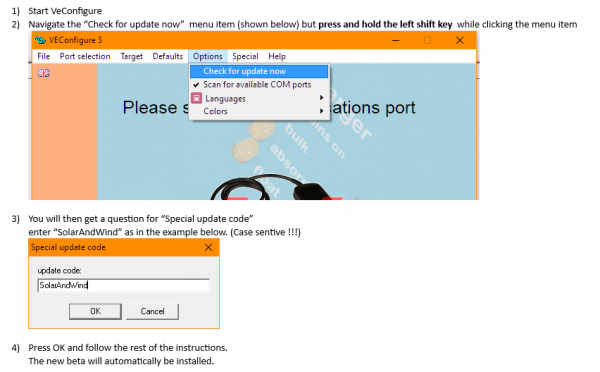

- In case you need to use VEConfigure (in most cases not necessary, use VictronConnect instead), the install it using these instructions:
