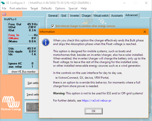

In VEConfigure, there is a new setting, “limit internal charger to prioritize other energy sources”.
Enabling that will make the inverter/charger use mains/shore power to charge up to the configured float voltage only. Instead of up to the, higher, configured absorption voltage.
This charges the battery enough to prevent premature ageing, while at the same time leaving the rest of the charge up to renewable sources, such as wind or solar.
When after seven days the battery still isn’t fully charged, the inverter/charger will complete one charge cycle. These seven days are configurable, it is the repeated absorption interval setting.

Step 2 - Enable the mode
The setting is enabled in VEConfigure, on the advanced tab:
