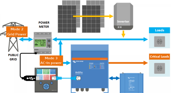

1.2 Mode 2 - Advanced
Same as standard operating mode, but more flexibility is given to implement time shifting, load management or other energy management optimization algorithms.
In standard mode the Hub-4 control system tries to keep the power flowing through the grid meter at 0 Watt (so no power is taken in from the grid, nor is any power fed back to the grid). Mode 2 means you set the target for the grid power. Setting the target to 100 Watt means that the system tries to take 100 Watt from the grid. The power will be used to feed the loads or charge the battery. Similar, a negative value will instruct the system to feed back power to the grid. This will be PV power when possible, otherwise the battery will be discharged. Reset the setpoint back to 0 Watt, and you are back in standard mode again.
In addition you can also control battery charge and discharge. This allows you to control when the battery is charged and discharged.
There are two ways to do this:
  1. Send commands to the CCGX via ModbusTCP: see here for more information about ModbusTCP on the CCGX.
  2. Run self-implemented code on the Color Control GX: complete flexibility and benefit from the VRM Portal and all other functionality already available on the CCGX, without having to add additional cost of extra PLCs or other control modules.

1.3 Mode 3 - Custom
Customer self implements their control loop and grid measurements, and uses the MultiPlus and/or Quattros as simple, remote controllable, bidirectional inverter/chargers that can be set to either charge or discharge an x amount of Watts. Note that the point of control is the AC-input, not the charger itself.
Power to/from AC-input = Power to/from battery + Power to/from AC-output
Necessary Victron equipment:
  1. Multi or Quattro inverter/charger
  2. Color Control GX
  3. Note that there is no AC sensor necessary, since the inverter/charger will act as a 'dumb' bi-directional inverter/charger. It will act on the external command given, which can for example be 'take 2000W from AC in, or feed back 100W through AC in'.

2. Details of operating mode 2 - Advanced
2.1 Available control points
Grid power setpoint - Modbus-TCP register 2700
  • Positive: take power from grid.
  • Negative: send power to grid.
  • Default: 0W.

3. Details of operating mode 3 - Custom
3.1 Operation
Mode 3 means you take direct control of the Multi itself by setting the power it should take/feed back on its AC input. It allows for easy control of the power flowing to the battery. The power flowing to the batter (or more precise: to DC system attached to the Multi) is equal to the AC-In power minus the AC-Out power. In mode 3 you have to create your own control loop, and update set setpoint frequently.
  • When the grid is available, the Multi will be connected to the grid. You can control its operation with the Power setpoint. When positive, energy will flow to the grid. When negative, energy will be taken from the grid. Some examples:
    • When set to +400W, it will feed 400W back through its input. This energy will be taken from the battery. If there is also a 200W AC load connected to AC output the total energy taken from the battery will be 600W. The batteries will always be discharged when the setpoint is positive.
    • When set to -400W, it will take 400W from the AC input. When the load on the output is lower than 400W, it will charge the battery with the difference. When the load on the AC output is higher, it will discharge the battery with the difference. So with a negative setpoint charge/discharge depends also on the connected loads.
