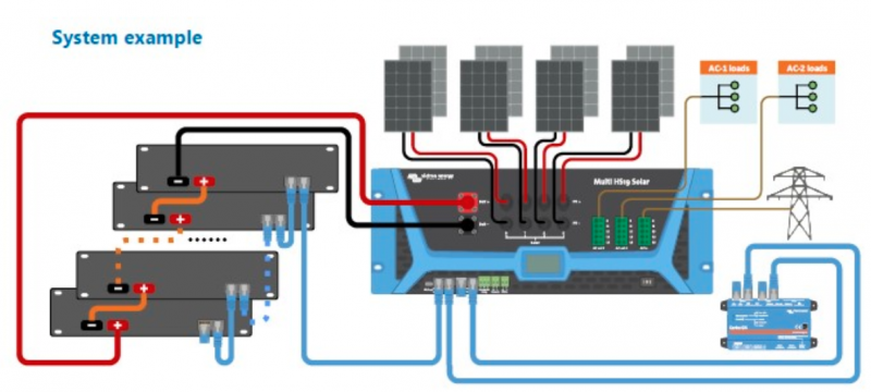

The Victron HS19 high voltage inverter/charger only works with supported and compatible high voltage batteries.
These batteries are strongly recommended to be connected via “BMS-Can” (CANBus) to a GX device. The HS19 supports direct battery connection without a GX device, see product manual further details.
Victron provides the following support documentation to assist qualified system designers and installers to select suitable batteries for their application.
Batteries compatible (or under evaluation) with the Victron HS19.
Click the brand name for the brand-specific setup guide and manufacturer links. This information should always be verified with the battery manufacturer.
