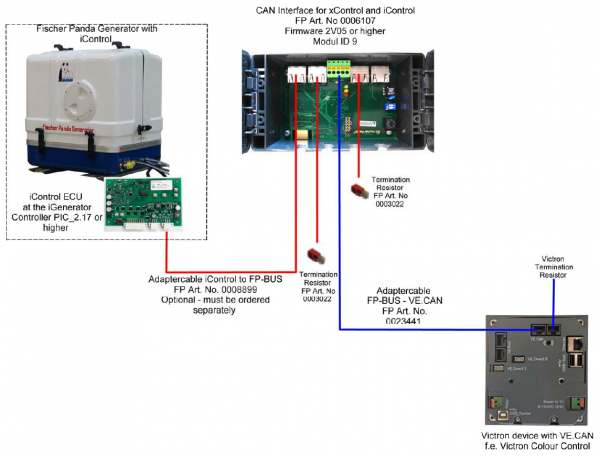

As of CCGX v2.07 it is possible to read data from your Fischer Panda generator. The generator needs to be connected to the VE.Can port of the CCGX, which requires a Fischer Panda SAE J1939 module.
Requirements
  • CCGX or Venus GX
  • Fischer Panda generator, xControl or iGenerator
  • Fischer Panda SAE J1939 CAN module (part number 0006107)
  • Fischer Panda FP-Bus to VE.Can adapter (part number 0023441)
Connecting
Once all wiring and setup has been correctly done, the Fischer Panda shows up in the device list.
