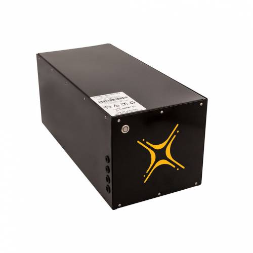

The SolarMD Battery includes an integrated Battery Management System (BMS) with each battery module and a LOGGER V2 that interfaces with the Victron Venus-device and supports multiple battery modules.

The following batteries are supported for the 48V systems:
| SolarMD BATTERY LV series type 51.2V |
| BATTERY SS4037 |
| BATTERY SS4074 |
| BATTERY SS202 |
