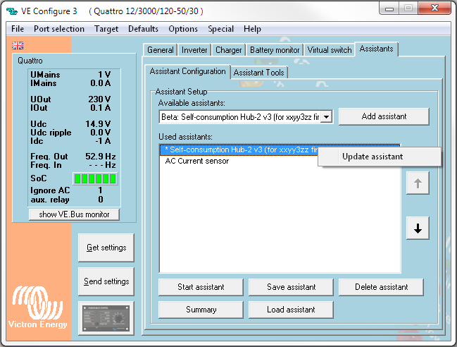

- In case there is an update for one or more of the configured Assistants, a warning will appear.
- All Assistants that can be updated will be marked with a star.
- Right click the assistant, and press update
- VEConfigure3 will guide you through all the pages in the Assistant: verify the values, the settings are the same as you have configured originally. Click next until finished.
- Click Send settings and include the Assistants. Note: the system will momentarily switch off!
