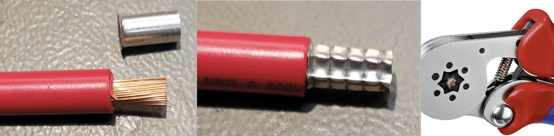

The use of ferrules is not required for cables from the above table. If an even thinner cable is used, a ferrule can help to bundle the loose wires. However, it is up to the installer to make sure that the cable is properly secured. The connecting cable, with or without a ferrule, should be adequately clamped to ensure low contact resistance.
Note: If you prefer using a ferrule, opt for a bootlace ferrule to ensure the strain relief grips the cable insulation as intended. A 16mm² cable with a ferrule will only fit if crimped hexagonally; a square crimp will not fit.
Hexagonally crimped bootlace ferrule
Preparation for correct mounting of fine-strand wires in the screw terminal block
Cut the cable straight with no loose or staggered threads. Using wire cutters will result in a straight cut.
Make sure no fine wires are cut when stripping the insulation.
Open the screw on the screw terminal block completely to prevent fine wires from getting caught behind the screw and bunching up. Pay particular attention to this when using the maximum wire diameter.
Tighten the screw with the correct torque; see Recommended torque and note the wire size and wire class. Never apply less than the recommended torque.
Hold the recommended torque for at least 5 seconds; this will give the screw time to settle to the set torque. This maximises the force on the wire, thereby maintaining a gas-tight contact pattern during heating and cooling cycles over time. Take the time to do it right. This is important. This is a UL486 test requirement and a requirement for all factory and field installations.

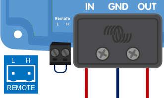

The remote on/off function switches the Orion XS on and off via the two-pole remote connector (L- and H-pin), without the need to interrupt the heavy DC cabling. It gives the versatility to choose from four wiring options, depending on what is available in the installation: a simple switch, a switched positive or negative signal already present in the system, or a BMS charge control contact.
The Orion XS is delivered with a wire loop (bridge) installed between the L- and H-pin. With the wire loop in place, the unit is always on. To switch the unit on and off remotely, remove the wire loop and use one of the options below. |

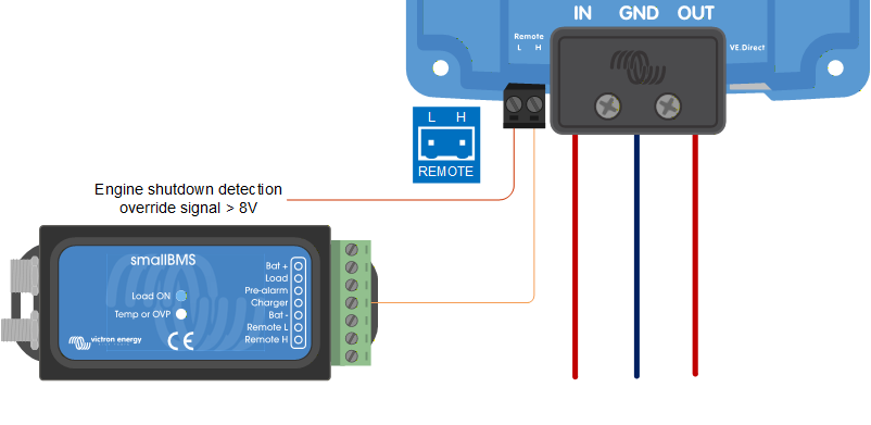

Wire the BMS ATC contact to the remote H-pin. | ![]() The Orion XS is controlled by the BMS ATC contact. |

An external engine running signal tells the Orion XS that the engine is running. See the Using an external engine running signal section for when such a signal is needed and which sources can provide one.
The signal is connected to the L-pin of the remote connector. Applying >8V to the L-pin overrides the engine shutdown detection and activates the charger, even when engine shutdown has been detected.

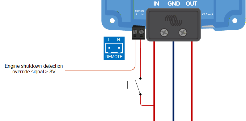

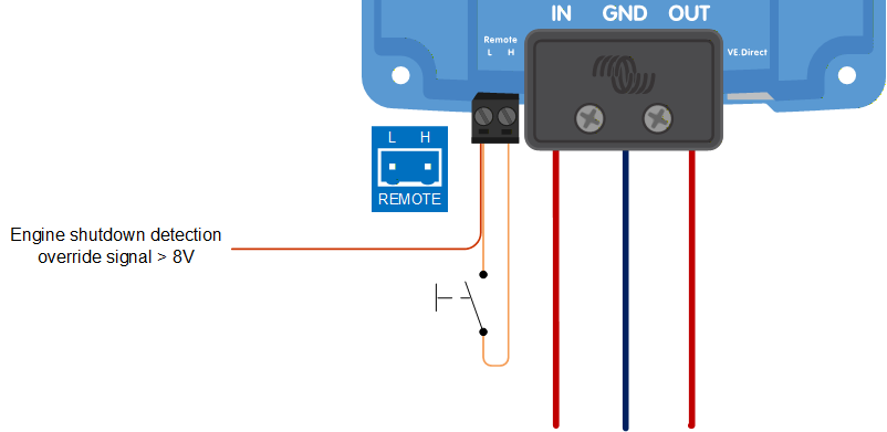

Wiring examples for the external signal with the various remote on/off options
External signal when remote on/off option a) is used | External signal when remote on/off option b) is used | ||
A switch between the L-H pins, or the wire loop fitted on delivery |
A switch wired between battery pos. and the H-pin |

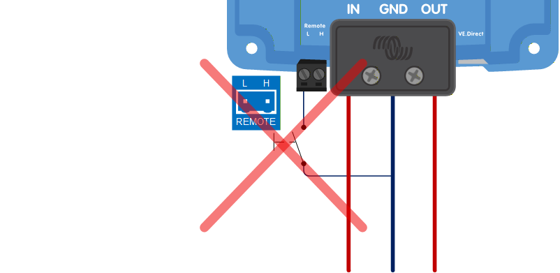

The L-pin is already connected to battery minus. Therefore connecting a positive signal to the same terminal is not allowed. | ![]() BMS ATC output controls the H-pin |
