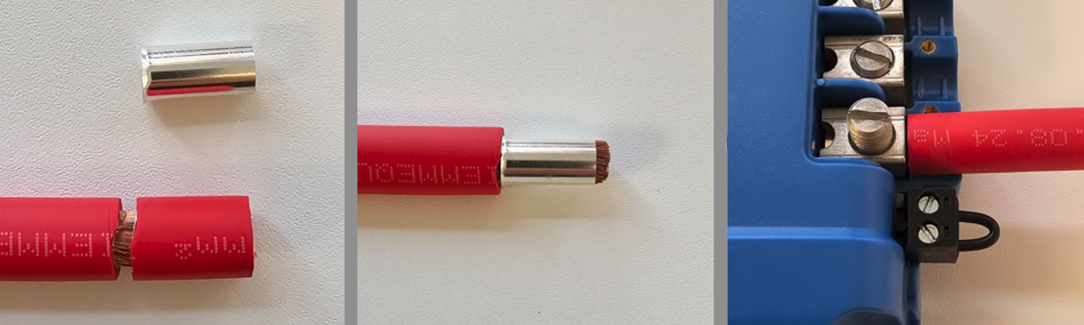

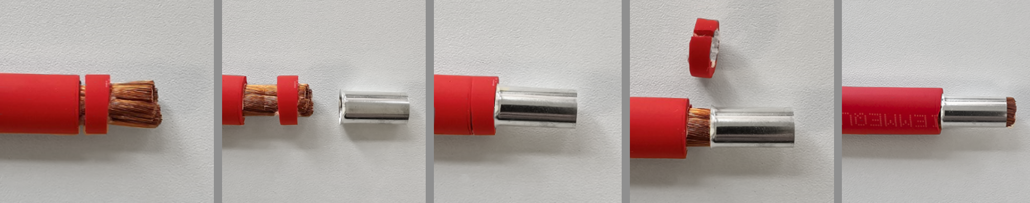

Tip
Tip for fitting a bootlace ferrule
Strip the insulation, leaving a narrow insulation ring attached to the conductor.
Slide the insulation ring to the stripped end to bundle the strands.
Fit the ferrule over the conductor while sliding the insulation ring back.
Remove the temporary insulation ring.
Position the ferrule fully onto the conductor.

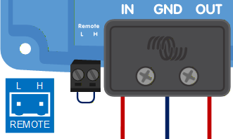

3.10. Connection setup for remote on/off
The remote on/off function switches the Orion XS on and off via the two-pole remote connector (L- and H-pin), without the need to interrupt the heavy DC cabling. It gives the versatility to choose from four wiring options, depending on what is available in the installation: a simple switch, a switched positive or negative signal already present in the system, or a BMS charge control contact.
The Orion XS is delivered with a wire loop (bridge) installed between the L- and H-pin. With the wire loop in place, the unit is always on. To switch the unit on and off remotely, remove the wire loop and use one of the options below. |
Note
Note the voltage tolerance between L- & H-pin: +/- 70VDC
a) A switch wired between the L-H pins | b) A switch wired between battery pos. and the H-pin |
![]() ON switch level impedance between L-H pins < 30kΩ | ![]() ON switch level > 4V |
c) A switch wired between the L-pin and ground | d) BMS control via the H-pin |
![]() ON switch level < 6V | ![]() BMS ATC output controls the H-pin |
The Orion XS is on when at least one of the following conditions is met: the L- and H-pin are interconnected, either by the wire loop or by a switch (option a), the H-pin is pulled high (options b and d) or the L-pin is pulled to battery minus (option c). If none of these conditions is met, the unit is off.

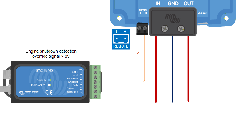

Wire the BMS ATC contact to the remote H-pin. | ![]() The Orion XS is controlled by the BMS ATC contact. |

3.12. External engine running signal wiring
An external engine running signal tells the Orion XS that the engine is running. See the Using an external engine running signal section for when such a signal is needed and which sources can provide one.
The signal is connected to the L-pin of the remote connector. Applying >8V to the L-pin overrides the engine shutdown detection and activates the charger, even when engine shutdown has been detected.
Notice
This function does not override or replace the remote on/off function. The Orion XS must be switched on via remote on/off for the signal to have effect. This can be the wire loop fitted on delivery, or one of the wiring options shown in section Connection setup for remote on/off.

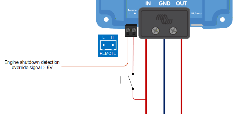

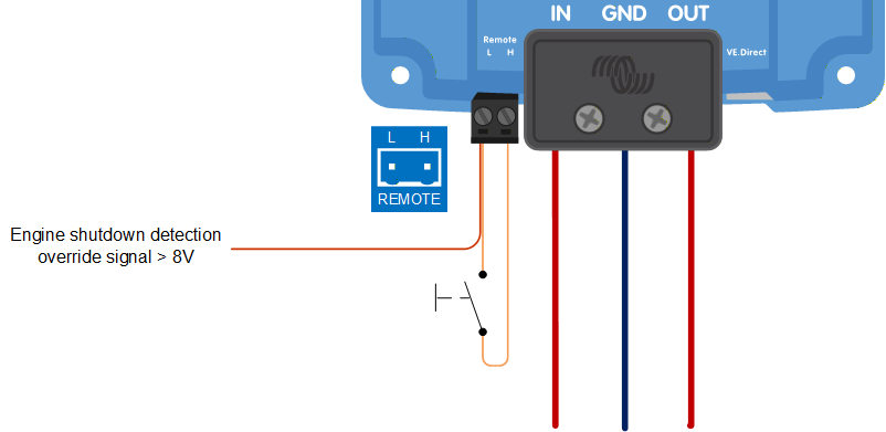

External signal when remote on/off option a) is used | External signal when remote on/off option b) is used | ||
A switch between the L-H pins, or the wire loop fitted on delivery |

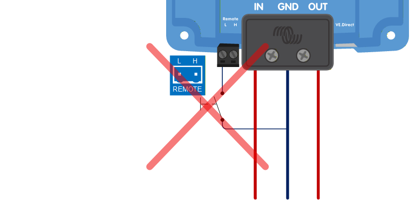

External signal when remote on/off option c) is used | External signal when remote on/off option d) is used | |
The L-pin is already connected to battery minus. Therefore connecting a positive signal to the same terminal is not allowed. | ![]() BMS ATC output controls the H-pin |
