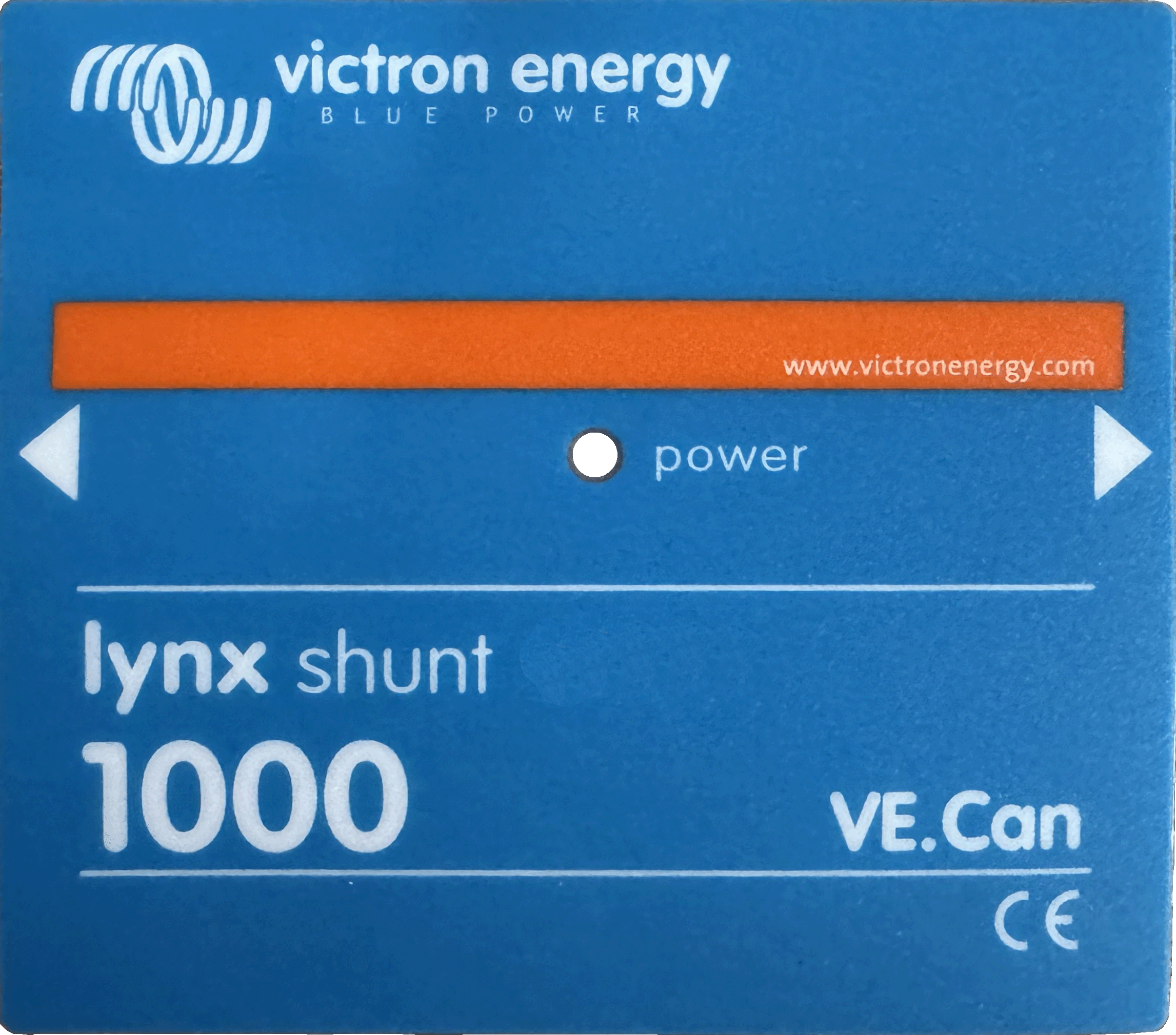

The Lynx Shunt VE.Can (M8) is an integral part of the Lynx Distribution system, featuring a positive and negative busbar, a battery monitor, and a fuse holder for the main system fuse. It is available in two versions: M8 and M10. The shunt can communicate with GX devices via VE.Can. Additionally, it is equipped with a power LED for status indication.
The Lynx Shunt VE.Can(M10) - with and without cover
The Lynx Shunt VE.Can (M8) - with and without cover

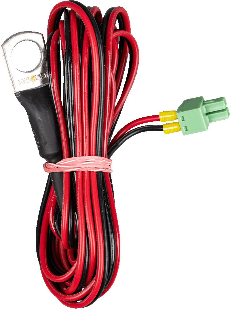

2.4. Temperature sensor
A temperature sensor can be connected to the Lynx Shunt VE.Can (M8). It is used to measure the battery temperature.
The temperature sensor is included with the Lynx Shunt VE.Can (M8). For more information see the Temperature sensor QUA PMP GX device product page.
