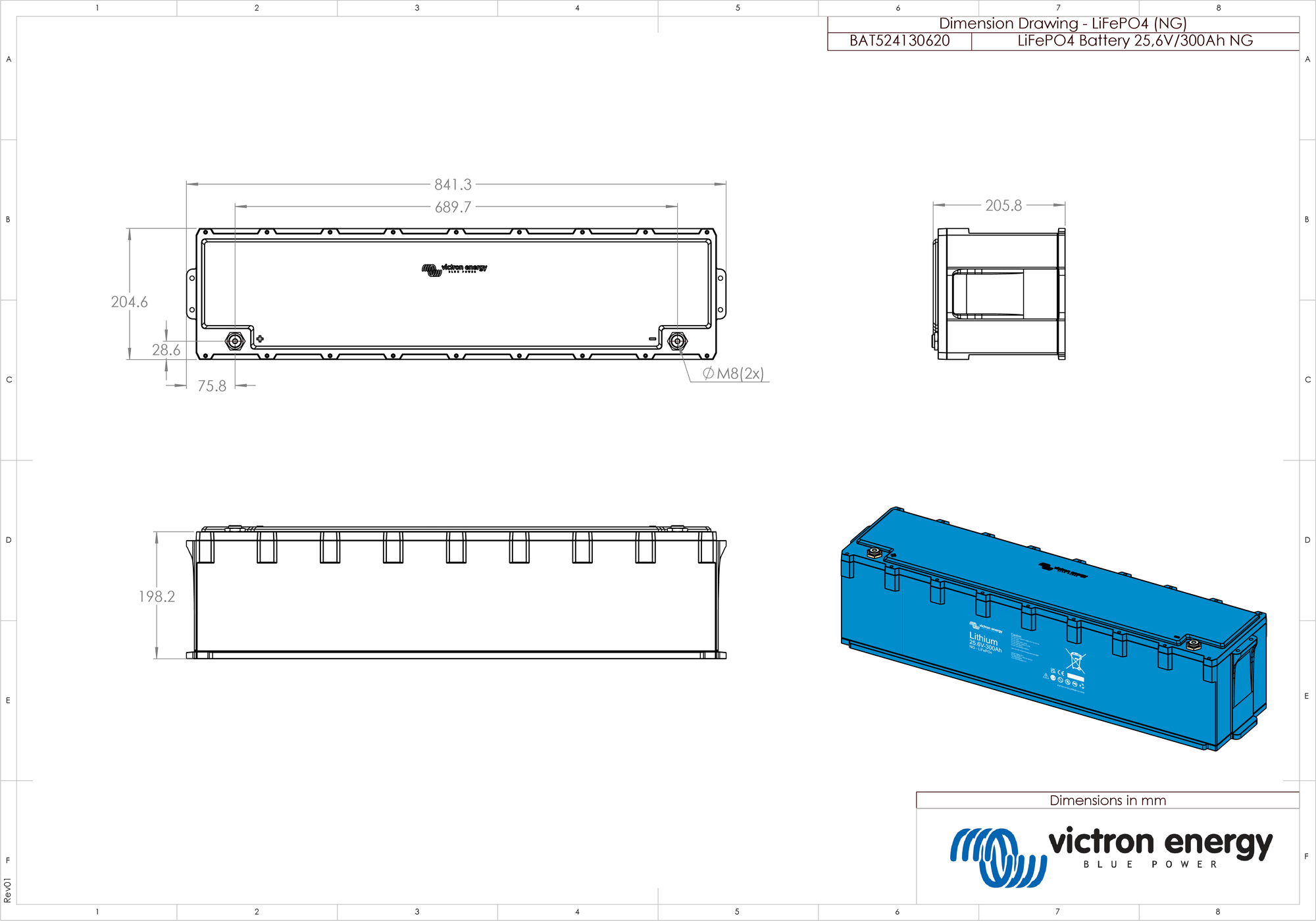

8.2. Misure carcassa
LiFePO4_Battery_12_8V200Ah_25_6V100Ah_NG__BAT512120620_BAT524110620_.pdf
LiFePO4_Battery_25_6V200Ah_51_2V100Ah_NG__BAT524120620_BAT548110620_.pdf
LiFePO4_Battery_25_6V_300Ah_NG.pdf
