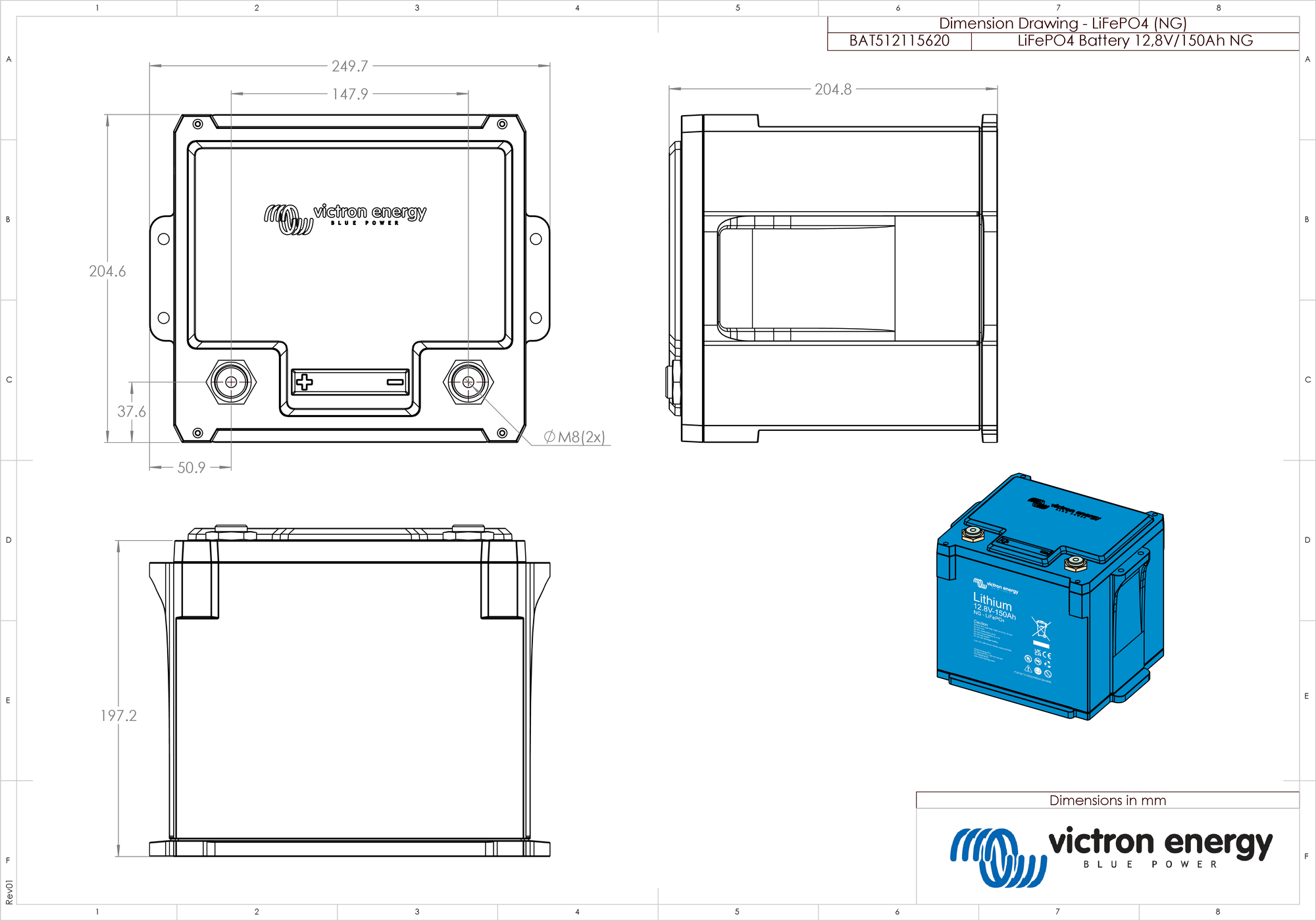

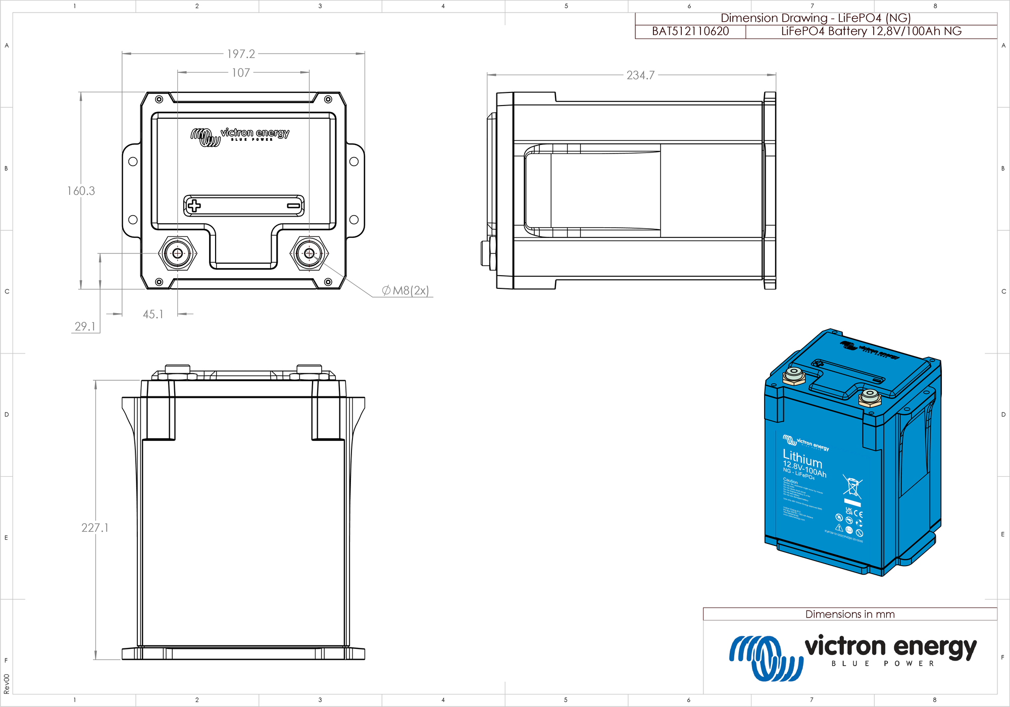

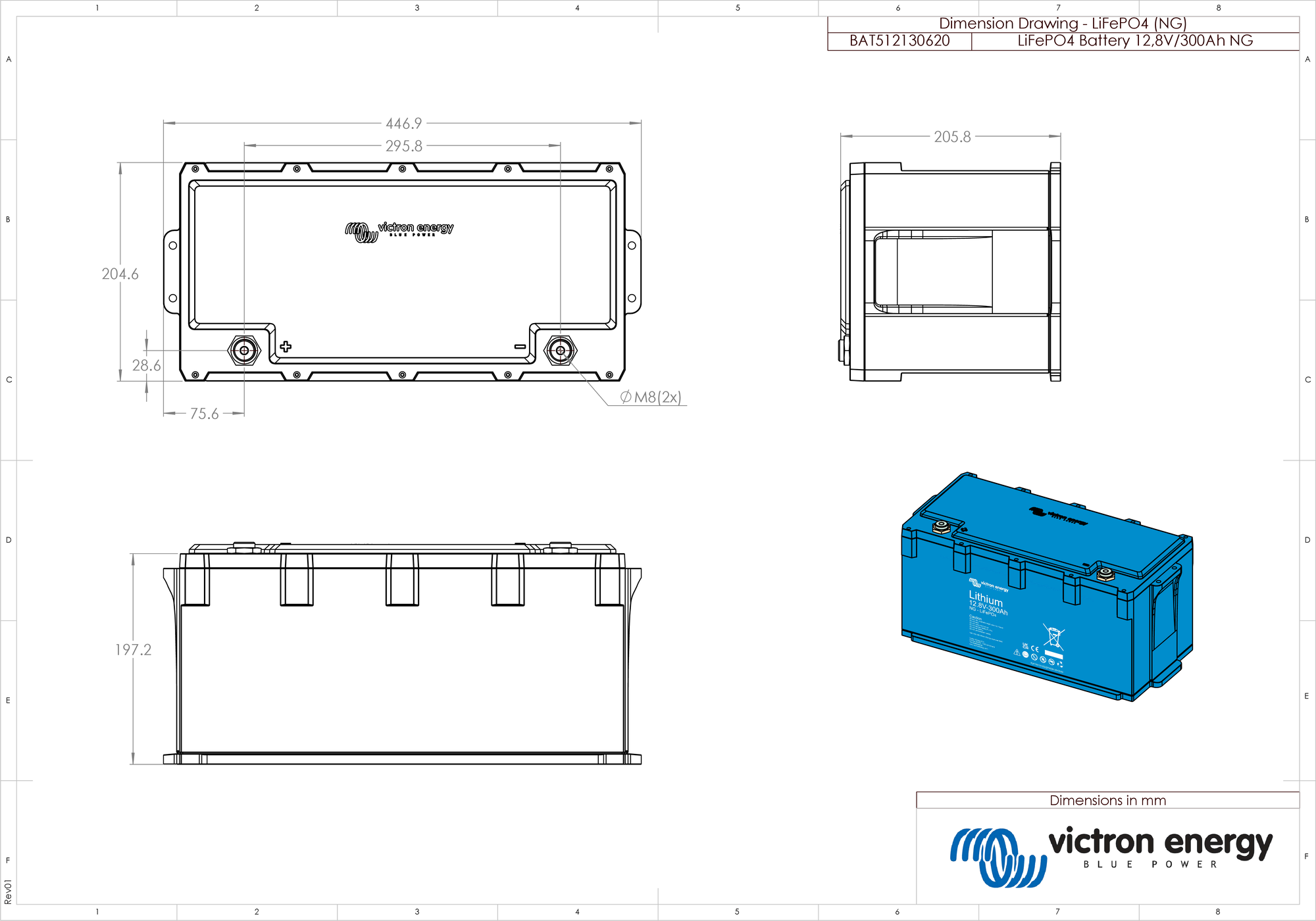

Afmetingen (h x b x d) (mm) | 235 x 197 x 160 | 205 x 250 x 205 | 235 x 341 x 160 | 206 x 447 x 205 |
Gewicht (gesch.) | 9 kg | 14 kg | 19 kg | 29 kg |

8.2. Afmetingen behuizing
