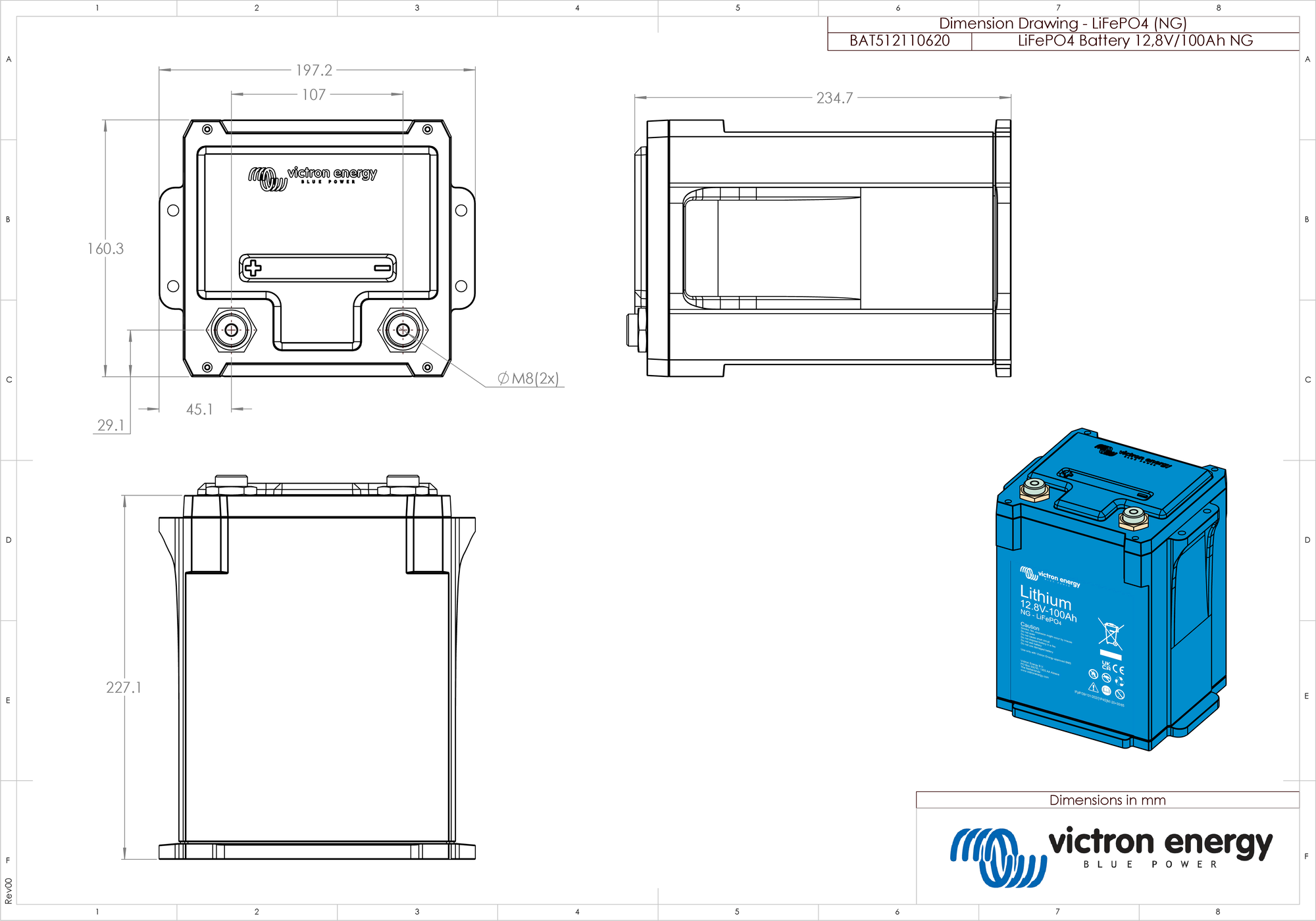

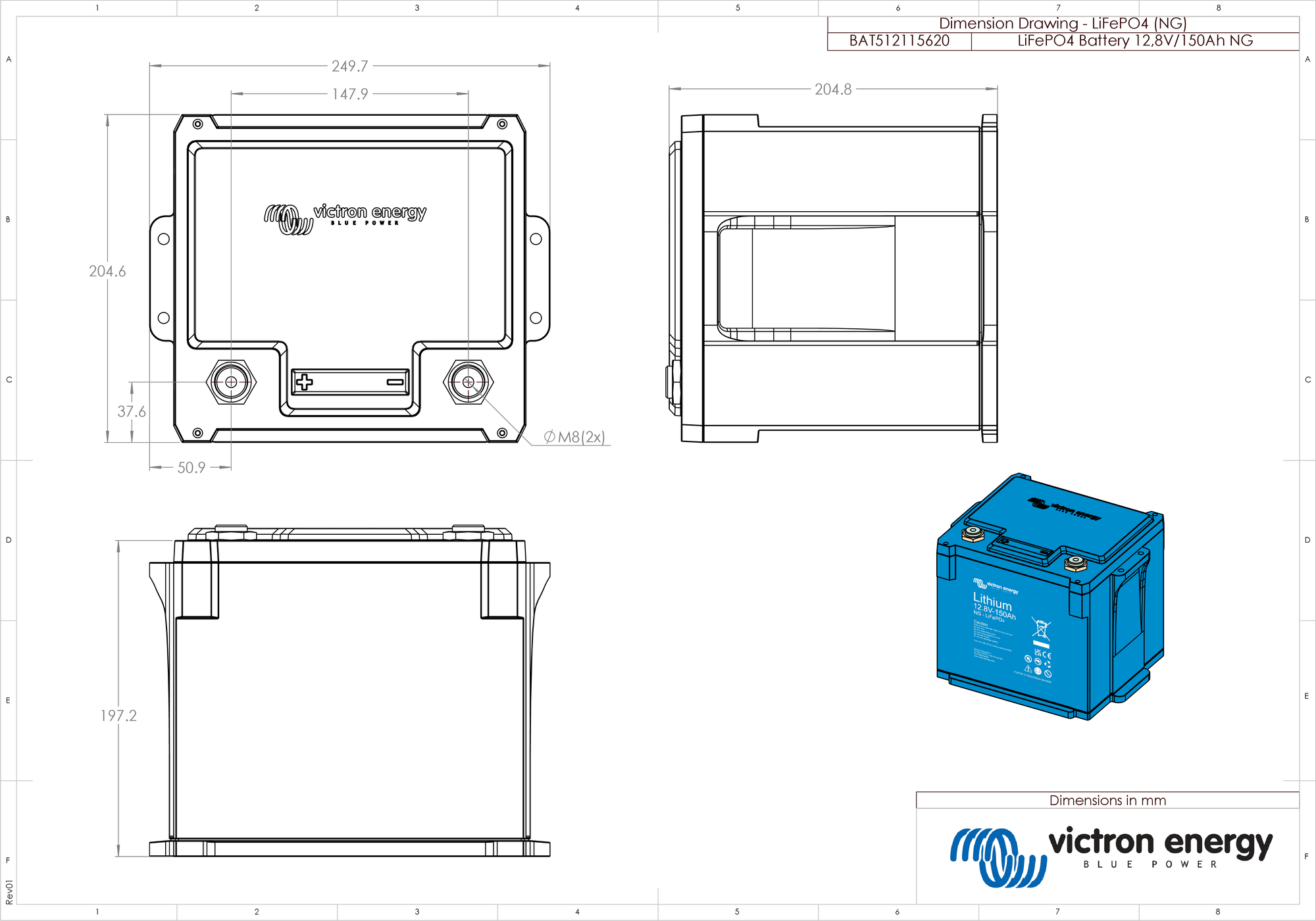

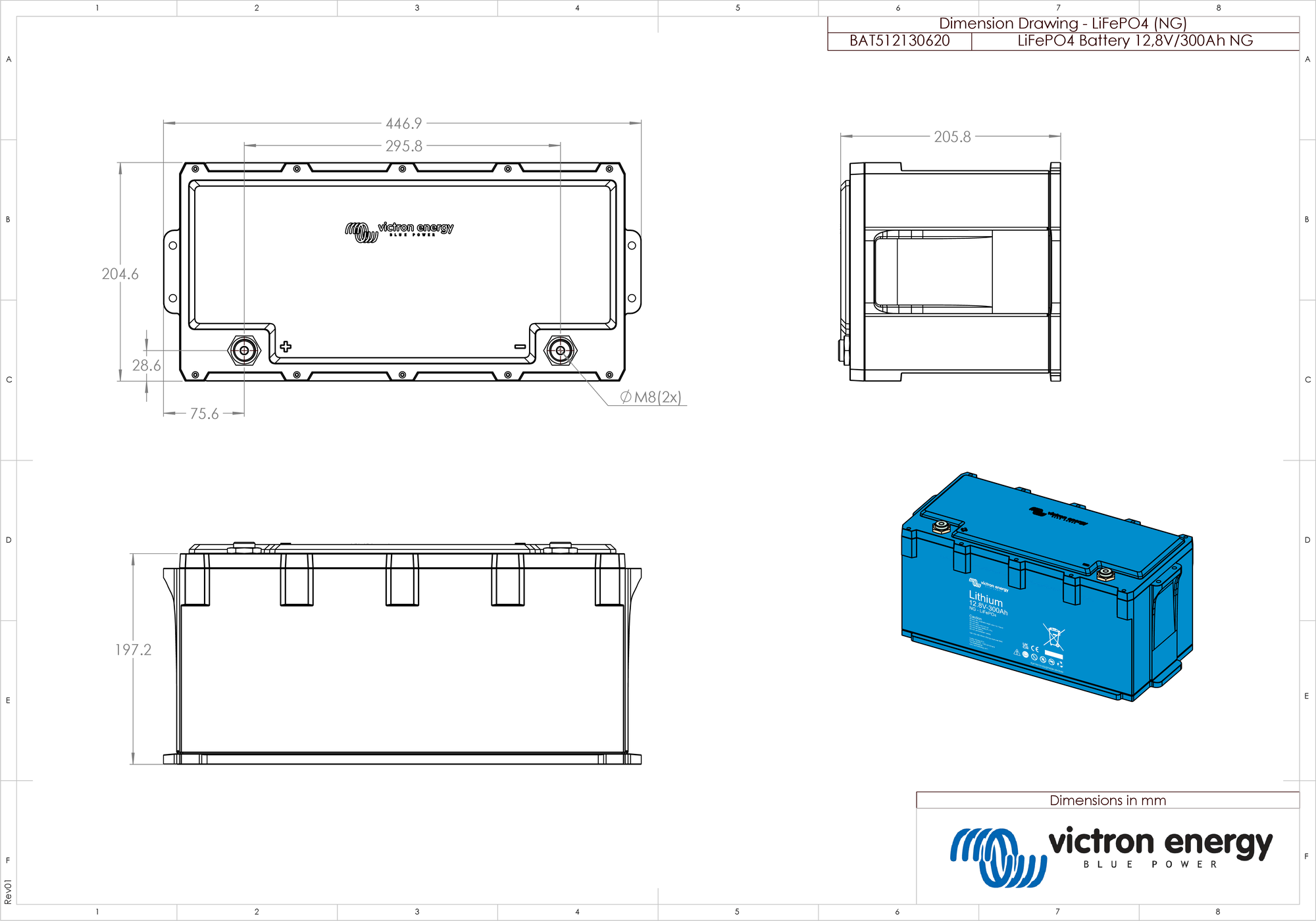

8.2. Misure carcassa
LiFePO4_Battery_12_8V100Ah_NG__BAT512110620_.pdf
LiFePO4_Battery_12_8V_150Ah_NG.pdf

LiFePO4_Battery_12_8V_300Ah_NG.pdf
