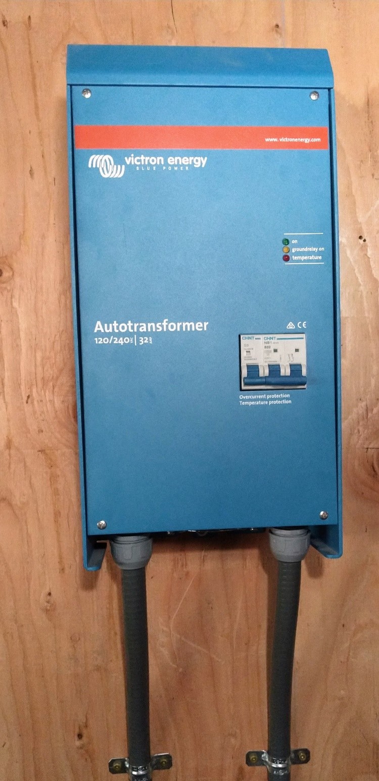

3.4. Conduit
Both models of the AT can be fitted with conduit if required. For both models remove supplied cable glands/strain relief and replace with 1-1/4” NPT (National Pipe Thread) conduit fittings. See illustration below.
