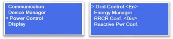

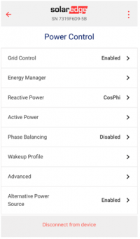

1. Enable frequency shifting
  • Go into Power Control
  • Ensure Grid control is Enabled
Inverters with LCD

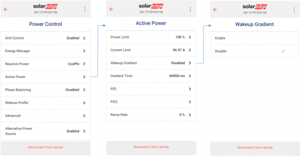

2. Disable Wakeup gradient
  • Power Control → Active Power control → Wakeup Gradient → Disable

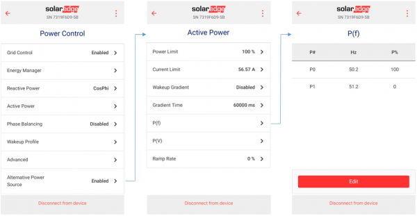

3. Set P(F)
  • Power Control → Active Power control → P(f)
  • Edit P0: 50.5Hz, 100% Power
  • and P1: 51.2Hz, 0% Power

1. Configure P(f) for APS
  • Power Control → Alternative Power Source → P(f)
