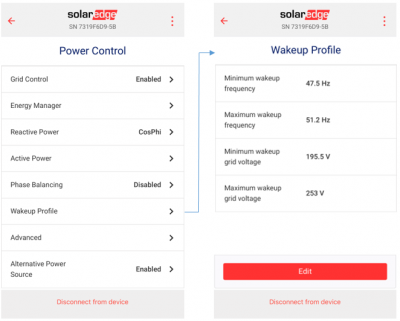

3. How to configure Frequency Shifting
Important note: Please ensure the SolarEdge inverter and your VE.Bus Config is set up for the same frequency bandwidth.
For systems that can feedback into the grid or for pure off-grid systems:
1. Enable frequency shifting
  • Go into Power Control
  • Ensure Grid control is Enabled
Inverters with LCD
2. Configure Wakeup Conf.
  • Power Control → Wakeup Profile → Edit
  • Edit Maximum Wake up Frequency = 51.2Hz
Inverters with LCD:
3. Disable Wakeup gradient
  • Power Control → Active Power control → Wakeup Gradient → Disable
  Inverters with LCD
  • Power Control → Active Power control → Wakeup Gradie → Disable
4. Set P(F)
  • Power Control → Active Power control → P(f)
  • Edit P0: 50.5Hz, 100% Power
  • and P1: 51.2Hz, 0% Power
Inverters with LCD
