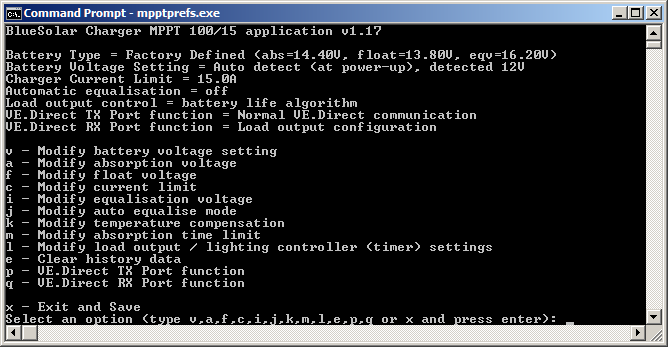

Interactive mode
- Start the mpptprefs.exe tool by double-clicking on it. The tool will try to locate the MPPT charger by scanning the available ports and downloading the settings once it finds a compatible charger. First you will see an overview of charger model, firmware version and the actual settings, similar to that shown below (MPPT 100/15 model used in this instance):
- When the settings are to your liking, make sure to press x and enter to save them to the connected charger.

The menu allows you to change the following settings
v - Modify battery voltage setting
Set the battery voltage to auto detection (0) or a fixed voltage (12, 24, 36, 48) to disable the auto detection.
Notes:
- 36 and 48 volts are only available on models that support these voltages, such as the MPPT 150/35. 36 volts cannot be detected automatically. For systems that require this voltage, it must always be set manually.
- Always fix the battery voltage when connecting the MPPT behind a Cyrix-Li-charge relay.
a - Modify absorption voltage
b - Enable/disable batterysafe mode
Switch on or off the batterysafe mode, please note that batterysafe mode has been removed as of version 1.13. If you connect a model with recent firmware, this option will no longer be shown.

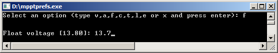

f - Modify float voltage

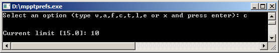

c - Modify current limit
Allows you to set a lower maximum charge current.
i - Modify equalisation voltage
Available from firmware 1.16 and higher.
j - Modify auto equalise mode
Set-up auto equalise mode, available options:
- 0 = off
- 1 = daily
- 2 = every other day
- 250 = every 250 days
When Automatic equalization is active, the absorption charge will be followed by a voltage limited constant current period. The current is limited to 8% of the bulk current for all VRLA (Gel or AGM) batteries and some flooded batteries, and to 25% of the bulk current for all tubular plate batteries. The bulk current is the rated charger current unless a lower maximum current setting has been chosen (option 'c'). In case of all VRLA batteries and some flooded batteries (algorithm number 0, 1, 2 or 3) automatic equalization ends when the voltage limit maxV has been reached, or after t = (absorption time)/8, whichever comes first. For all tubular plate batteries automatic equalization ends after t = (absorption time)/2.
k - Modify temperature compensation
Set-up temperature compensation. Allowed range -21mV/K .. 21mV/K, use value 0 to disable the temperature compensation (e.g. for Lithium batteries). Please note that the temperature compensation is not dynamic during operation. The charger uses its internal temperature for the battery temperature compensation when the charger has been idle for at least one hour, i.e. when the charger is not actively charging a battery or supplying a load.
m - Modify absorption time limit
Set-up the absorption time limit. Enter the time value in the notation hh:mm, where hh=hours (0..12), mm=minutes (00..59).
The maximum duration of the absorption period is determined by the battery voltage measured just before the solar charger starts up in the morning:
| Battery voltage Vb (@start-up) | Multiplier | Maximum absorption times |
| Vb < 11.9V | x 1 | 06:00 hours |
| 11.9V < Vb < 12.2V | x 2/3 | 04:00 hours |
| 12.2V < Vb < 12.6V | x 1/3 | 02:00 hours |
| Vb > 12.6V | x 1/6 | 01:00 hours |
t - Switch back to the factory defined battery table / rotary switch position
Modifying any of the charge parameters (a, b, f and c) automatically creates a user defined battery type. Use this option to switch back to the factory defined algorithm.
Note for models with a rotary switch: creating a user defined battery effectively disables the rotary switch. Use option 't' to enable the rotary switch again, and make the charge use the battery type as selected by the rotary switch position. Firmware version 1.15 has an improvement, changing the setting of the rotary switch will automatically enable it again.

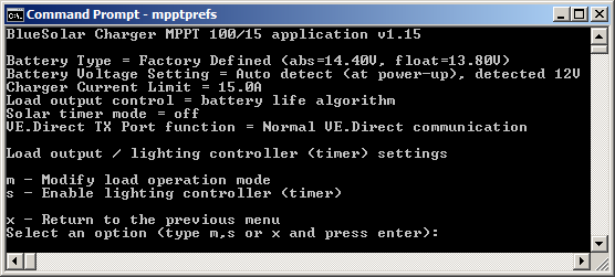

Load output and lighting controller
These options are only available on charger models with a load output. These are the MPPT 70/15, MPPT 75/10, MPPT 75/15 and MPPT 100/15. This option shows a sub-menu where the load operation mode can be changed (option m).
The lighting controller (timer) functionality is available from firmware version 1.15 and higher and the relevant options will only be shown when a charger with the correct firmware is detected. An MPPT 70/15 needs to be from year/week 1308 or later. Earlier 70/15s are not suitable for the lighting controller, upgrading MPPT firmware will not help. To find the year/week number, look for the serial number which is printed on a label on the back. For example number HQ1309DER4F means 2013, week 09.
l - Modify load output / lighting controller (timer) settings
m - Modify load operation mode
Change the load switch on/off behavior. By default the battery life algorithm will be used (option 1). Normally a jumper can be used to select between two fixed switch on/off set-points. However if you require communication with the charger (e.g. when connecting a Color Control) you can use options 2 or 3 to preset a conventional algorithm. Options 5 and 6 can be used to create custom algorithms, with programmable switch on and switch off levels (see options 'h' and 'l').
Keep in mind that modes 0 (always off) and 4 (always on) will respond immediately, the other modes rely on the battery voltage and have a delay of 2 minutes before the load output will change (so the charger does not respond too quickly when for example an inrush current briefly lowers the battery below the threshold voltage).
h - Modify load switch high voltage level (load operation modes 5 and 6)
Enter a custom load switch voltage level (high boundary).
l - Modify load switch low voltage level (load operation modes 5 and 6)
s - Enable/disable lighting controller (timer)
Switch on or off the lighting controller functionality. See option 'p' for details on how to set-up a timer program.

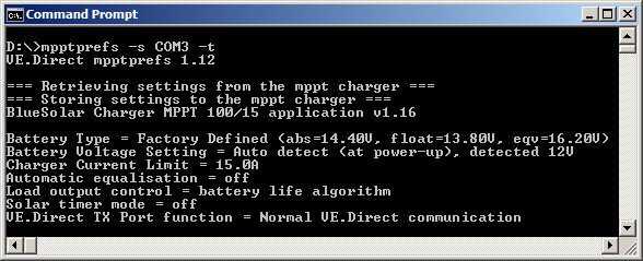

- In order to restore factory defined charge algorithm behaviour, issue the following command:
mpptprefs.exe -s COMx -t
This will reset the battery table to factory default algorithm.

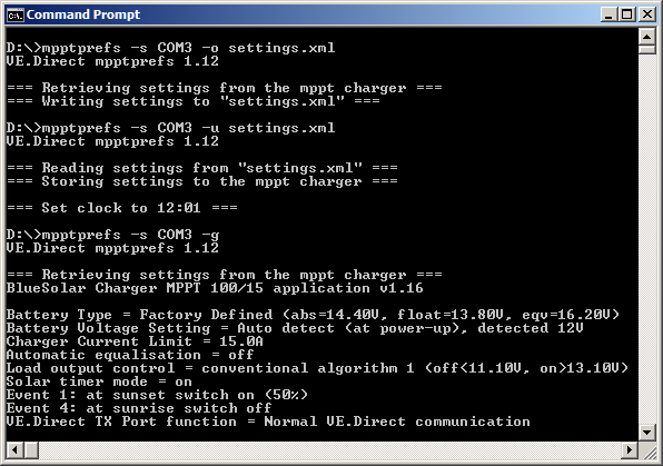

Use the following sequence for transferring settings to multiple units. This might be useful when the streetlight timer program needs to be distributed to a larger number of units.
mpptprefs -s COMx -o settings.xml
The above command outputs the entire configuration of a charger into a file.
mpptprefs -s COMx -u settings.xml
The above command uploads the settings from a file to a charger. This step can be repeated as often as needed.
mpptprefs -s COMx -g
The above command gets the charger configuration and dumps it the screen. This step can be used to verify if a charger contains the proper configuration settings.
The screenshot below shows the output of a settings transfer sequence.
