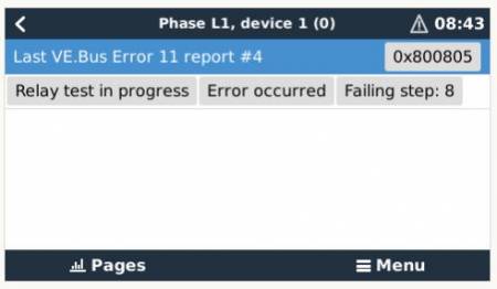

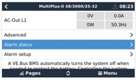

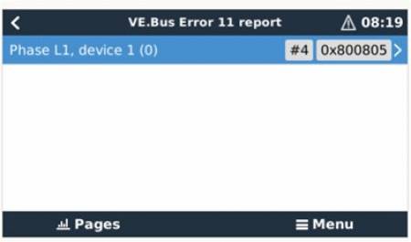

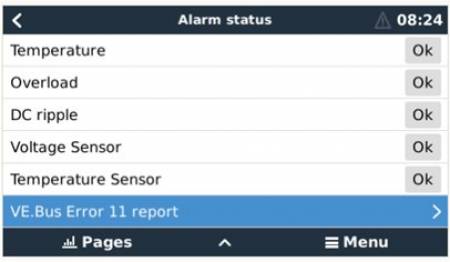

Detailed diagnosis of Error 11
After updating your VE.Bus inverter/charger to firmware 454 or higher; and running Venus OS v2.23~3 or later, a detailed VE.Bus Error report becomes available:
[TODO; add image here]
It shows:
  • A six digit number; which contains all the details
  • A counter
  • Flags
  • The failed step; it counts backwards: step 9 → 8 → 7 and so forth.
Common causes:
  • Failing step #8: check that line and neutral have not been swapped. Unlike non-grid code installations; line and neutral need to be wired correctly.
  • PE2 open error: check that AC-out Neutral is not wired to Ground. Short circuiting them is not allowed. Also, check that there is no leakage between Neutral and ground, for example because broken consumer. Start by disconnecting all loads: open all the circuit breakers.
In all other cases, contact your Victron representative for support. Please provide a photo of the error; and otherwise the 6 digit number at the top.
