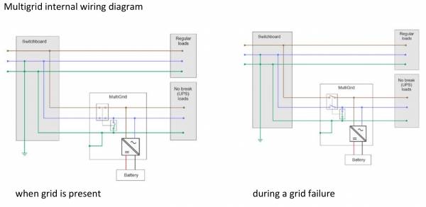

Error 11 - Relay Test Fault - Installation error or possibly relay failure (Multigrid only)
Occurs when the relay test of a Multigrid fails. The relays are automatically self-tested every time before the MultiGrid connects to mains.
Most likely the test fails due to an installation error:
- Please verify whether the incoming AC is a TN network.
- Line and Neutral should be connected to the corresponding L and N input on the Multigrid. A swapped connection results in VE.Bus Error 11
- There should be no external connection between N-out and GND!
Error 11 refers to a fault state where an internal relay check is performed to assess if there is a functioning neutral to earth link in the electrical system. If a neutral earth link is not found, the Multigrid will engage the relay and create this link.
There can only be 1 physical earth neutral link bond in each installation.
In the event of a detected grid outage, the Multigrid will disconnected (“island”) the active AND the neutral on the AC-Input to the inverter. This also serves to remove the earth-to-neutral connection, which needs to then be quickly re-created inside the Multigrid (by the relay) for the AC-Out. This is to maintain safety features on the electrical circuit such as residual current devices (RCDs).
It is important for the operation of this relay, that the neutral links on the AC input and AC output of the Multigrid remain isolated from each other.
If there is a connection detected between these two neutrals, it will trigger Error 11, and the unit will shut down until it is corrected.
If you are adding the Multigrid to existing wiring and intend to seperate the essential (AC-Out) and non-essential (AC-In) loads; It is recommended to disconnect all existing distribution board wiring for these and re-wire the board with them structurally separated and clearly labelled.
To be clear, that is two separated, neutral buses. One for the mains grid supply and one for the AC-Out 'Essential Loads' that will remain on during a grid outage.
It will only take one instance of a load circuit with the active connected to the AC-out, while the neutral is connected to the AC-in neutral bus (or vice versa) to lead to error 11 issues.
Furthermore, future circuit additions by electricians who are unfamiliar with the separated neutral links could lead to issues arising with an otherwise functioning installed system, and make this fault very difficult to troubleshoot.
If you are not separating the loads into Essential and Non-essential, and all loads will be connected to the AC-Out of the Multigrid, then you will STILL have 2 seperate neutrals. However the ONLY load on the Main Grid Supply neutral will be the Multigrid AC-Input.
This will still cause the physical earth-to-neutral link on the input to be broken during an outage, and the new earth-to-neutral link to be made by the internal Multigrid relay.
You will need to run two seperate Active and two seperate Neutral wires to the Multigrid, one for the AC-In and one for the AC-out. They will share the same common earth.
If the failure is not triggered by one of the above conditions a hardware failure might be the cause, contact your Victron dealer.
