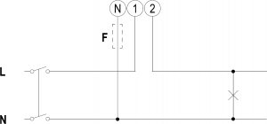

2. AC Wiring
The diagram shows the wiring when used as a grid meter.
