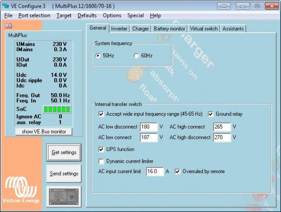

VE.Configure Settings
For the system to work correctly some default settings need to be changed using the program VE.Configure.
This can be dowloaded from our website. On our website there is also documentation avaiable that explains how VE.Configure should be used.
Settings
Only a few settings need to be changed. See the list below. Some screenshots are displayed to help you if you are a first time user.
- Disable overrule by remote → General tab

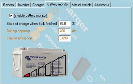

- Enable battery monitor and set correct Battery capacity → Battery monitor tab

Battery monitor tab and Inverter tab
