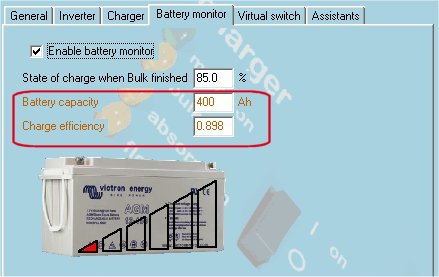

Software configuration
For the system to work correctly some default settings need to be changed using the program VEConfigure3. This can be dowloaded from our website. On our website there is also documentation avaiable that explains how VEConfigure should be used.
To connect the Multi to a PC or laptop a MK2-USB interface is needed.
For more information: MK2-USB interface
Settings
Only a few settings need to be changed. See the list below. Some screenshots are displayed to help you if you are a first time user.
- Disable overrule by remote → General tab
- Change DC input low shutdown to 10.8 volts → Inverter tab
- Change DC input low restart to 11.8 volts → Inverter tab
- Change DC input low pre-alarm to 11.8 volts → Inverter tab
- Charge current can be left at standard setting → Charger tab
- Enable battery monitor and set correct Battery capacity → Battery monitor tab (only needed with ColorControl GX option.

Battery monitor tab and Inverter tab
