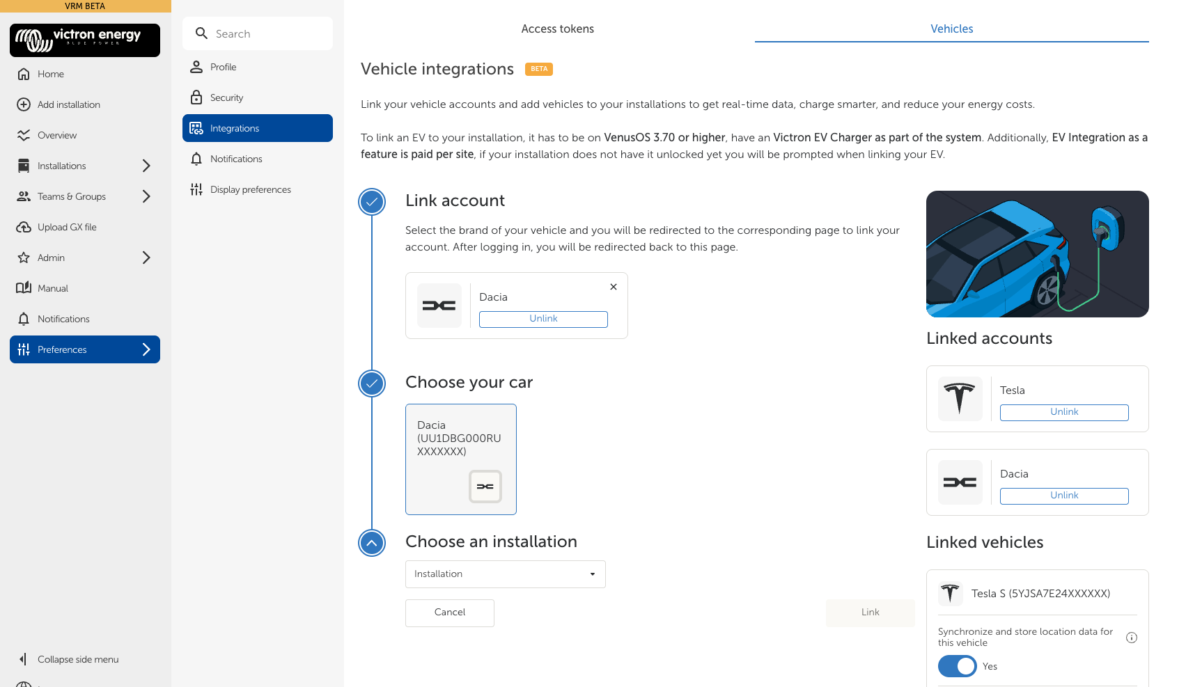

Vehicle integrations are available in the Preferences > Integrations menu, under the Vehicles tab.
FAQ
Missing a question? Please ask them in the community forum with a remark that it should be added to the documentation and/or FAQ.
Q: What are the requirements to use this feature?
To link an EV to your installation, it has to be on Venus OS 3.70 or higher, have an Victron EV Charger (EVCS) as part of the system. Additionally, EV Integration as a feature is paid per site. If your installation does not have it unlocked yet you will be prompted to purchase it when linking your EV.
Q: Which vehicles are supported?
We currently support Tesla, Volvo and all the brands supported by Enode according to capabilities described here: https://developers.enode.com/brands
