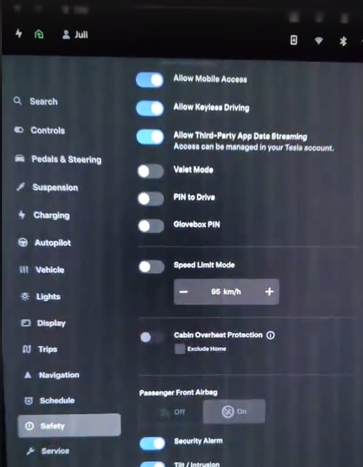

Q: How to connect a Tesla without Virtual Keys support?
Tesla Model S and Model X Intel Atom Vehicles
These vehicles do not require a Virtual Key; instead, a user with access to the vehicle must enable “Allow Third-Party App Data Streaming” in the Safety screen of the vehicle.
