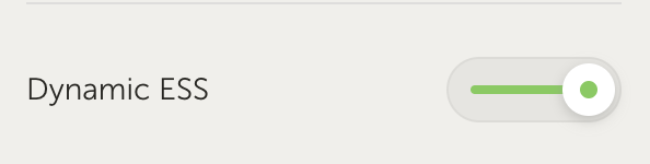

Now navigate to the installation’s Dashboard and click the button shown below to open the Controls menu. Under the ESS section, you will find Dynamic ESS controls.
What's next? | After configuration
As the configuration flow points out, you can navigate to the Installation Controls → ESS settings to see the running state of Dynamic ESS. The switch is green when Dynamic ESS is on and red when it is switched off.
The Auto (green) mode is the usual mode in which Dynamic ESS should operate. If you want to disable Dynamic ESS, toggle the switch to Off (red).
The state of Dynamic ESS will also show on the dashboard, just after the title. As a side note: If you run the Node-RED implementation of Dynamic ESS, here it will show “Node-RED”.

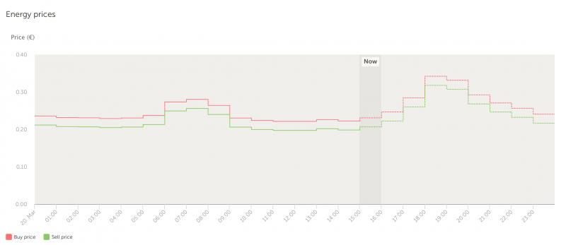

The prices graph is available on both this tab and the Energy tab. It shows the buy and sell prices per hour.
The usage graph shows the energy usage of the grid and of the battery in kWh.

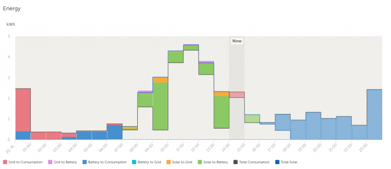

Energy
The prices and graph is the same one as on the Schedule tab. It shows the buy and sell prices per hour.
Then there is the energy graph, which summaries everything the system has done and is planning for.

Q: Does the system work in the UK (or any other non-EU country)?
If your provider has “fixed” tariffs which are steady, but differ on hourly intervals, then yes. You can set the system to use a fixed contract. If your provider has hourly changing tariffs that are not covered by the ENTSO-E API, then you are out of luck for now. But if there is a public API and you let us know where we can fetch the information, we will gladly add it.

Q: My providers changes price at the half hour instead of the full hour
Some (UK) providers offer fixed prices that change on the half hour instead of at the full hour. Unfortunately the 30 minute interval has some more implications than just allowing it to be entered into the fields.
The calculations and forecasts are currently done on the whole hour, so that needs to be accounted for as well. And the same goes for the graphs. All not impossible to solve, but not trivial either and needs a fair bit of testing.
So the 30 minute interval will be added eventually, but it will take some more time.
Q: Why does (dis)charging slow down or speed up towards the end of the hour?
The system calculates every few minutes how quickly it should (dis)charge to reach the target SOC at the end of the hour. If it falls behind (because your load is higher), it will speed up a bit, if it gets there too fast, it will slow down. If the battery capacity is overestimated, it will typically slow down towards the end. If the battery capacity is underestimated, it will typically speed up towards the end.
In addition, battery manufacturers are not always exact in the advertised battery capacity. You may have to tweak it a bit.

Q: The energy graph is showing incorrect data
Sometimes the graph shows that energy was taken from the grid. When looking at the installation data graphs, it shows that the energy actually came from PV yield. This is caused by a known misleading assumption with the Energy graph: It assumes if there is more production than consumption, all consumption is met by production and the other way around: if there is more consumption than production, then all the production goes to consumption.
This is quite an assumption but this is how DESS considers it internally, so that’s why the visuals reflect it that way. If we do not have that assumption, the energy graph would be even more complicated. If you want to know the exact source of the energy, you should look at the installation data graphs (grid, solar and consumption).
