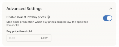

New: Disable solar at low buy prices
Energy prices sometimes drop very low; they can even go negative. At those moments your own solar power can actually cost you money: exporting the surplus is charged instead of paid, and buying from the grid is cheaper than using your own production. Dynamic ESS can now handle this for you. Open Advanced Settings and switch on Disable solar at low buy prices, then set your threshold. Whenever the buy price drops below it, solar production is paused automatically, and it resumes as soon as the price recovers. No need to keep an eye on the prices yourself.
Note: Disabling solar production works with these systems: HS19, Multi RS, MultiPlus, MPPTs, PV inverters that support the SunSpec protocol and limiting.

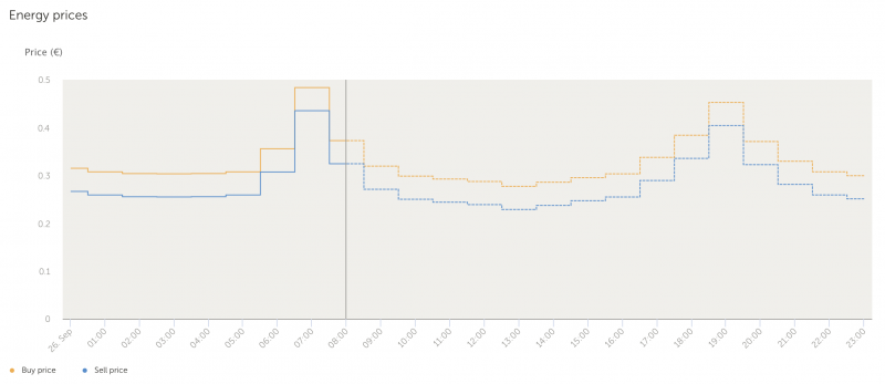

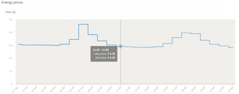

Steps 3 & 4: Buying and Selling Prices
For energy transactions, you can use either dynamic (day-ahead) prices or fixed prices that may vary by time of day or between weekdays and weekends. Indicate whether you're using fixed or dynamic pricing. You can find these rates in your energy contract.
For the UK, Spain and France, Dynamic ESS provides an out of the box connection with your energy provider. Refer to the list below to see if that applies to you.
Your Dynamic Price Formula Made Easy
Getting your dynamic pricing formula is important, but it might not be easy to find in your energy contract. Let’s break it down with an example:
When you sell energy back to the grid, you get the base rate from your energy provider. But when you buy energy, you also pay VAT and an extra charge of 11 cents per kWh.
Selling Energy: Your selling formula is just: P
Buying Energy: Your buying formula is: P * 1.21 + 0.11
If you’re not sure about your rates, start with a simple P for the price. You can compare the numbers in VRM with those in your energy provider's app to check if they match.

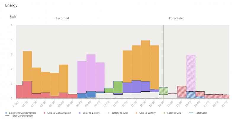

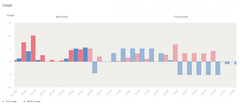

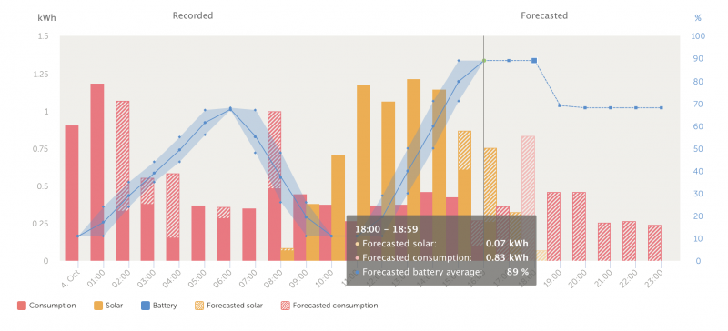

Tracking your daily energy schedule
Once you've configured Dynamic ESS, a new section will appear at the bottom of your VRM dashboard. This section displays a graph showing today's energy prices alongside the Dynamic ESS plan. Starting from around 3 PM each day, you'll also be able to view the prices and the plan for the following day. Dynamic ESS will be on by default. In the controls panel, you’ll be able to enable and disable Dynamic ESS. Note that Dynamic ESS saves most money when left on for extended periods of time.
