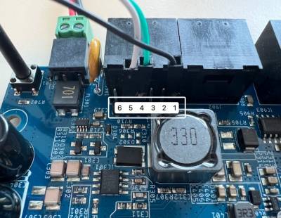

7. Connecting on the serial console
The serial console offers a straight connection from your computer. Not relying on TCP or anything else.
Its an alternative to connecting to the commandline over ssh.
Connecting to the serial console requires a USB interface, ie a USB to serial cable with proper pin-out. For example this one: https://www.adafruit.com/product/954.
The serial consoles on all GX devices are configured to 115200 baud.

7.6 Ekrano GX
Getting to console on the Ekrano GX is not that easy. The pins are located between the network and USB connector on the back of the device.
  1. Black: ground
  2. NC
  3. NC
  4. Green: RX of the Ekrano GX - connect to TX on your cable
  5. White: TX of the Ekrano GX - connect to RX on your cable
  6. NC
