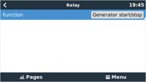

Enabling the start/stop function
Go to: Setttings → Relay and set the Function options to “Generator start/stop”
Relay
Now that has been enabled, all the settings pertaining to the Automatic Generator Start/Stop function will be found in the main Menu under: Settings → Generator start and stop.

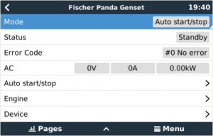

Fischer Panda
- Enable the “AutoStart” function in the Fischer Panda generator control panel.
- Go to the Fischer Panda genset page and set the Mode setting to “Auto start/stop”
Once the Mode is set, all settings will become available under the Auto start/stop menu entry at the bottom of the page.

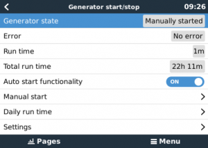

Main page
- Generator state: Condition that is currently keeping the generator running.
- Error: Error description.
- Runtime: Generator runtime since last start.
- Total run time: Accumulated running time since the first start.
- Time to next test run: When the test run condition is enabled this item shows the time remaining to the next test run.
- Daily runtime: Page with the running times of last 30 days.
- Settings: Generator start and stop settings menu.

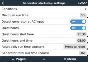

Settings
- Conditions: See Conditions
- Minimum runtime: Once started the generator should run for a minimum amount of time, for manual start this setting is ignored.
- Detect generator at AC input: After starting the generator, it monitors the Multi (or Quattro), to see if it connects to the generator. In case it does not it will cause an alarm. This function catches a wide array of possible problems, like a simple no fuel situation, but also a tripped fuse or other problem between the generator and the Quattro. This functionality is not available for VE.Can connected Multi/Quattro.
- Quiet hours: See Quiet hours
- Reset daily run time counters: Reset the last 30 days run time counters.
- Generator total run time: Sets the total run time counter.

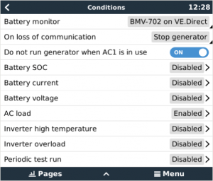

Conditions
Conditions location: Generator start and stop → Settings → Conditions
* Battery monitor: Select which battery monitor will be used for DC related conditions.
* On loss of communication: Defines the behavior when the datalink between the CCGX/Venus GX and the selected battery monitor and/or vebus inverter/charger is lost. Options are:
- Stop the generator: If the generator is running and the datalink is lost, the generator will be stopped. (default)
- Start the generator: If the datalink is lost and one or more conditions depends on it the generator will be started.
- Keep running: If the generator was already running before the datalink loss this setting will keep it running, but will not start it if was not running previously.
* Do not run genset when AC 1 is in use: It is intended for backup systems, with a Quattro, having mains on AC in 1, and Genset on AC in 2. When this option is enabled, the Genset will only be started after a mains failure. And in case of a mains failure, the Genset will automatically be stopped again as soon as the mains is restored. This functionality is not available for VE.Can connected Quattros.
The following conditions are available to auto start/stop a generator:
- Manual
- State of charge (SOC)
- AC load*
- Battery current
- Battery voltage
- Inverter high temperature
- Inverter overload
- Periodic test run
* The measured value is the system total AC consumption.
Conditions are evaluated in the order shown above and when multiple conditions are reached only the top one will be shown as active condition. All enabled conditions are evaluated even if the generator is already started so when the active conditions ends, the next reached condition will keep the generator running.

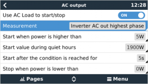

AC load condition

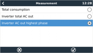

AC load condition works like the rest of conditions but has the “Measurement” extra setting.
The “Measurement” setting is available on firmware v2.0 and onwards and has three possible values:
- Total consumption (Default option)
- Inverter total AC out
- Inverter AC out highest phase

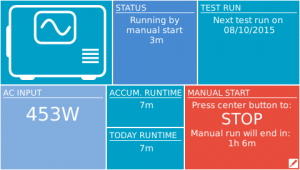

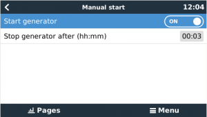

There are two ways to start the generator manually:
- Using menu: Go to Generator start and stop → Manual start and use the switch to start the generator.

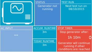

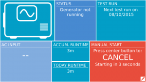

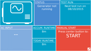

- Using generator page: Press the top-left button to show the generator page. Once in the generator page press the center button, when pressed you will be asked how to stop the generator, manually or using a timer. Once selected the stop mode a countdown of five seconds will start, you can abort the manual start by pressing the center button.
WARNING: If the generator is manually started without a stop timer, won't stop until the user set to off the manual start option.
In both options the use of a stop timer is available, use the timer to program the generator stop.
Manually stop the generator is only possible if no other condition is active. In the case that you want to force the stop you should disable the active condition or disable the generator start and stop function.

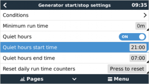

Quiet hours
Quiet hours allows you to set a time zone for nighttime with values that make the generator start only when is really necessary.
When the “Quiet hours” mode is active, the conditions will use the related start/stop values.
To enable it go to the settings menu and set the “Enable quiet hours” switch on. Once enabled start and end time settings will become visible.
You can make the “Quiet hours” mode to be permanently active(when enabled) setting both start and stop time to the same value.
