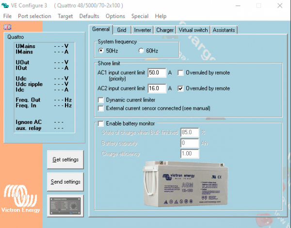

The GX-device must be configured to use the battery monitor provided by the Freedom Won battery and disabling the MultiPlus or Quattro battery monitor ensures that the correct battery monitor is used:
☛ Disable Battery Monitor (the VE.Bus battery monitor is not required with a CAN Bus Lithium battery)
NOTE: It appears that the final step in this process, enabling ESS, turns the battery monitor back on. Please check the General tab on more time once you've complete the process before you save the configuration or upload it.

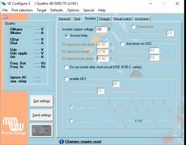

☛ Set the Low Shut-Down, Low Restart, and Low Pre-alarm voltages. The Low Pre-alarm only activates the low battery LED on the inverter and serves no other purpose in this setup. The Low Shut Down and Low Restart voltage settings are usually overridden by the commands from the Lite but offer redundancy in instances of loss of communication and therefore should still be set correctly.
  • Low Shut-Down: 47.00
  • Low Restart : 52.50
  • Low Pre-alarm: 51.50

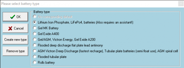

☛ Charger Settings Tab: Set Battery Type as “Lithium Iron Phosphate, LiFePo4 batteries”.

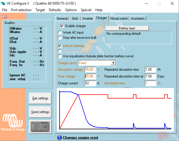

☛ Set Charger Settings. The charge voltage values are overridden by the Lite but should be set correctly regardless for redundancy. The charge current should be set according to the user’s requirements but this value combined with all other charge sources cannot exceed the charge limit of the battery – it is possible to select “Limit Charge Current” on the GX-device as an additional measure to prevent the total system charge current from exceeding the charge capacity of the Lite.
Note: only adjust these values after selecting Lithium battery as the defaults entered by VE.Configure when selecting the Lithium battery type are not suitable to Freedom Won batteries.
  • ✔️ Lithium batteries
  • Absorption voltage: 55.80 V
  • Float voltage : 55.80 V
  • Absorption time : 1 Hr

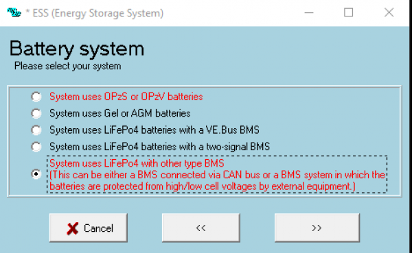

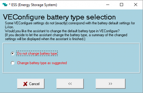

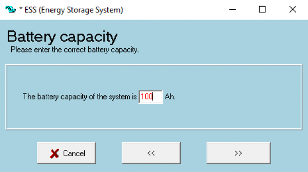

☛ When setting up the ESS Assistant select LiFePO4 battery and enter the Ah value for the Lite (or the combination of Lite’s for a parallel battery system) as per the Ah rating provided in the Lite specification sheet eg. Lite 5/4 = 100Ah.
☛Select – Do not change battery type

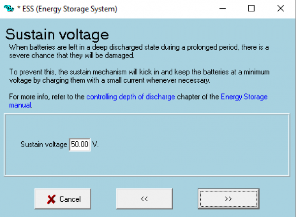

☛Sustain Voltage = 50V

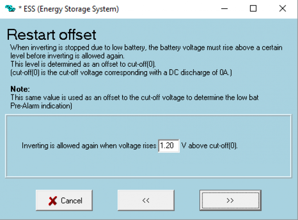

☛Restart Offset = 1,2V
☛Go back to General and disable battery monitor again.

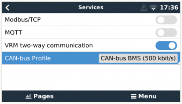

☛Settings → Services → CAN-bus Profile → CAN-bus BMS (500kbit/s)
Note: For systems with VE Can MPPT’s, select 250kbit/s and ensure Lite profile is also set for 250kbit/s (check with Freedom Won or your Freedom Won distributor).

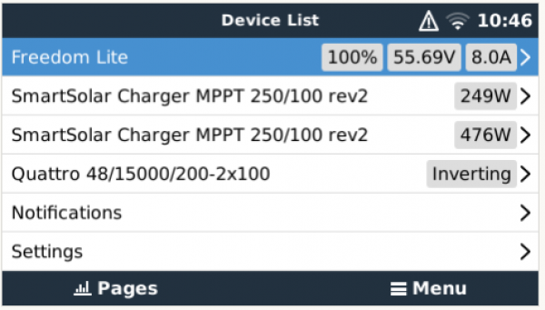

☛Confirm that the Freedom Lite is showing in the device list as per below

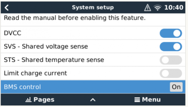

☛Settings → System Setup → Switch on DVCC and SVS, check that BMS Control is “On”
