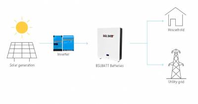

Offgrid, Backup and Energy Storage Systems (ESS)
Victron + BSLBATT can be used for the following system types:
  • Energy Storage Systems - Self Consumption (ESS - Start page)
  • Grid Backup
  • Off-grid
