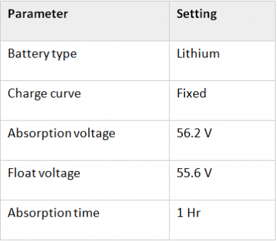

4. VEConfigure settings
4.1 Charge parameters
