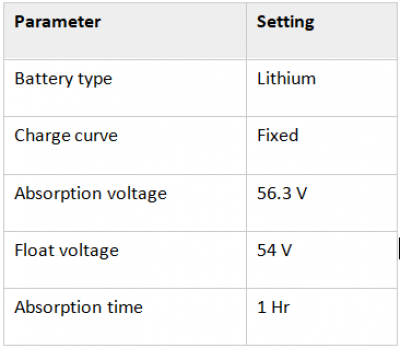

4.1 Charge parameters
4.2 ESS Assistant
Select the fourth battery type:

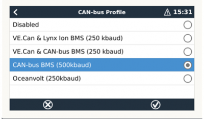

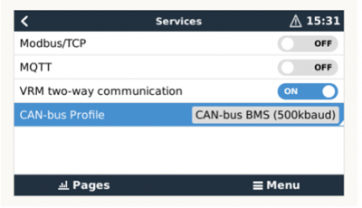

5. Color Control GX Configuration Enable the CAN-bus BMS Service in th}}e CCGX. Menu path: Settings → Services → CAN-bus BMS. Note that this changes the function of a VE.Can port: it is not possible to connect both VE.Can products and a Bluenova battery together.
