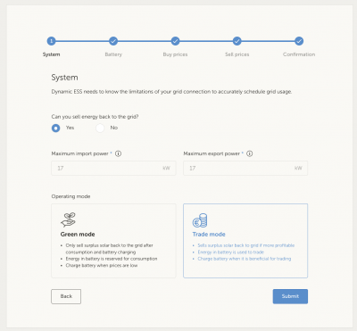

Step 1: System
First, confirm whether you can sell excess electricity back to the grid. If so, you'll be asked to provide details on the power limits for selling. The limit will be the lower value between your grid connection capacity and what your system can handle. For example, if your grid connection supports 17 kW but your system can only handle 10 kW, enter 10 kW.
Note: This step defines the system's potential capabilities, not the actual operational limits you'll set later.
Operating mode: choose Green mode or Trade mode — the two modes are described above. You can always switch between them later.

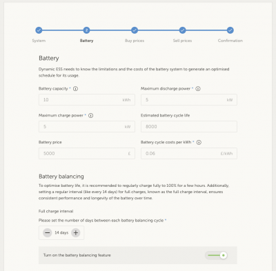

Step 2: Battery information
Next, provide key details about your battery:
To calculate battery costs, you can input the purchase cost of the battery, the estimated number of charge cycles, and the battery’s capacity. Use the formula:
Battery cost (€) / (Number of charge cycles * Battery capacity in kWh)
For example, if your battery cost €2,000, has a capacity of 10 kWh, and supports 6,000 charge cycles, the calculation is:
2000 / (6000 * 10) = € 0.03/kWh

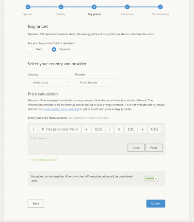

Steps 3 & 4: Buying and Selling Prices
For energy transactions, you can use either dynamic (day-ahead) prices or fixed prices that may vary by time of day or between weekdays and weekends. Indicate whether you're using fixed or dynamic pricing. You can find these rates in your energy contract.
For the UK, Spain and France, Dynamic ESS provides an out of the box connection with your energy provider. Refer to the list below to see if that applies to you.
Your Dynamic Price Formula Made Easy
Getting your dynamic pricing formula is important, but it might not be easy to find in your energy contract. Let’s break it down with an example:
When you sell energy back to the grid, you get the base rate from your energy provider. But when you buy energy, you also pay VAT and an extra charge of 11 cents per kWh.
Selling Energy: Your selling formula is just: P
Buying Energy: Your buying formula is: P * 1.21 + 0.11
If you’re not sure about your rates, start with a simple P for the price. You can compare the numbers in VRM with those in your energy provider's app to check if they match.
