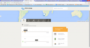

After logging in, the main screen will open showing the information from the tab 'Live feed'.
The live feed tab shows real time system performance information regarding:
- Solar Yield
- Grid status, including details on how much energy is fed back to the grid or used from the grid
- Generated solar energy in Wh
- Charging state of the batteries
- Weather conditions
