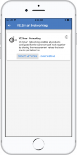

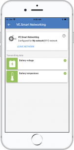

Open VictronConnect, connect the device, and then navigate to Settings and select VE.Smart Networking.

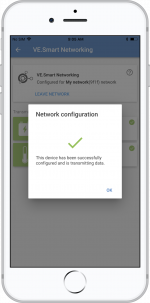

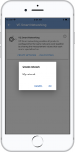

Click Create Network, enter a name. Click Save and wait for the 'OK' to show up.

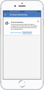

6.2 Join the Solar Chargers to the network

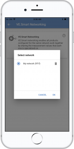

Go back and navigate to the Solar charger, then click Settings followed by VE.Smart Networking followed by Join Existing. Now select the network which you created at the previous step.
Wait for the 'OK' to show.
